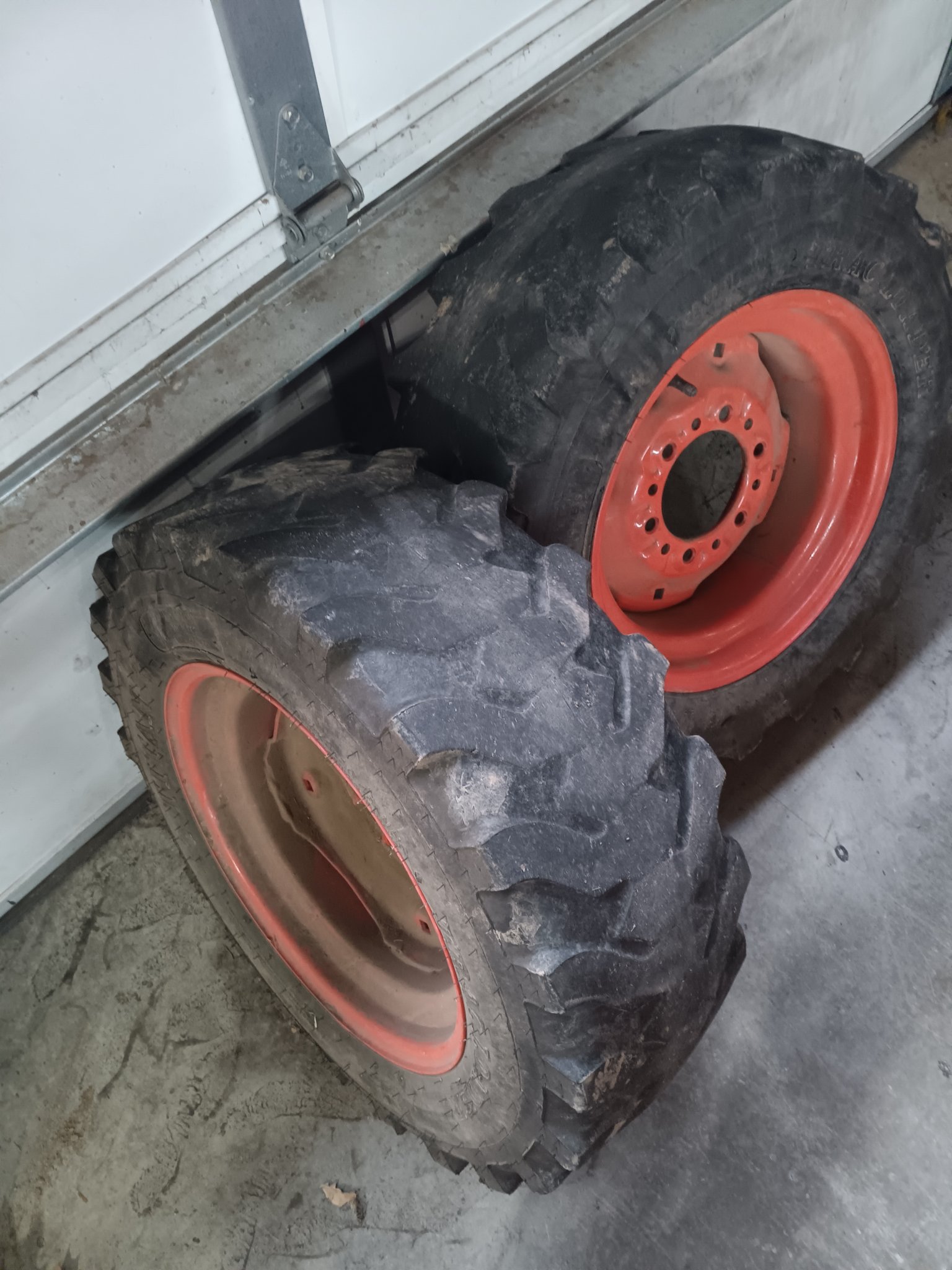

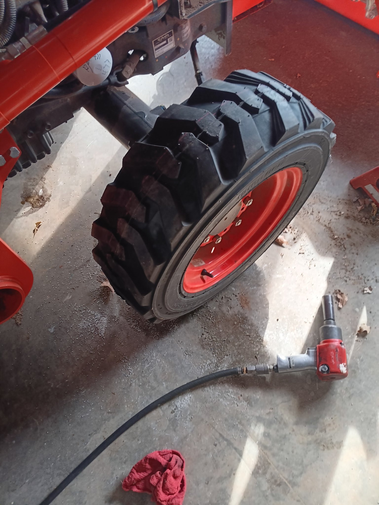

At 475 hours the original Titan SS fronts on my L3901 were done. Those tires have been superceded by Titan SS II which retail for $175. I decided to give these EuroGrip SS tires a try. Black Friday sale price was half off at $75 each!! Hard to go wrong at that price.

Hello Dan,
what is the situation with changing only front tyres in four wheel drive? The diameter is a good few percent bigger now than before. Does that not cause any problems? Although on a hard surface it is two wheel drive anyway, I suppose.

It causes no problems. The tires are sized by the OEM to match the lead on the tractor when new As the tires wear the lead is reduced making it closer to neutral.
In my case the tractor is operated full time in 4WD even on pavement which simply causes the fronts to wear faster
