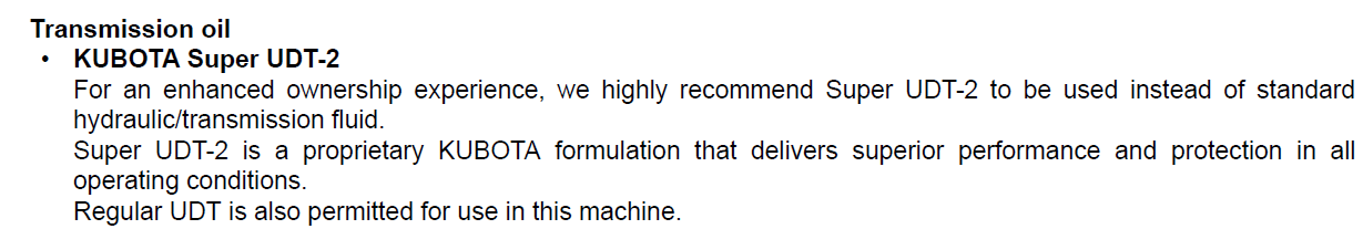

I will close with the boiler plate transmission oil reccomendation Kubota puts in all of the new owners manuals:
If you want an "enhanced ownership experience" use SUDT2 rather than a standard UTTO. Thats cool, It does not say you CANNOT use a standard UTTO just that you won't get that enhaced ownership experience. And because the know thay can't justify it they do not say using a standard hydrauilc/transmssion oil will harm your machine or void your warranty.. It goes on to say using UDT is "permitted". UDT is nothing more than a standard UTTO - get my drift?
