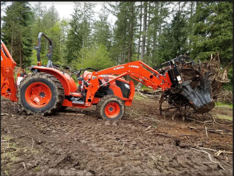

Have to throw this photo in.
My Mx 4800. This is a solid Doug Fir stump, full of dirt.
All she would do to lift it, and no higher. I have no idea what it weighs, but as you will notice, not much weight on the back tires.
