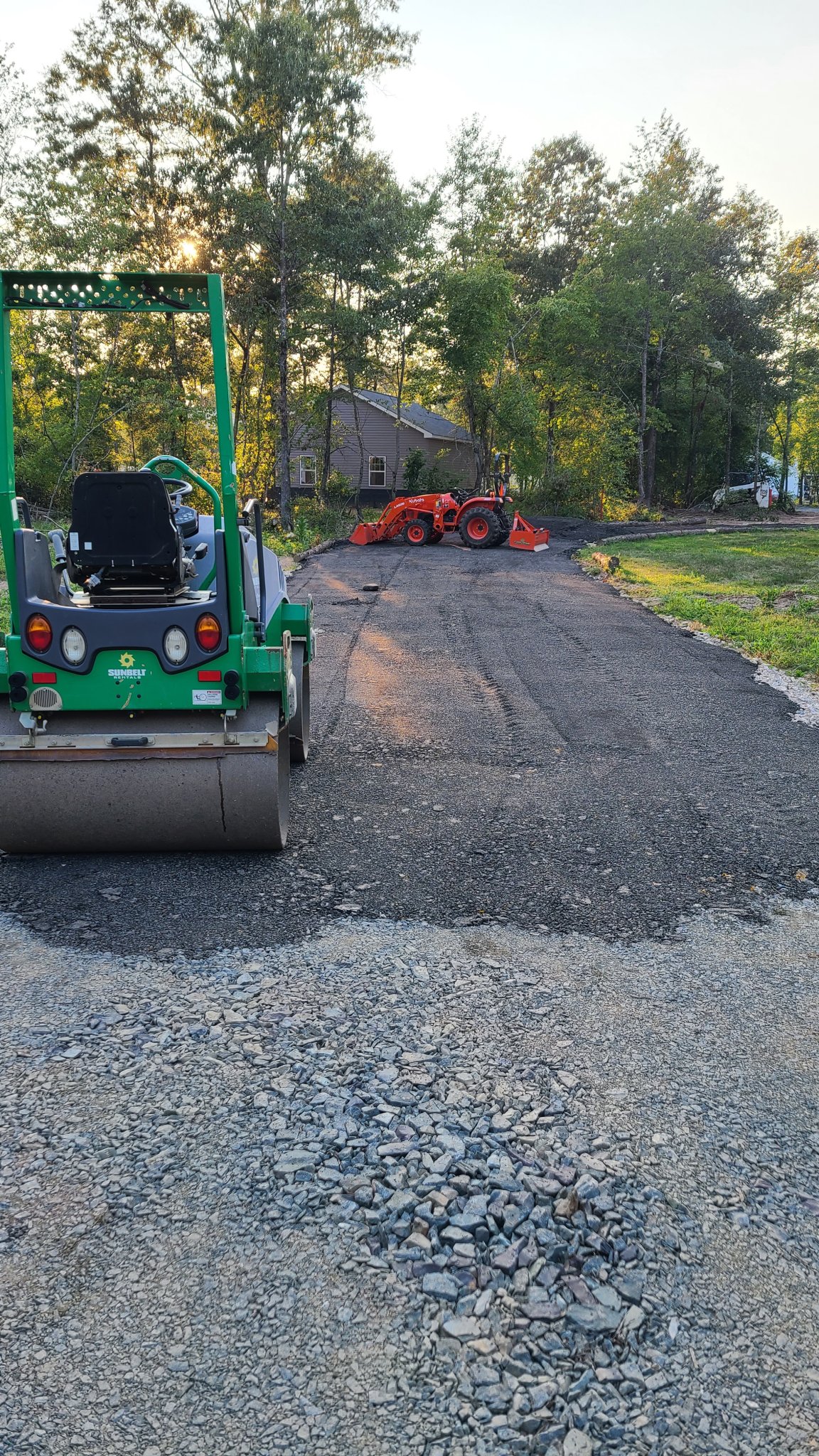

Congrats on successfully convincing your wife on the smart purchase! Now you can do her a favor and go asphalt millings for the driveway and DIY 😁

What is the black material you are laying on the gravel?

I just googled Asphalt millings, and gained new knowledge today.
The gravel is my existing driveway. I connected two sections of it with the asphalt millings to make a loop. Backing 65' of truck and camper up at night was a PITA so I made a loop. The base layer is 3-4" recycled concrete chunks about 6" deep. Then I put 3" of millings down. Will probably add another layer next summer after the ground does its thing over winter and 22000 pounds of truck and trailer drive over it more.
This is the base.
