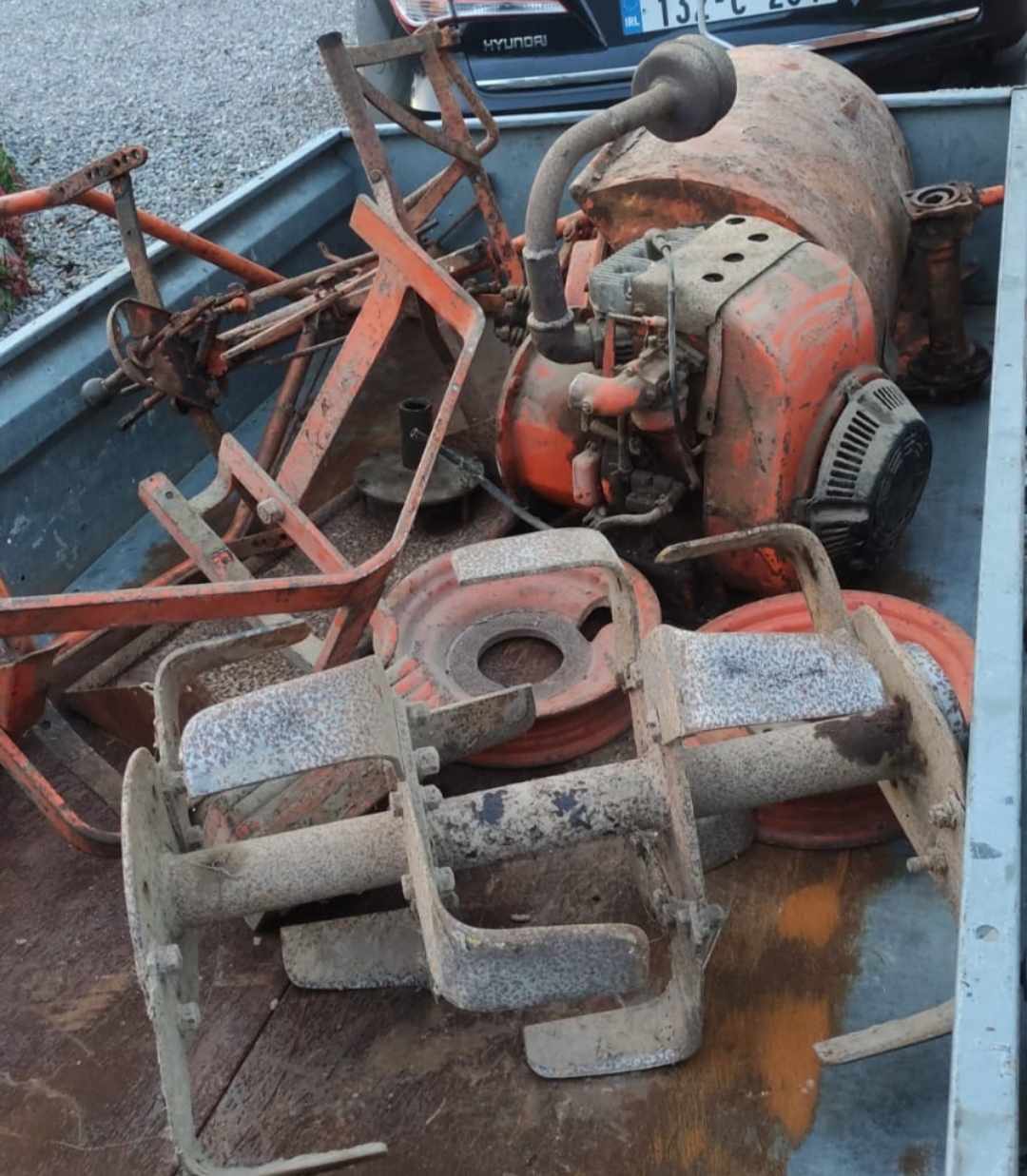

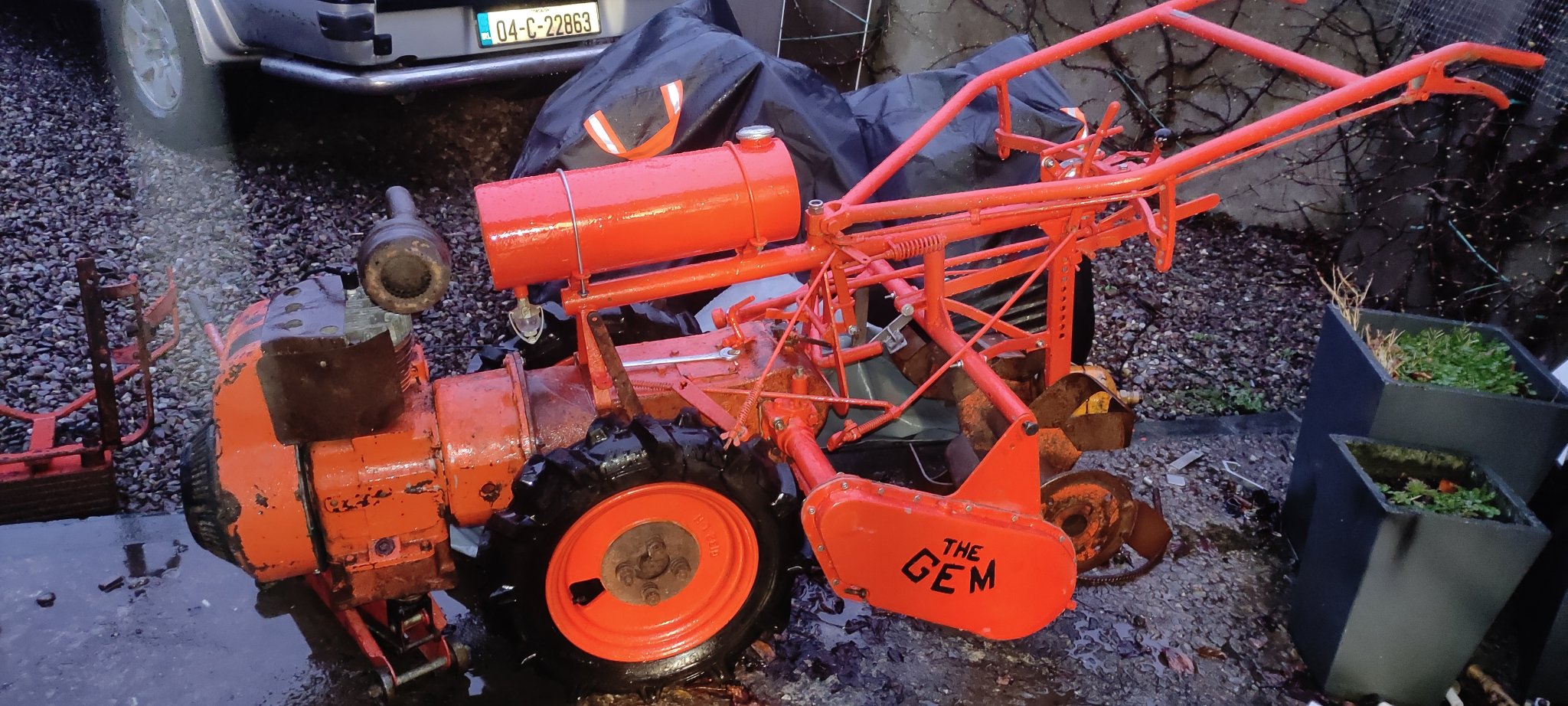

It was pretty good to begin with. Had to rebuild the rotor drive chain guard, few broken bolts and brackets but nearly all together now.. A few small pieces left

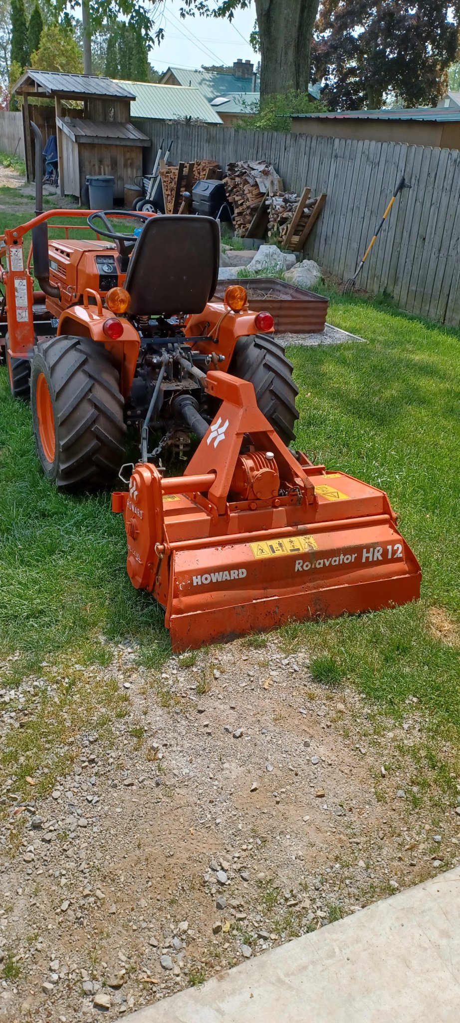

Excellent job restoring that piece of equipment I have my father's tiller now and it's a howards as well but it's a three point attachment 4 foot wide.

Really nice job
Excellent job restoring that piece of equipment I have my father's tiller now and it's a howards as well but it's a three point attachment 4 foot wide. View attachment 122025
That's a lovely clean machine and attachment. To be fair Howard made equipment to last a lifetime if minded. Switching to imperial threads was a real bummer for me as bolts in those threads are very awkward to come by here. Ended up making most of my own. The clutch nut was 9/16 UNEF. Extra fine unf...never knew it was even a thing before I started that mission

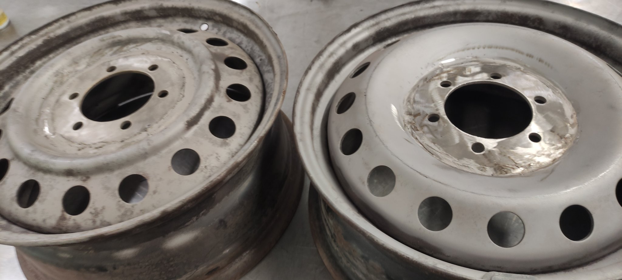

Primer and ready for Kubota orange tomorrow. Must order my agricultural tyres tonight. Total cost a few hours plus €40 got the Toyota rims.

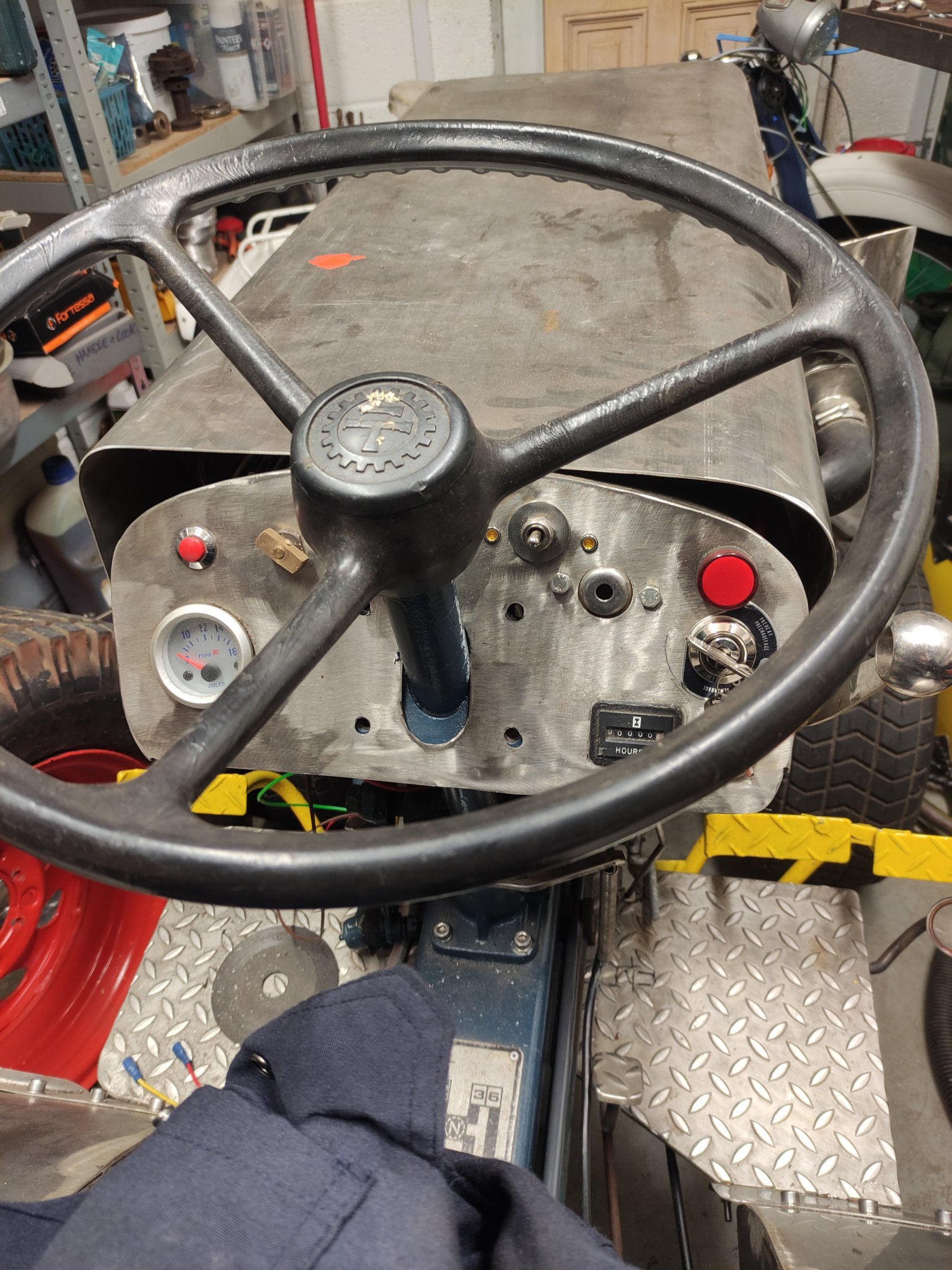

That's the view of the dash and bonnet....not happy with it. I made the dash to the same shape as the original yrs back. I didn't have the original bonnet plus didn't/don't have the skill or equipment to fold the bonnet to the original shape so the bonnet stays and the dash will get pimped to fit snug under the bonnet in the future. But for now I've spuds to get planting so it will do until next winter.
