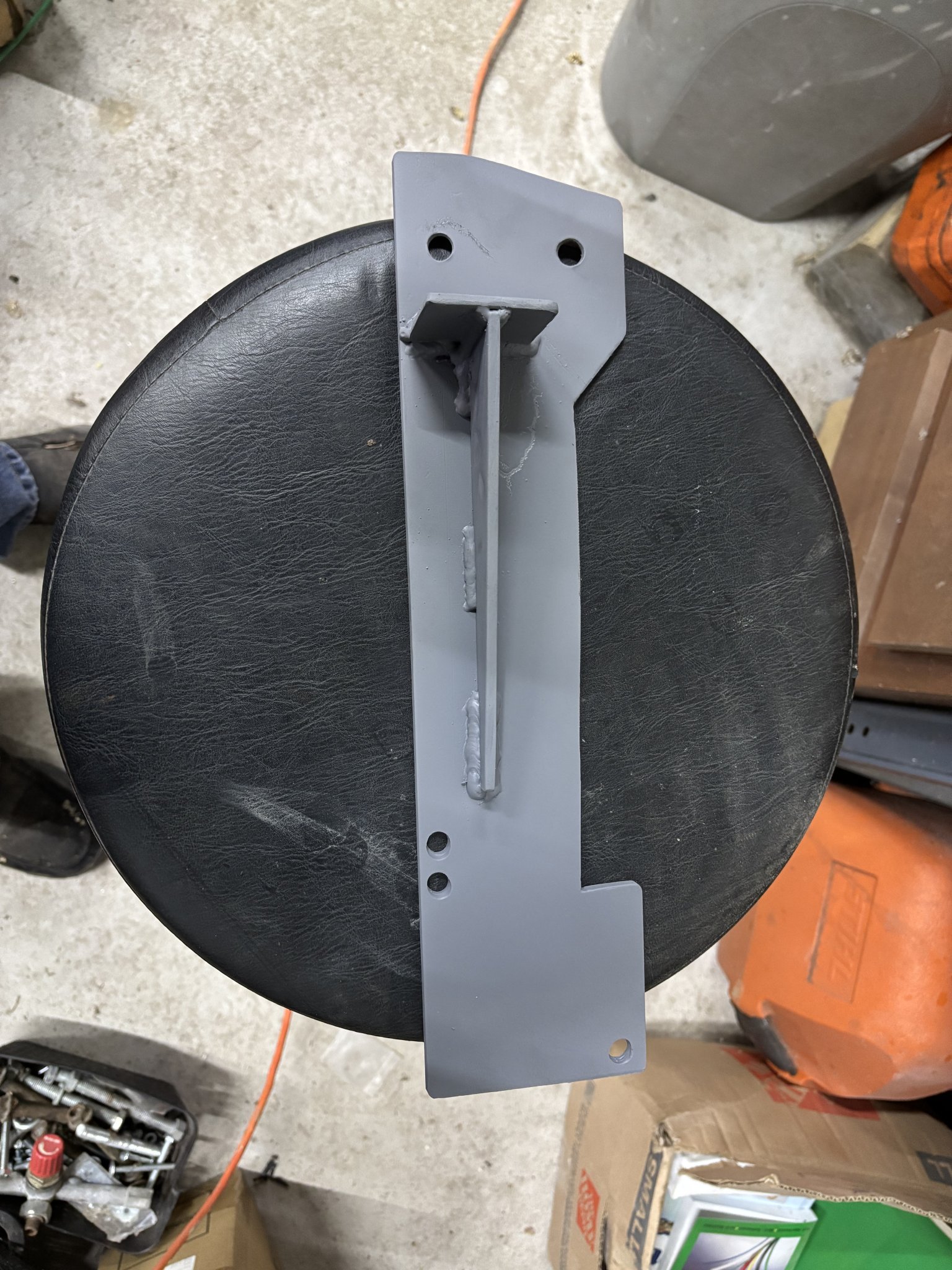

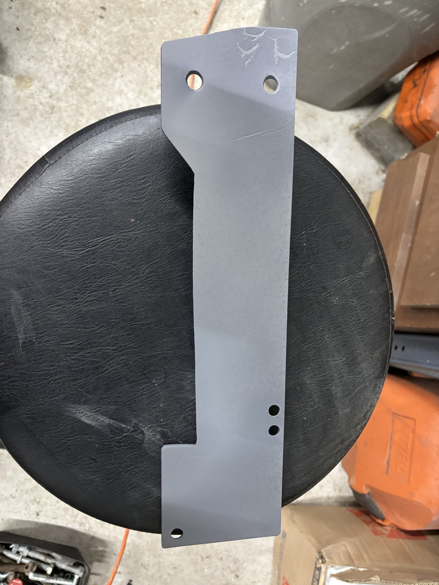

Money scare on retired income! I have the 3 fittings from Discount Hydraulics that you recommended. I have been researching this project and have ordered other parts from a company called Force America and they seem to have a great selection and best price I could find for the other parts I needed. I will be ordering the control valve next week and the hoses I need. But I have been able to find everything that I believe I need to install the complete system with both a hydraulic top link and hydraulic RH lift rod side link
with all the components, 2 spool valve and the needed adapters, a double coupler quick connection with breakaway bracket and all the hoses. I have located a Top Link and it comes with the hoses and check valve. And I have also found a RH lift rod side link. So for the entire system I will install comes in at just about $900.
Now I had to fabricate a bracket for the control valve to mount it to my ROPS and it will put the valve just above the PTO level on the right side of the tractor. I have included pictures of the bracket. Just primed it and will paint it the Kubota gray color. I sure that some may question how I can do it for under $1000! Well when I am done, I’ll provide a complete description with pictures and for any one interested I will provide a detailed breakdown of the parts, cost and source for the parts. Now that I have told you that information. I hope to get everything in or ordered after the first of the month. I will then get business and provide updates as I go. Looks like I will have to take the right side tire and fender off to be able to get to the tube and then run the hoses out to the valve. Probably will be an all day job. So I do appreciate all the help and if you have any suggestions please feel free to let me know. I will definitely take it openly with NO hesitation!
