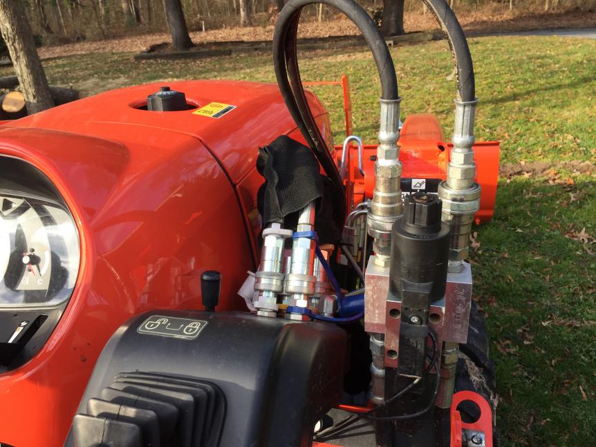

I have a 2016 L3301 with a LA525 front end loader. Has anyone installed a pressure and temperature gauges that can be read from the operator's seat for the LA525 loader? :)

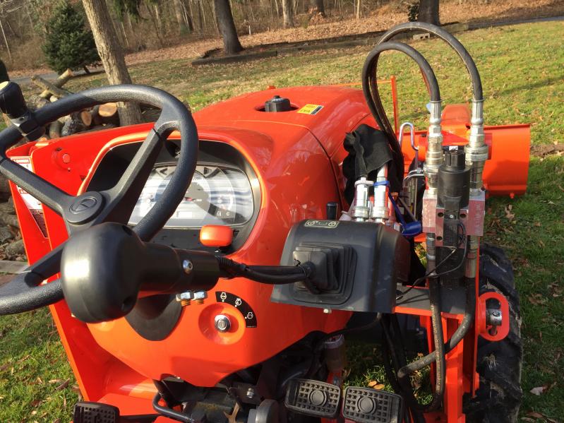

Honestly the HST fluid and pressure is already right in eye-sight via the hoses and connector at the third function valve and Loader control stick. :p

Hi guys, its just a me thang, I have a pressure gauge installed on my wood splitter, works nice, and don't seems dangerous to me.
My thought was to do the same for the tractor, since the connectors, are in plane view on the tractor. The fluid pressure is there right in "eye" view of the operator, on my log splitter, and would be on my tractor. in my opinion it is just how it is installed.:rolleyes:
