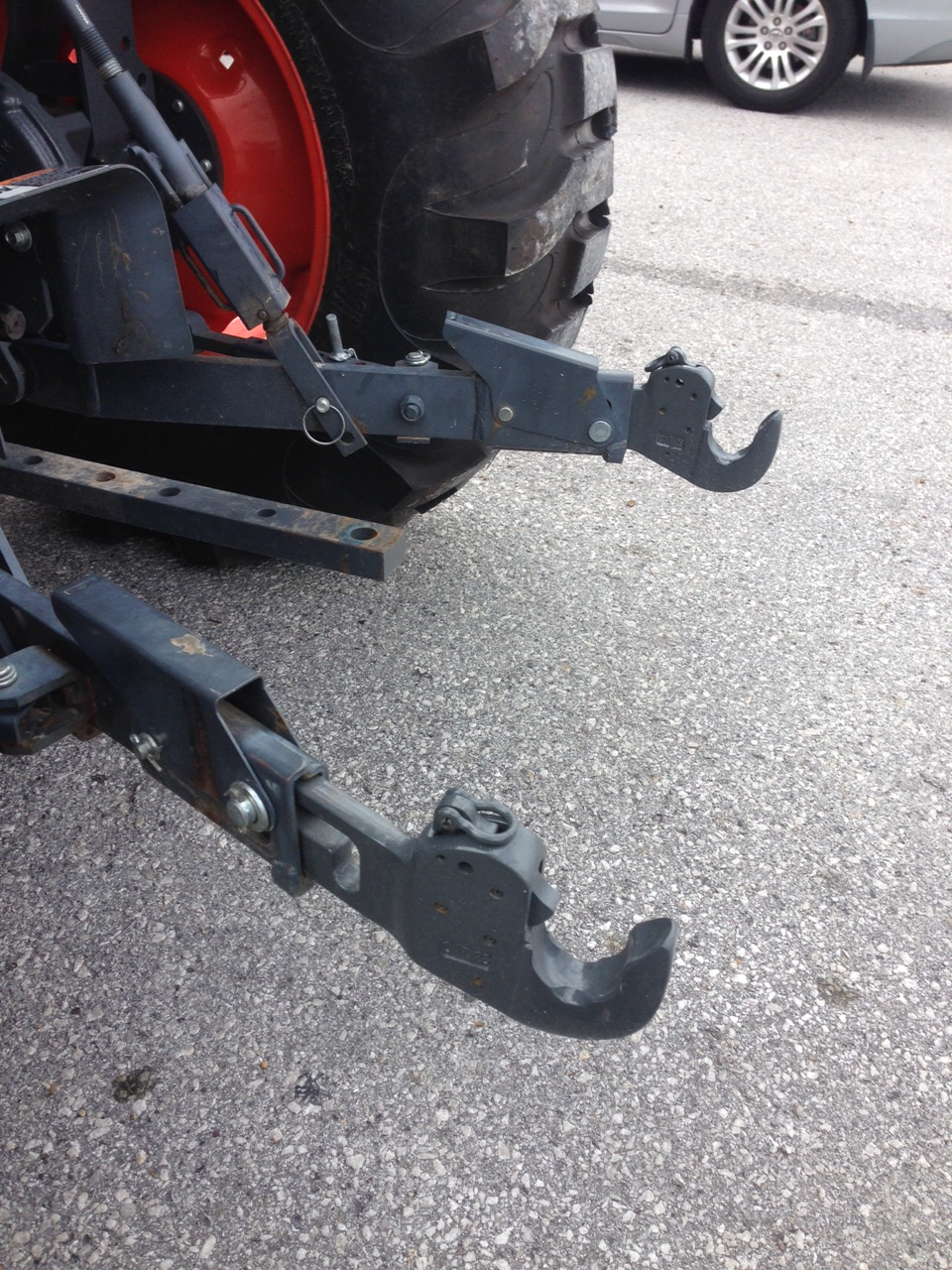

Euro hooks would be a good option for you. Easier connections for probably less money.

They can, but there is no need to, backup and use the higher part of the hook to push the implement so that it is in line with both hooks and raise the 3pt to connect.
People do the same thing with full 3pt hitches.
Lots of people seem to want to make things more difficult than they really are.

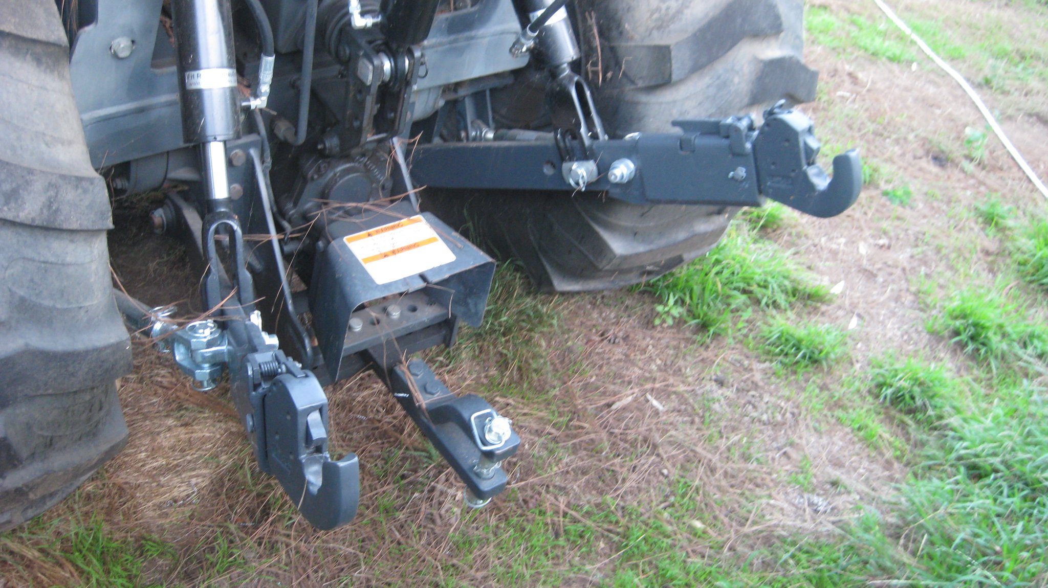

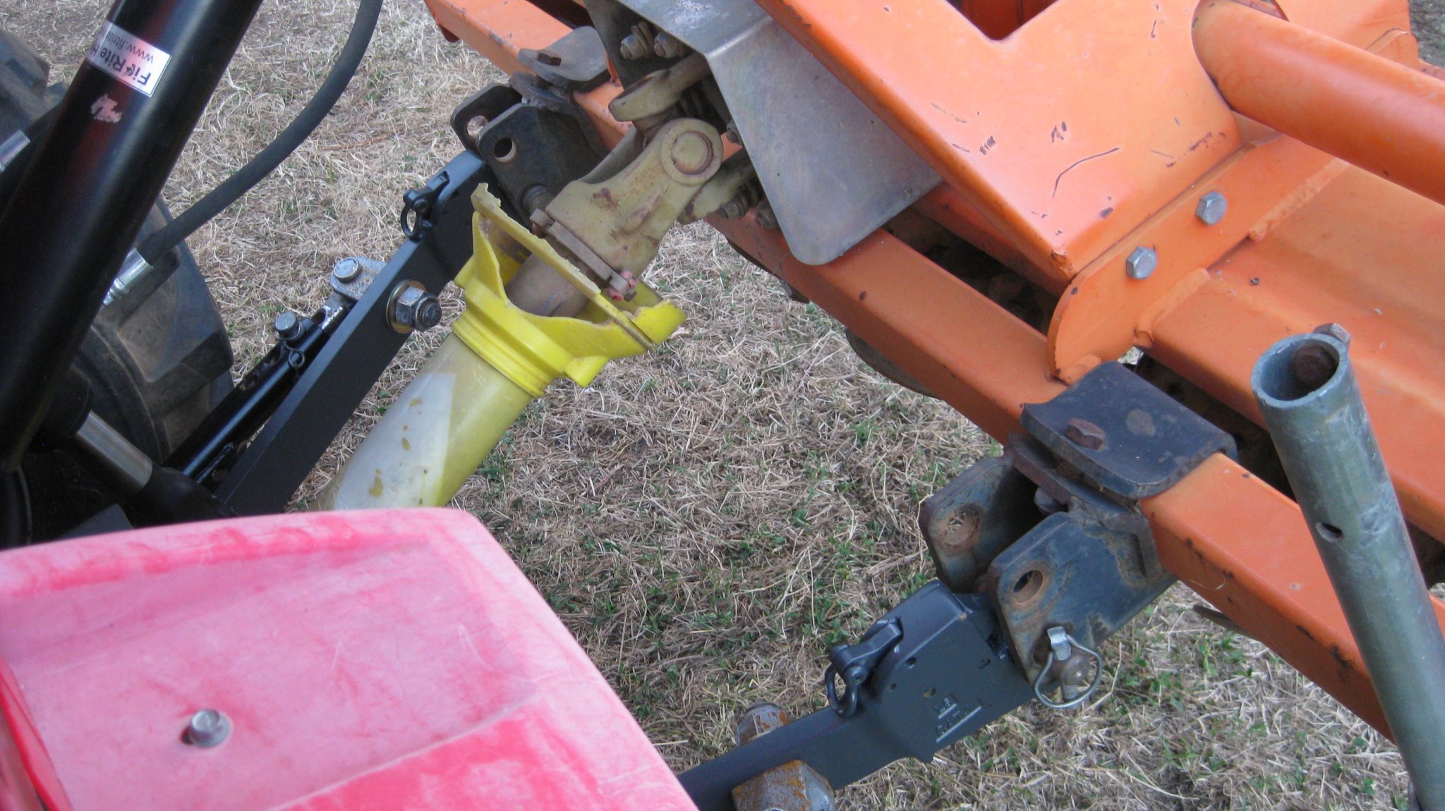

I had Pat’s easy hitch on my previous tractor for 15 years. It definitely makes things easier. They look like the Eurohooks. But my telescoping lift arms are better yet, especially with heavy cat 2 implements. Your photos look like you have both the telescoping arms and Eurohooks?
MtnViewRanch
Oct 10, 2012
719
176
Lakeside Ca.
The 75hp tractor has extendable Euro hooks and the 32hp tractor just has fixed Euro hooks.
None of my 3pt implements are light, as in nudging them over with your knee. They range from 600lbs to 3500lbs, yes 3500lbs.

The picture in post seven shows that the euro hooks are both hooks and they are extendable.
I never saw this option before. Curious if they are available in the United States?
edit: I suppose they are available in the states since that is where Mountain View ranch is located…

I was referring to the poster of post 7.
The pictures posted speak for themselves I think.
