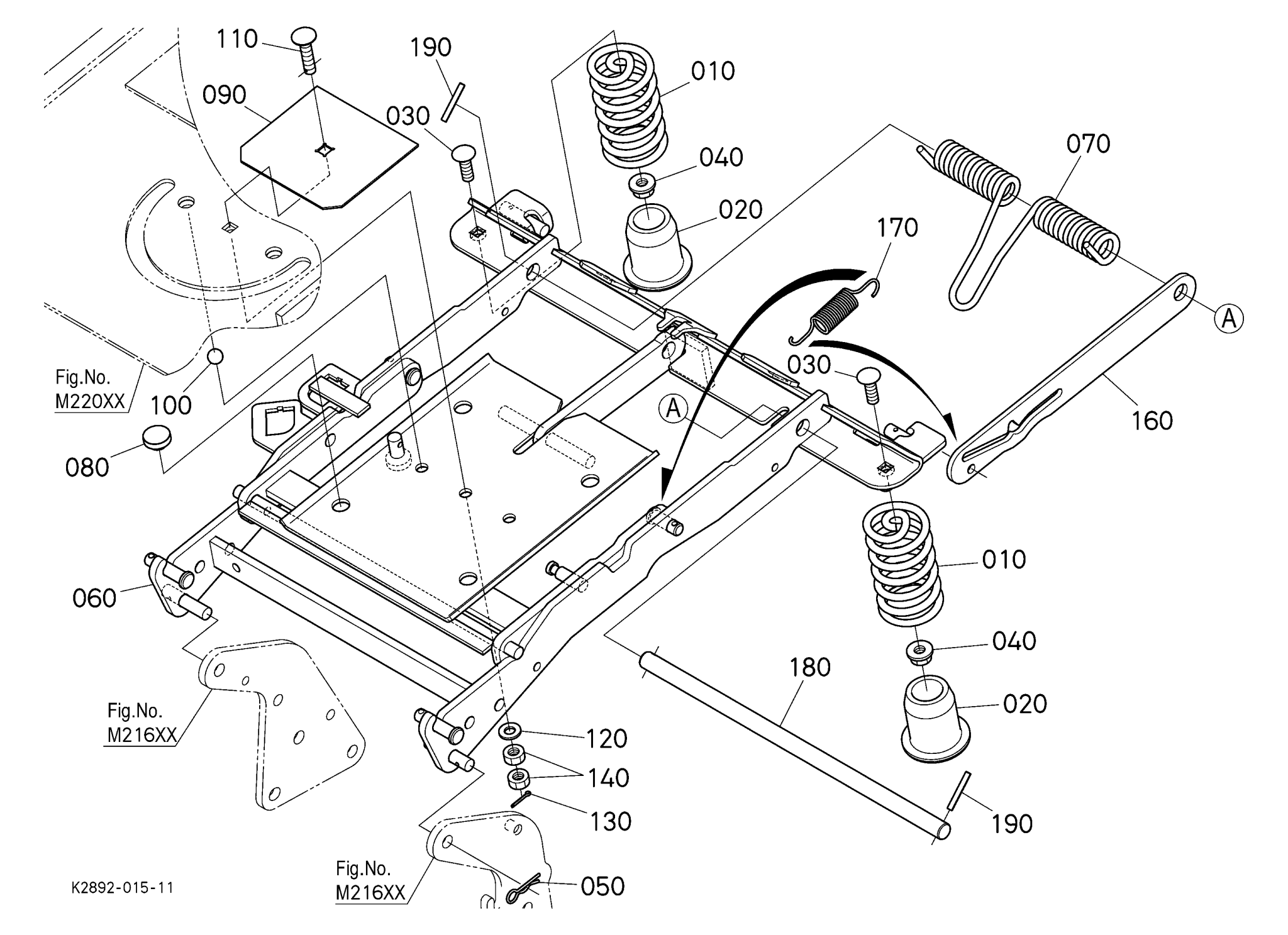

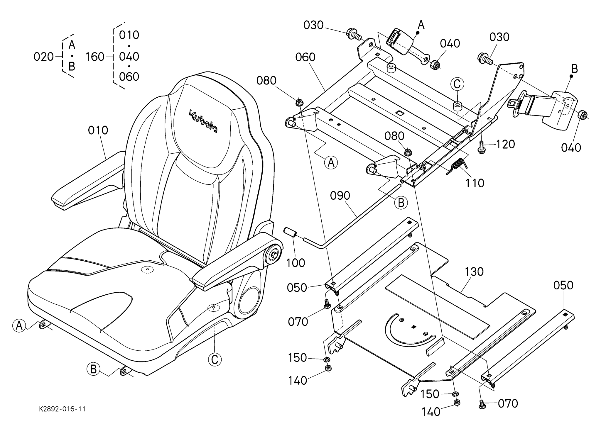

Don't know if a seat from a BX23S would fit but they don't actually "swivel". You raise it up, turn 180, lock back down. You're either facing forwards or backwards, no in between. And they have a wider ROPS.
