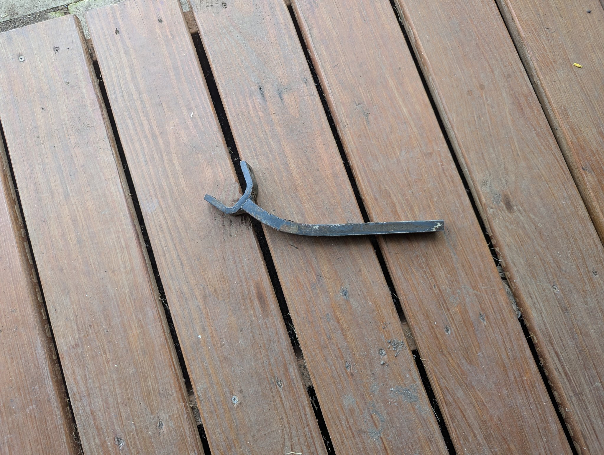

one of these days, i'll learn to be more gentle with my machine. snapped one of the pins that holds the 3-point sway linkage - right at the rear frame where it connects. must've happened to the last owner of this, because the other side has a bolt with a nylock nut on it. anyone know what size pin this is? the kubota part is TA140-39820, but they never give you measurements or details of the parts. wish i would've thought to measure the hole - i could just do the same thing he did and buy a grade 8 bolt and a nylock nut.

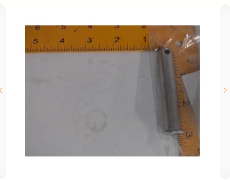

From pictures at Messicks it appears to be a 1/2" x 3-1/2" (usable length) clevis pin.

@TheOldHokie thanks for that, maybe i'll get a pin instead of a bolt.
@GeoHorn fair point. it did bend the connector bits on the arm when it sheared off... my hope was with a bolt i might be able to straighten that out. maybe i'll just have to pull it and take it to a vise.

@old and tired maybe, but i don't have a workspace set up to do that on a half in thick bar. now i have to decide if i order just that rod for $109 or the entire assembly on amazon for $94 from eparts
