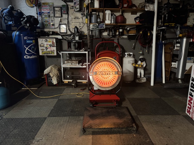

Picked up the SF80 at the Depot this morn.
Pretty much ready to go out of the box.... fill it with fuel / hit the electric prime button.... Turn it on
And it fired right up.
I expected a slight smell because its new.... but nothing.
It's not silent, but it's not loud either..... not really an issue.
It throws off some HELLA-HEAT !!!
I have plastic floor tiles in the garage and I could see them getting warm and flexing a bit.
I have 4x4 piece of cement board I'm gonna place on top of a few bricks to protect the floor.
I think this is gonna work out nicely when that New England freeze comes...

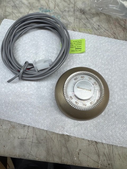

Comes with a wire harness to use an analog thermostat.... nice feature.
View attachment 166226 View attachment 166227
Be very careful where you point that thing. If it gets too close to plastic things (e.g. a bumper cover) they will develop sags and wrinkles. :oops:
