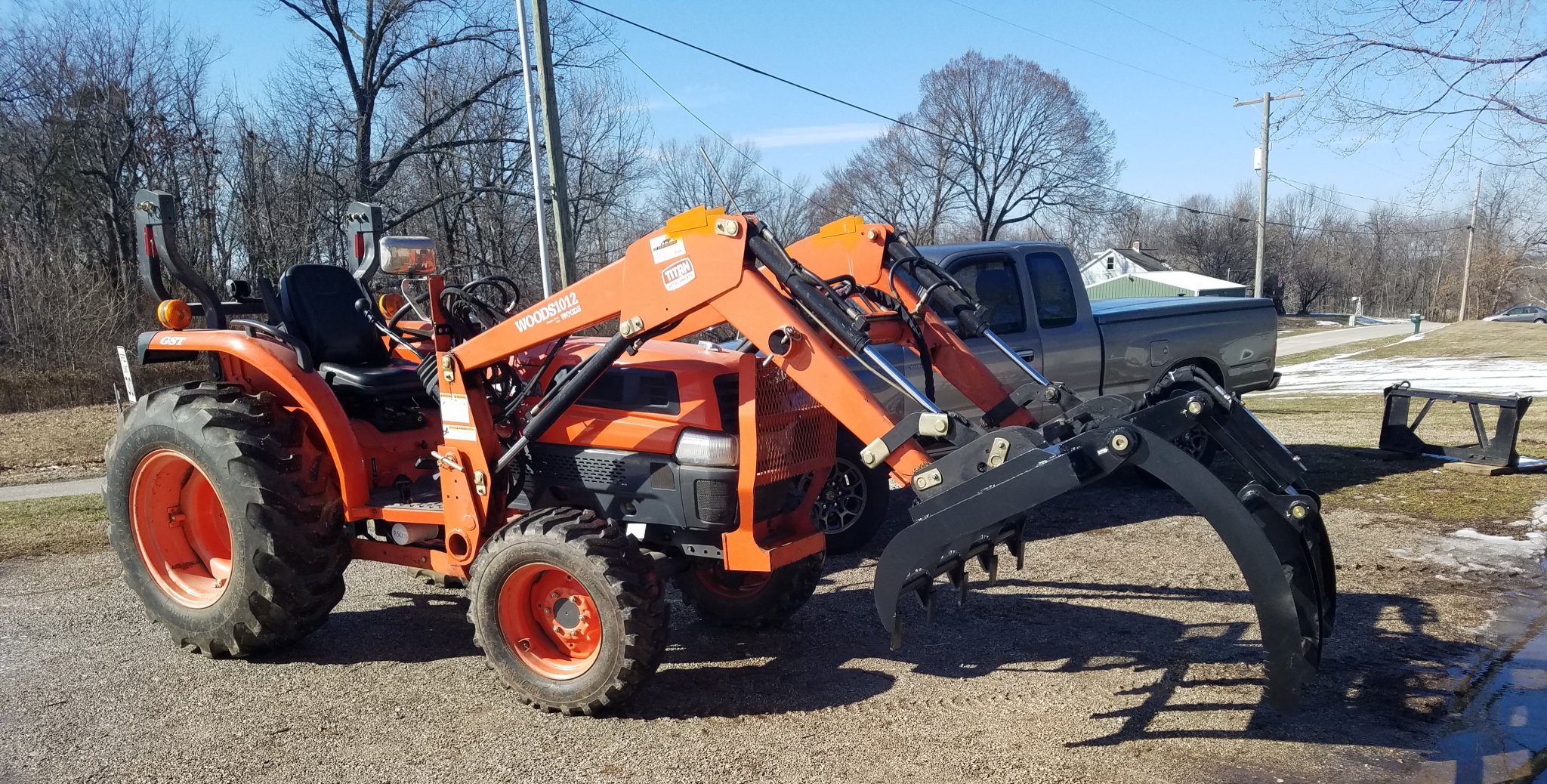

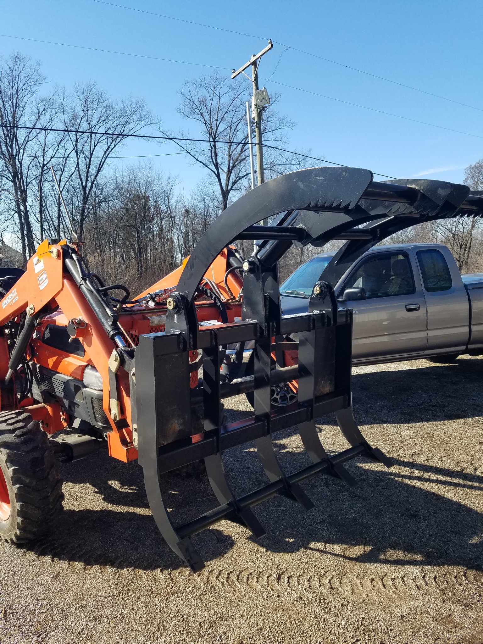

Last week I posted pics of the Titan grapple bucket (48" w/3000 psi cylinder) I just purchased. This week I want to get the hydraulics ordered. I have virtually no experience with this type of decision.

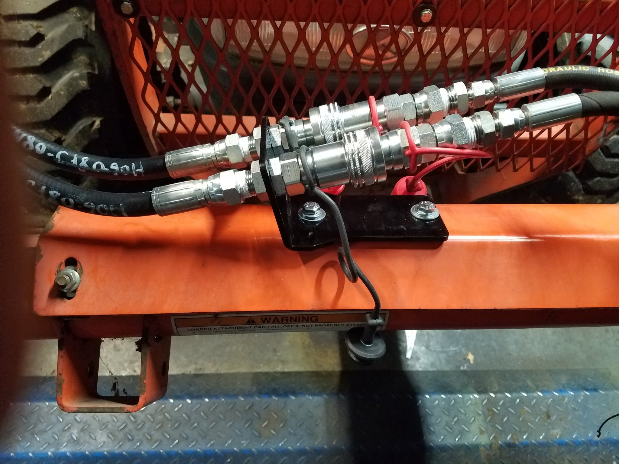

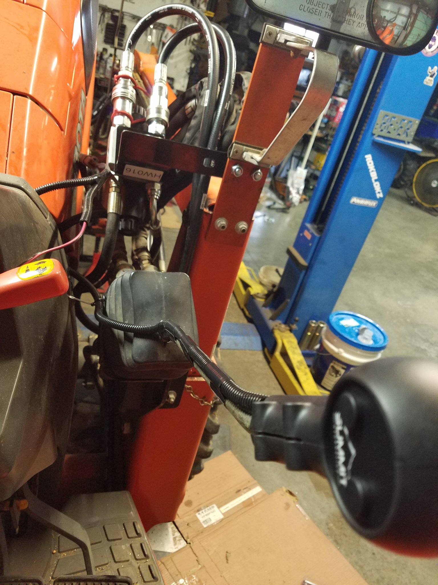

What’s the Amazon kit?
The summit kit will more than likely work, fittings are really the only thing that could change. I put the summit kits on two separate tractors not listed in their specs. LX2610 and MX6000 both were fine.
