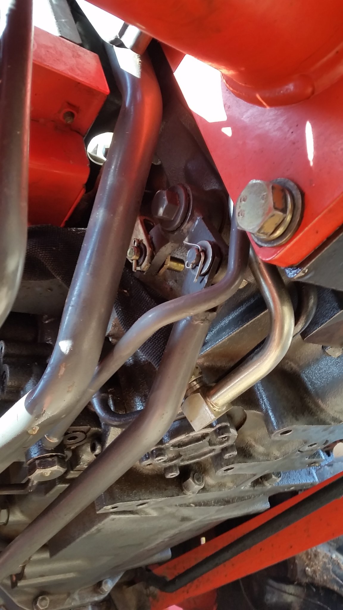

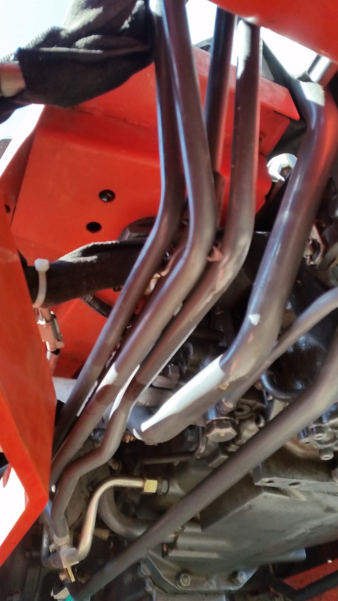

13,783
5,486

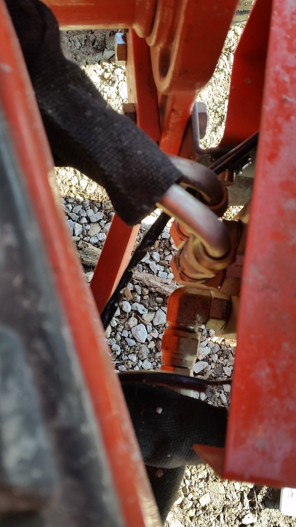

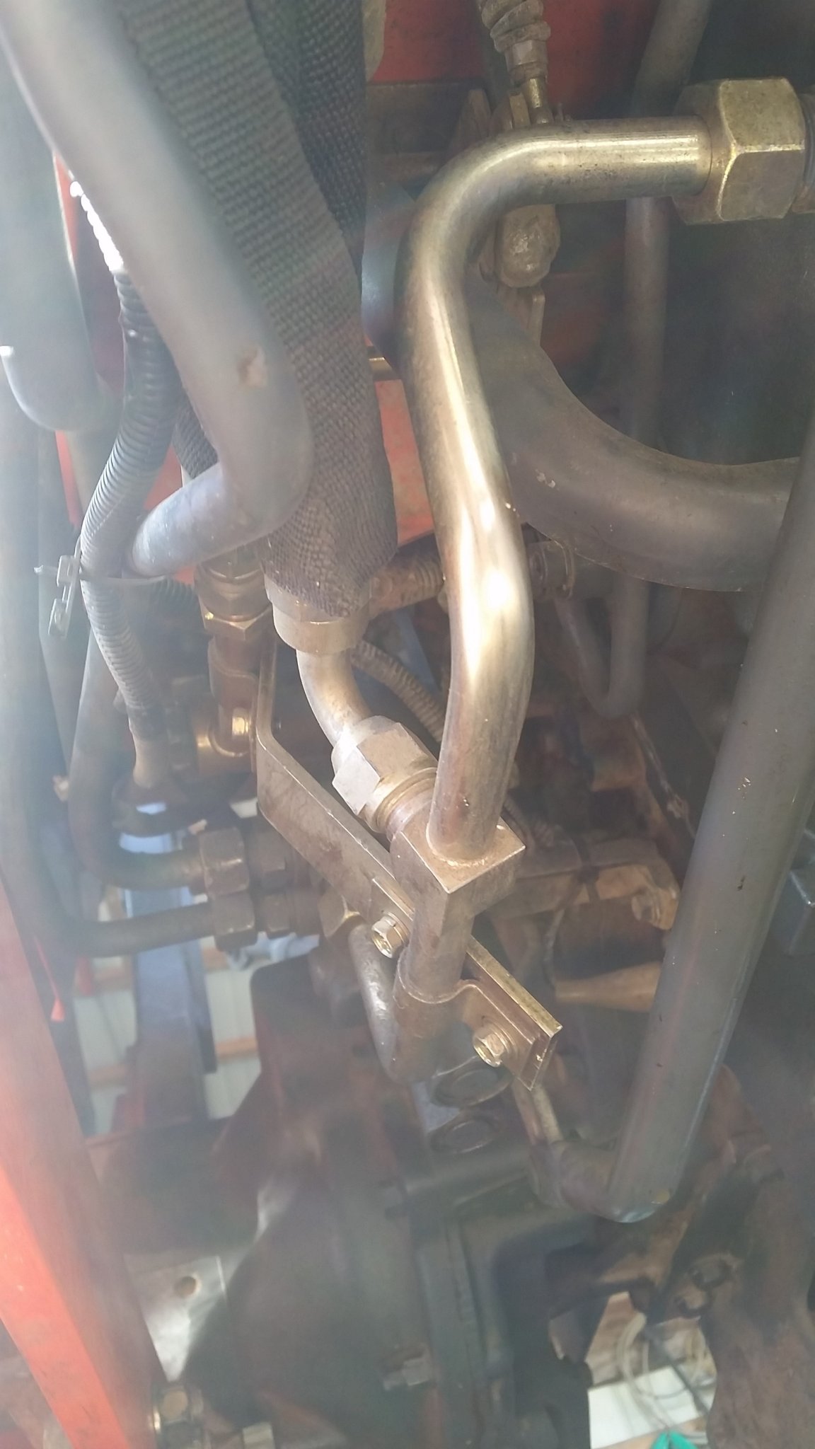

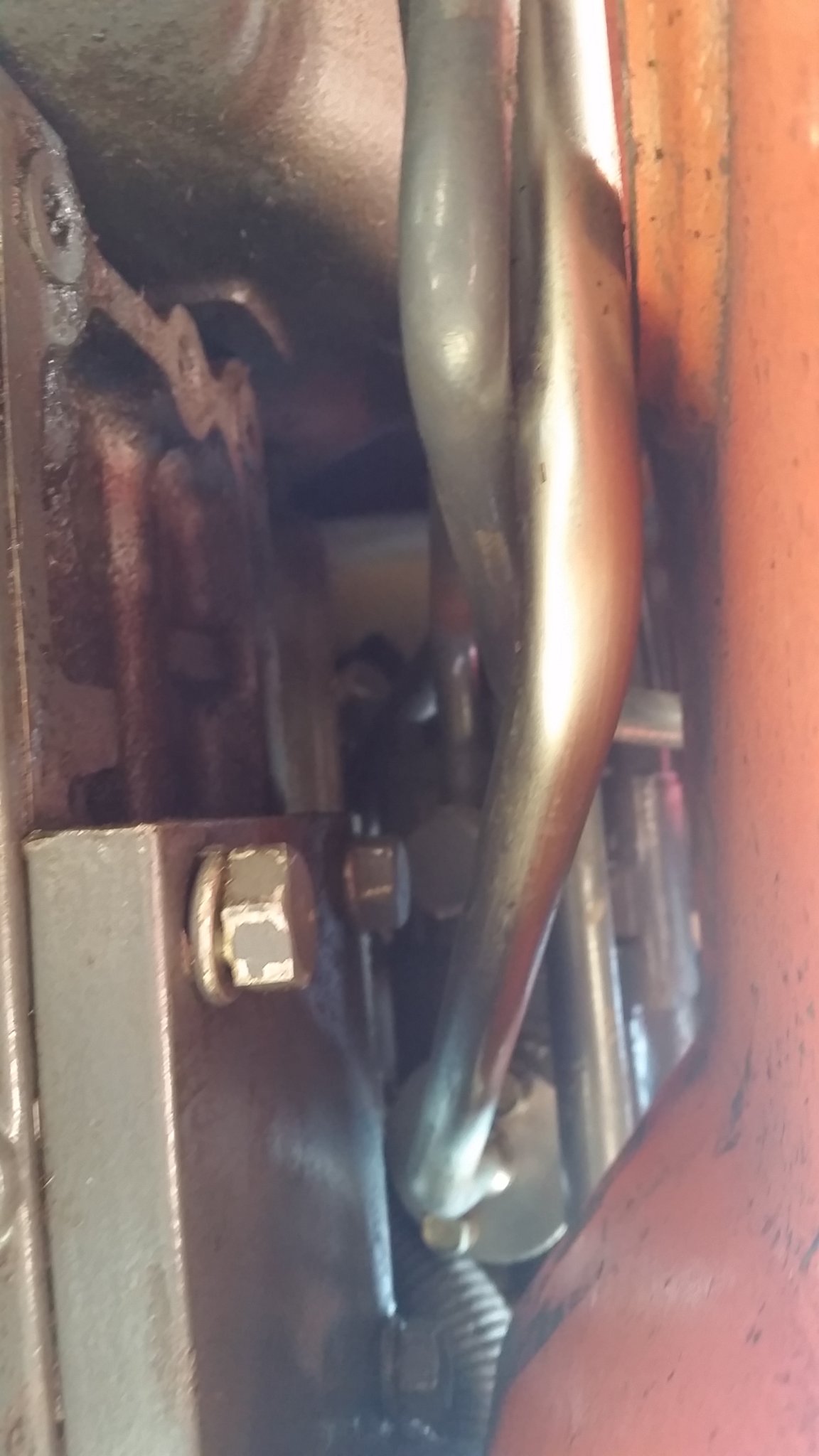

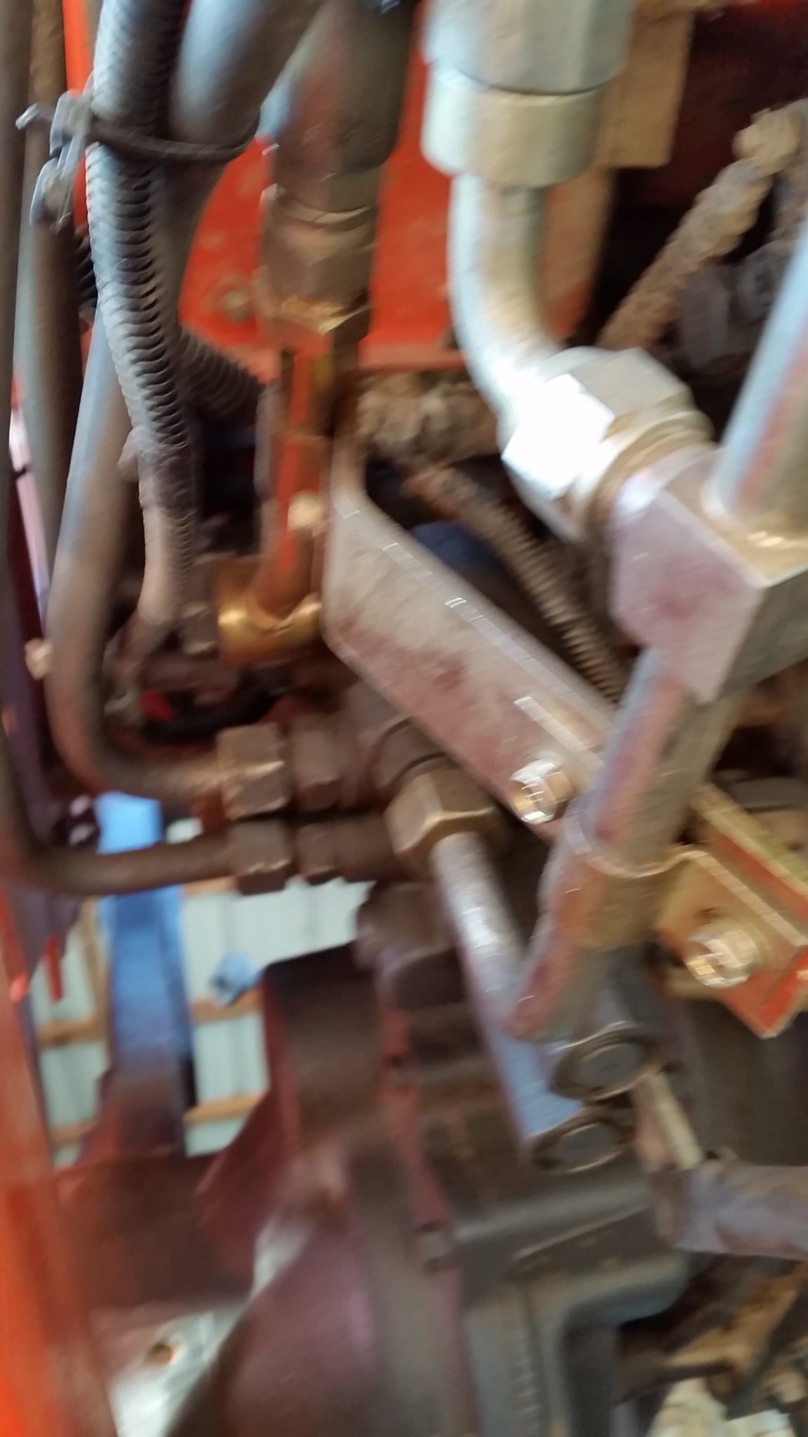

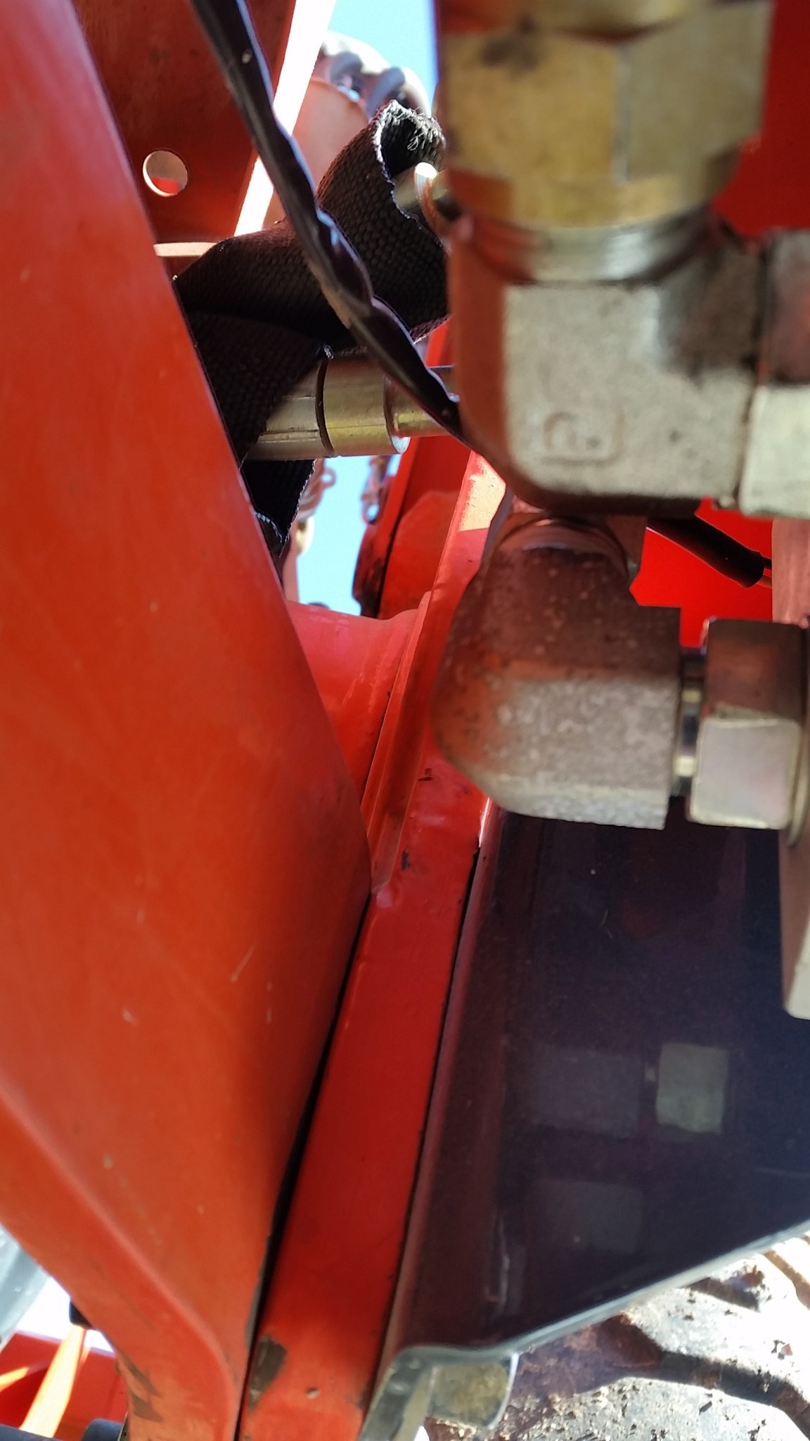

Daniel, here's some pictures of the installation of the Kubota kit. It is steel lines. If I remember correctly there was a loss of 3-4 quarts of hyd fluid.

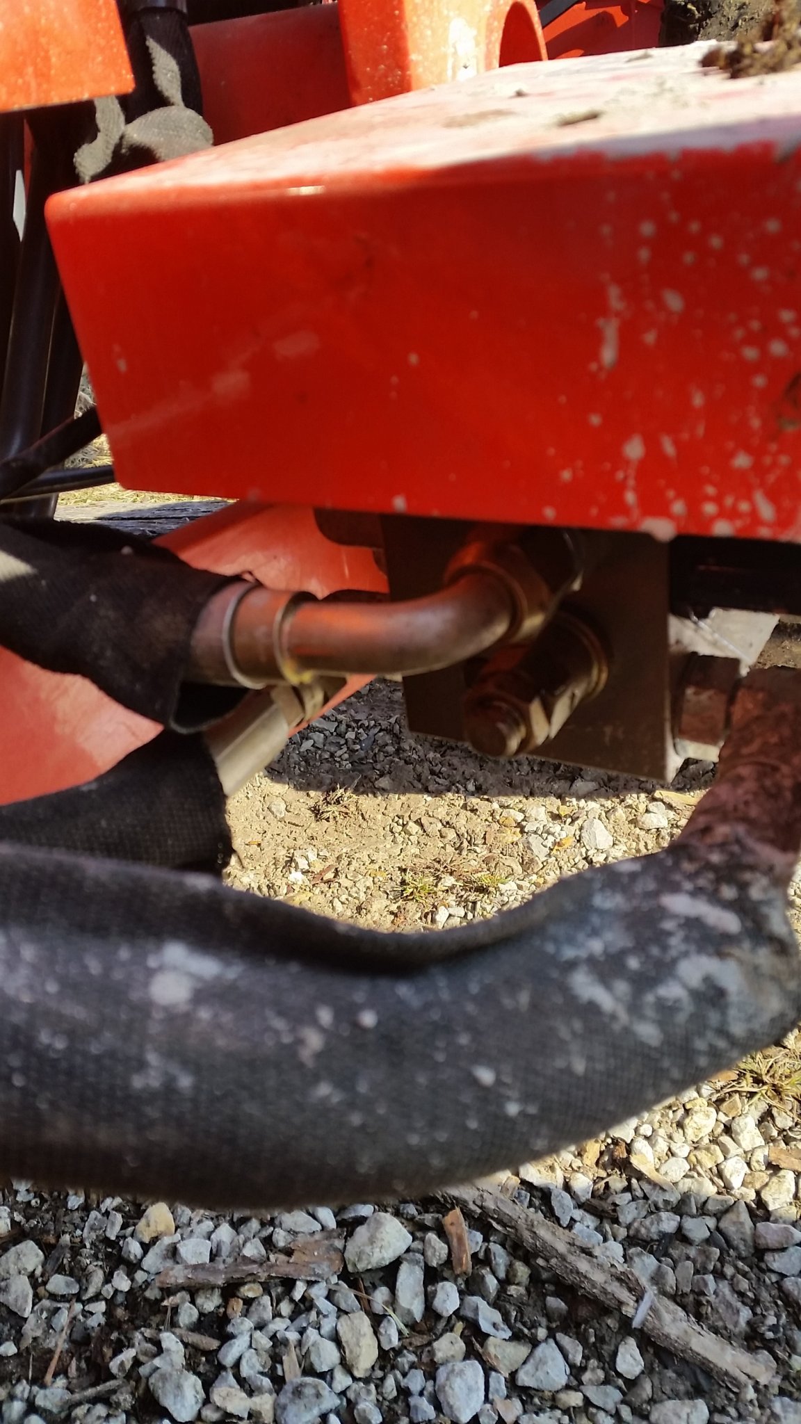

I got lucky and had a couple hose connections for the banjo bolts from the BH92 backhoe I bought for it several years ago. As far as mounting it I bolted it down by the front tire on the backhoes sub frame and I'm going to fab a metal shield for it so crap doesn't get thrown all over it by the tire. Everything seems to be working correctly. The switch mounted onto the hydraulic lever perfectly so that was a breeze. I do wish I had gotten just a few more hydraulic connectors and another 2 sets of quick connectors with the kit. I put in 2 more quick connects so when i switch to my snow blower for the winter months I could just unplug the lines running to the front.
Thanks again for all your help. Ill try to snap a few pics later today and post them here.
