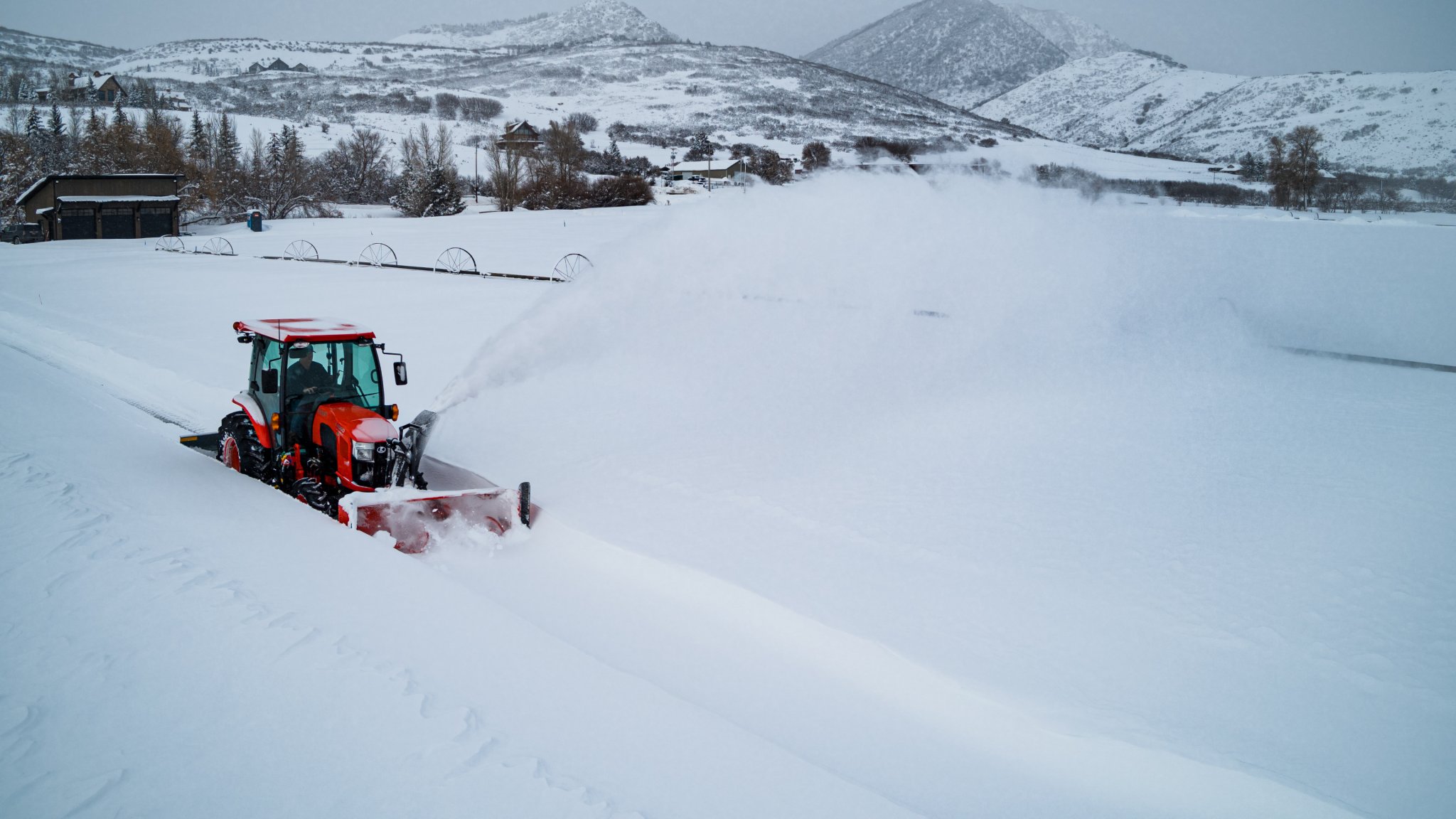

I wanted to follow up to my post from a year ago when I was a total newbie. The snow here in Northern Utah has been epic. I now have a mile long road that I need to keep cleared which keeps me busy. A local reporter took this shot when he was wandering around looking for something fun to snap. Just another day blowing snow.

You only clear one pass wide?

You must be VERY happy!
Absolutely magnificent, compared to anything in So. Cal.

Nope, I do two passes (or sometimes 4 if I have to do a half deep pass due to snow depth). Go all the down to the end of the drive and then turn around and come back up.
Ok was just curious as it looks really narrow, gotta love snow! 🤪

It's paved and is 14 feet wide but I clear about 12 feet cause I can do that with two passes. I have wings on the snowblower and its base width is 74" so two passes just work. If I had to do it over again I would have gone with the bigger 84" model that is for sure.

Not too late. Keep your eyes open this spring for an 84" snowblower, and then put your smaller one up for sale.
