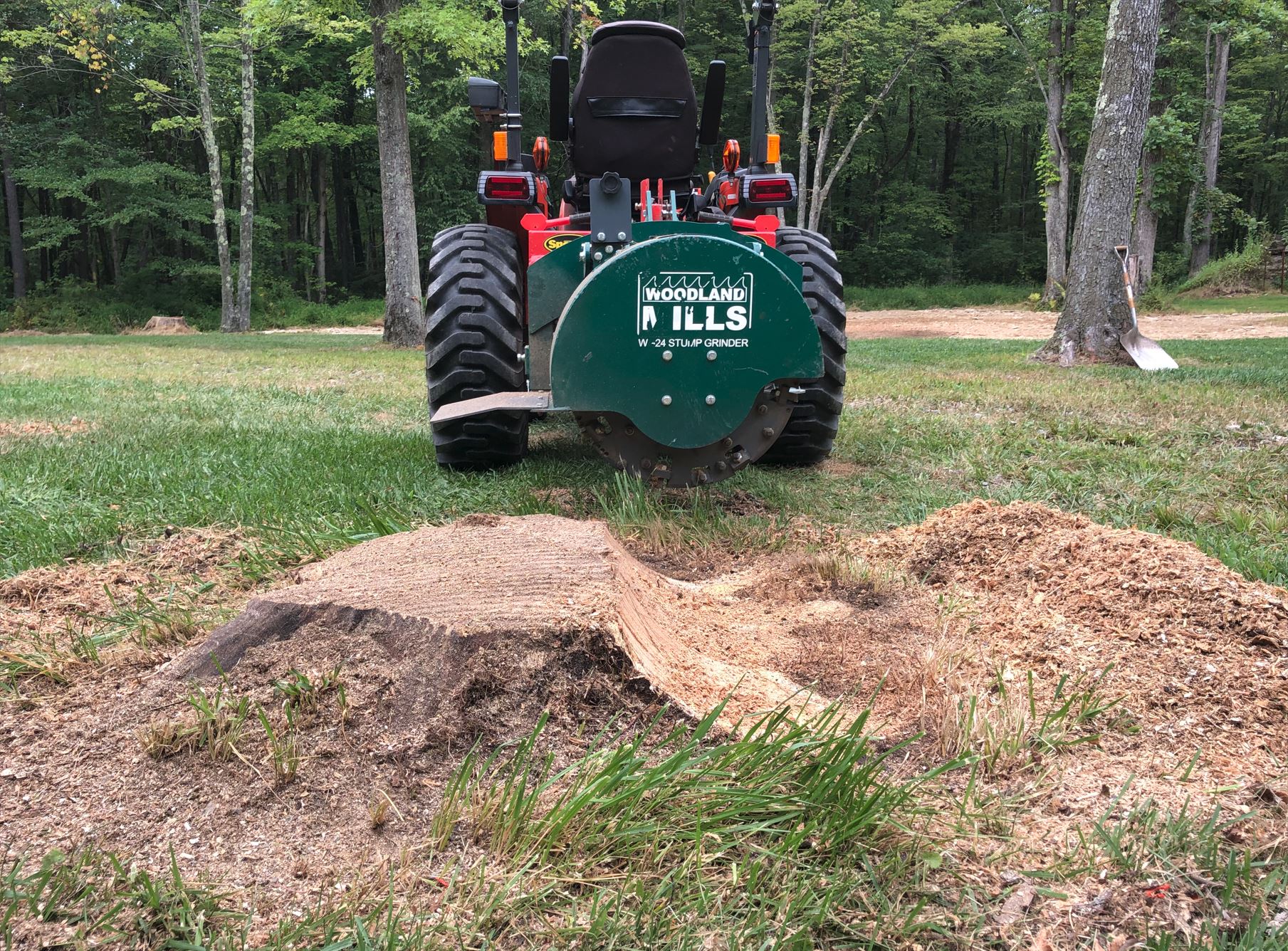

I now have three options at my disposal depending on the stump and just how destructive I'm feeling at the time :)
Option 1 is the best choice for the large buggers.
Option 1:

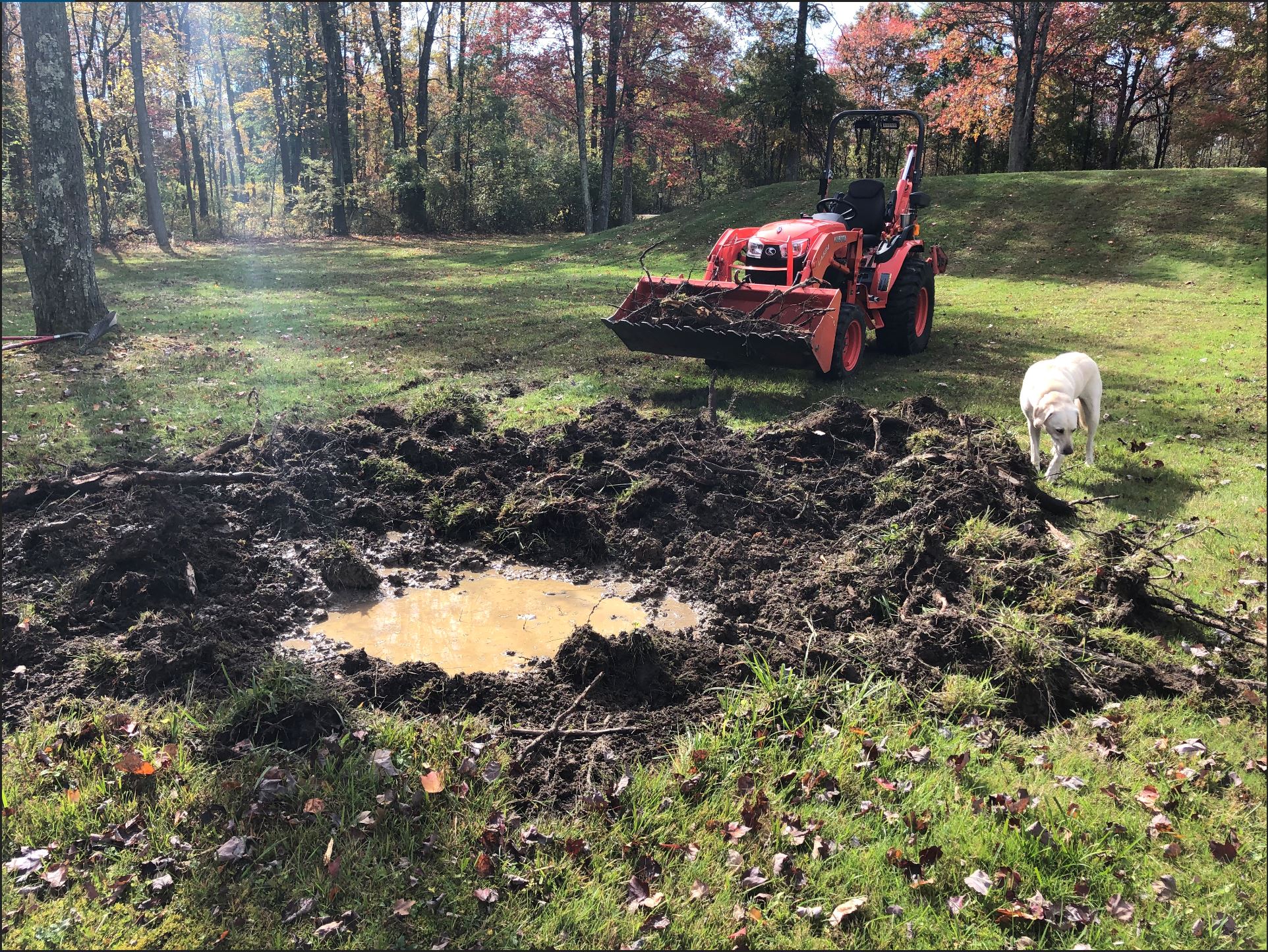

Option 3:
