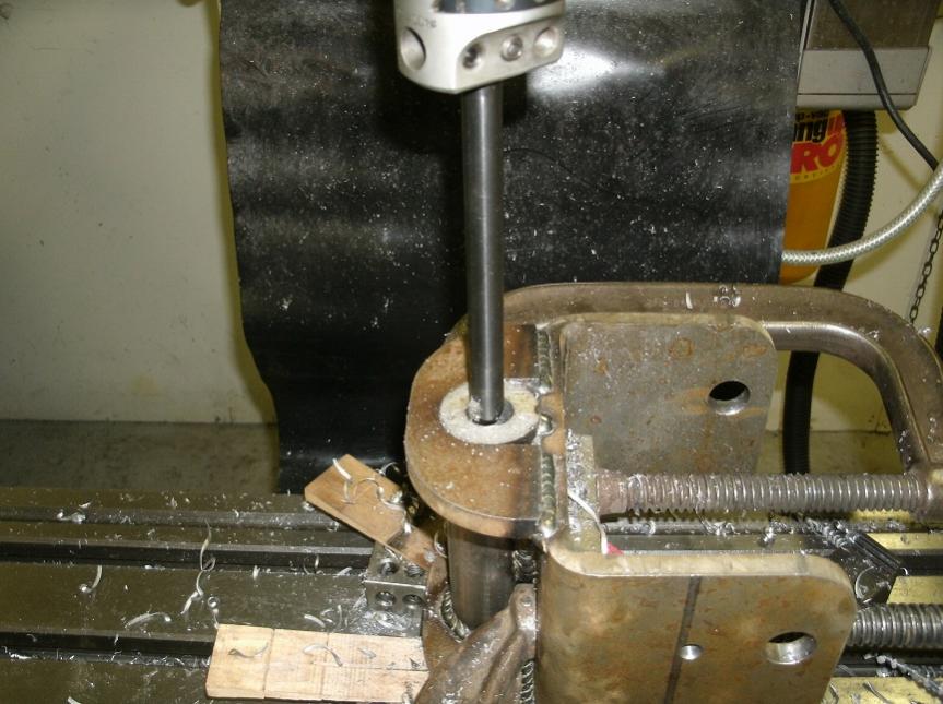

Working on the yoke here. Didn't have any 1-1/2 thick wall tube left, so I had to use solid bar which means drilling and boring the hole for the pin. Then I started fly cutting the surfaces for where it will attach to the 3 point hitch.
