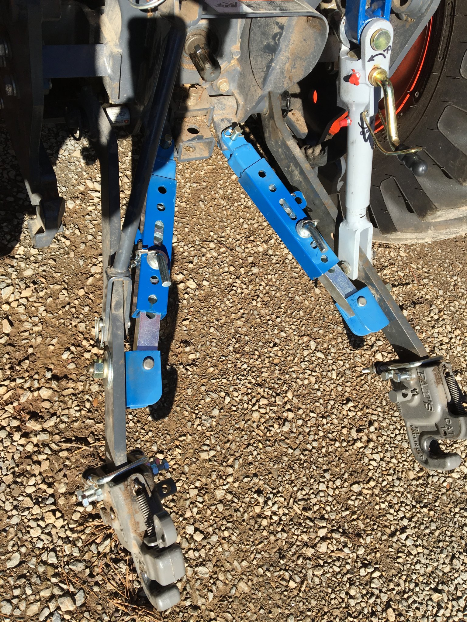

I noticed you don’t have the standard 3 ph barsetc, did you use the ones with extenders off a different tractor? same for the sway bars that are usually turnbuckles on the standard option?
notforhire
Kubota L47
Dec 5, 2019
148
69
Meadows of Dan VA.
I noticed you don’t have the standard 3 ph barsetc, did you use the ones with extenders off a different tractor? samy for the sway bars that are usually turnbuckles - not sure if that is the right ter?
When I bought my L47 I wanted a Tractor Loader with no intention of getting the backhoe attachment.
Most of my use is loader work and I felt that the L47 was a better choice than the Ag tractor with a (material handling) loader attachment. The well braced loader of the L47 combined with the huge subframe make it superior for dirt work.
That's what it was designed for.
I wanted to do some 3pt hitch chores like bush hogging so I opted for the 3pt hitch kit rather than just attaching a counterweight to the backhoe attachment point.
Instead of getting the optional 3ph kit that can be ordered with the tractor, I requested the extendable lower links and telescoping stabilizers.
My dealer provided what I needed. What model tractor they were designed for I don't know. I suspect they may be from a Grand L.
They fit and work well. No regrets.
If bush hogging instead of loader work was my primary use I would have bought a standard Ag tractor with a QA loader and cruise control. While the L47 has a hand throttle it is necessary to keep your foot on the hydro pedal as you mow. It's also heavier than needed for Ag chores.
It's a small thing but if you want to side offset your 3ph attachments the backhoe "hangers" can get in the way.
