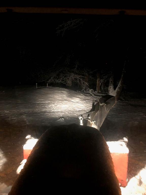

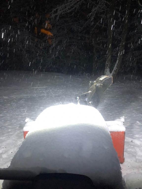

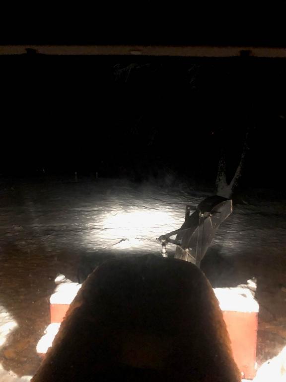

Thought those who are still on the fence about LED lights and how much light output the smaller units put out, would appreciate the following comparison.
Please keep in mind the camera adjusts and made the stock halogen bulbs better than what they appear in the pictures and actually made the LEDS look a bit worse.
Posting to show mega dollar gazillion lumen lights are not always necessary. They do look cool though! These are cheap 36 watt units that pull far less amps than their watt rating would imply. (I actually measure the current draw on the LEDs)
These are the ones I used for reference. https://www.amazon.com/Nilight-4PCS-6-5Inch-Flood-Warranty/dp/B01N0SFVCT/ref=sr_1_5?keywords=36+watt+led+flood+lamp&qid=1578448040&sr=8-5
Put a set of these front and back and you'll have plenty of light and drawing less current than what the stock hi beam pulls.
Have a Super Deluxe day!
Added in edit on 01-30-2020:
Each LED lamp pulled a measured 2.06 amps, so a pair draws 4.12 amps. This (4.12 amps) is slightly less than a single halogen 55 watt bulb.
The package rating is overstated. Each lamp should use 36 watts, but is only drawing 26 watts. I'm only mentioning this as the package rating can be misleading when selecting wiring and switches.

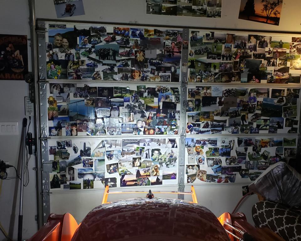

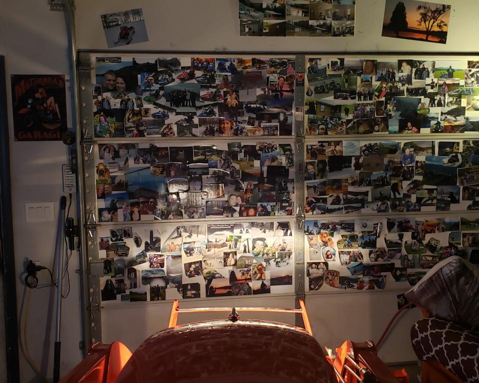

Changing out the headlights will help as well.
I changed the two 1156/1073 bulbs (about 25 watts each) in the headlights to some LED backup bulbs that pull just under 7 watts each.
Much wider pattern and much brighter/further throw.
