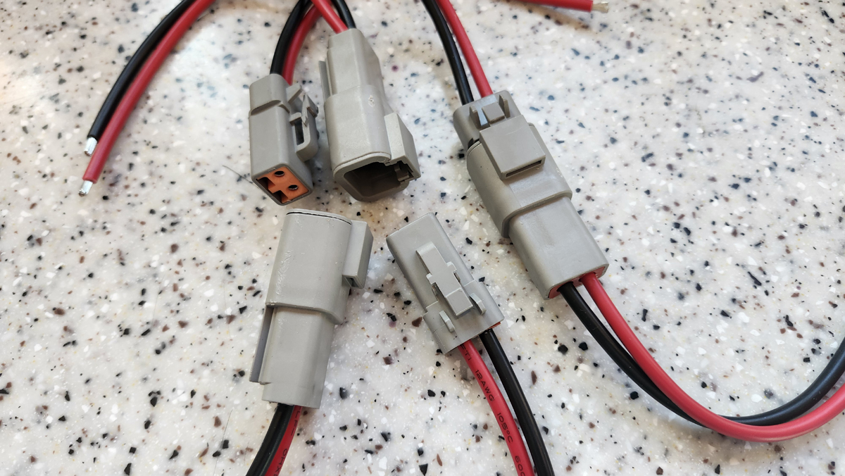

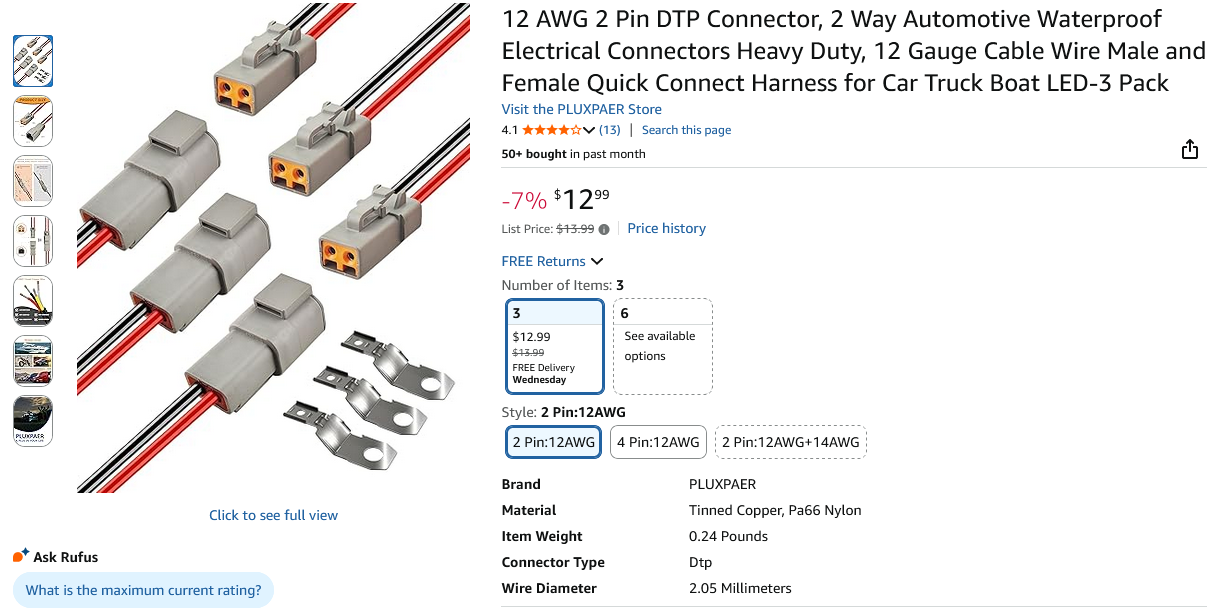

The ones I ordered are basically the Deutsch style. I'm not going to be connecting and disconnecting the battery charger from both tank pumps very often so I'm not concerned about the connectors being overly robust. I'll take easy over robust for this application.
Here's the link to the connectors I ordered.
I don't know if I would have chosen that style for frequent connnections and connections made under load- they weren't designed for that. The Anderson SB50 connector would be ideal for this. Contacts are available for 12AWG.
Here's a knockoff example- https://www.amazon.com/Micrl-Disconnect-Electrical-Connector-Recovery/dp/B09WRLBZFY?th=1
The 10 AWG contacts are for 12-10 AWG wire. https://www.andersonpower.com/us/en...ver-plated-wire-contacts-12-to-10-awg-bk.html
But it's not for frequent connecting and disconnecting and certainly not made under load.
My bad. I read this and assumed you were swapping batteries/chargers/pumps in and out frequently and there was no mention of using a switch to disable the power before making the connections.
I just ordered two sets of the connectors shown below with 12 ga wire. I don't care for the SAE connectors despite having lots of them for the three battery tenders that I use. They're not ideal for connectors that are repeatedly connected and disconnected. I'm not saying that the ones below are perfect either, but they're much easier to connect and disconnect, and they're waterproof, not that it matters much.
I just want an easy way to connect the modified DeWalt battery charger and battery to the pumps of either JohnDow storage tank, while making it easy to also connect the factory alligator clips if needed so that I can connect to a car/truck battery or similar. I like options.

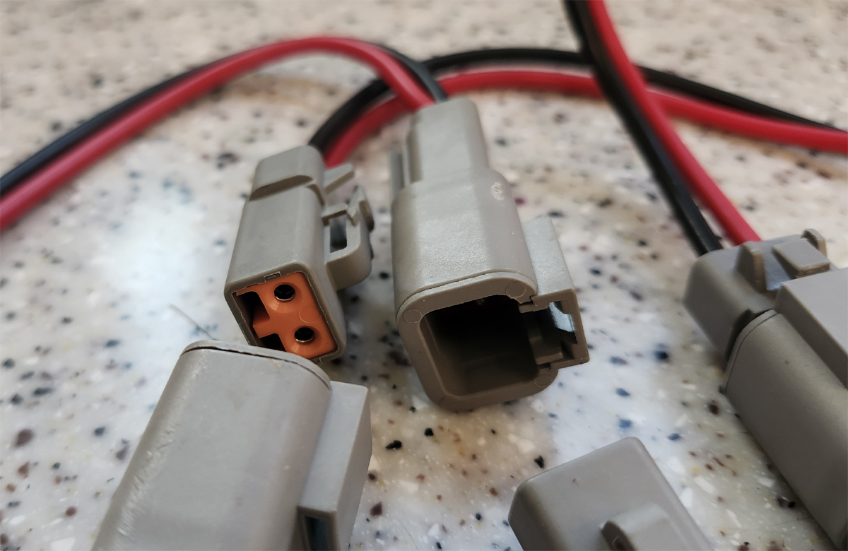

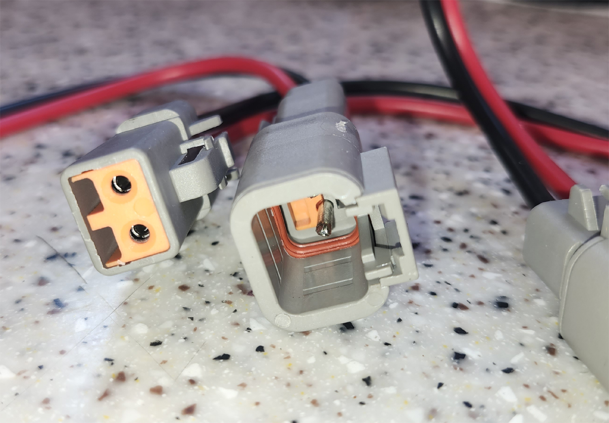

11,757
The connectors I ordered came in yesterday and they're going to be perfect for my application. I don't need them to be waterproof, but there's a gasket inside the female connector. They're really easy to connect/disconnect so I'll be able to connect the modified charger with battery, or use the original alligator clips. They're a good size too, and look to be strong enough to last many years.
