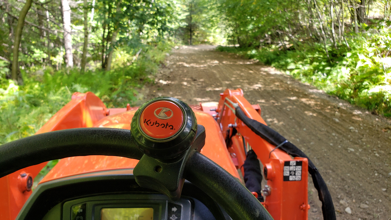

Really mess with yourself, put a spinner on it. :eek: :D

I have spinners on all of mine. Doesn't bother me a bit.
Yep! Moved my spinner twice. Gave up on it once I figured out what was going on.

I am really sorry to learn of this wheel issue. I got my new B2601 today and soon noticed the crooked wheel. Pointed it out to the salesman who had delivered. "Yeah, I hate that too—some mechanic assembling the tractor slapped it on there." He told me I could pop the center cover, access the nut, and straighten it. So I did—my first adjustment to the tractor.
I wonder if it will get as far out of line as it was. Also, I plan to add a spinner . . . !
