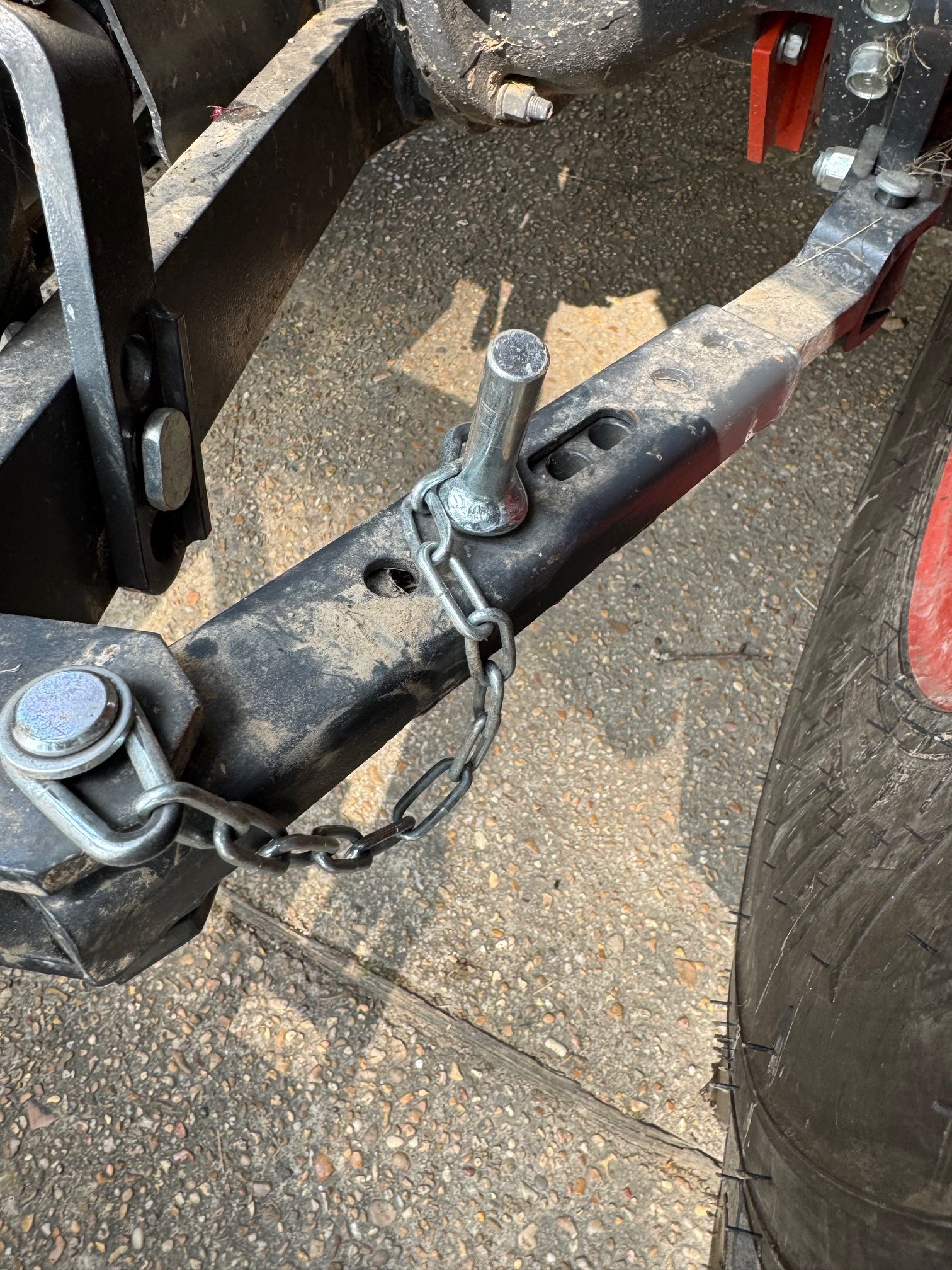

Hi gang! I've had my L4802 for 14 months and already have over 115 hours on it. That may not sound like alot but when you're cutting pasture a few days almost each week and lots of that in Mississippi heat, it's forever!
I think I have it running better than ever for my property which does have areas where it's bumpy so I adjust almost after every ride. One of the things I can't figure out is why it was delivered to me with the Joint pin on the left side in the first hole and the one on the right in the third hole (and I also realized I've been running it without the pin which either fell out or, they did not attach it before delivery last year).
Try as I might, I can't seem to get the stabilizer to move into position so that I can remove and place the Joint pin in the same spot on both sides. In reality, it's working fine so I tell myself to leave it alone but as I am a novice, I want to make sure I'm taking care of things and would like to figure out if this makes any difference at all.

I assume that you are using a rear mount shredder to cut the pastures.
The stabilizers should be somewhat equal or they will push the implement off to one side of the tractor. But you might want the implement offset at some times.
When using some implements you will want it fairly rigid to the tractor so both sides will be in the round holes. For a shredder most people will use the slotted holes to allow the implement to move around some. I am not sure how much the implements will move if both sides are in the shots but perhaps the dealer thought that was too much for delivery of the tractor so the put one side in a slot and one side in a round holes.
You should be able to move both sides when the pin is removed. Yours may be rusted together and will need some work to get it moving. Or the pin could have gotten sheared and is jamed between the parts, which is not very likely. Anyway you need to get it loosened up so that you can adjust it unless the shredder is all you will ever use. Then it could be left alone. But I would personally fix it regardless and put some grease on it.

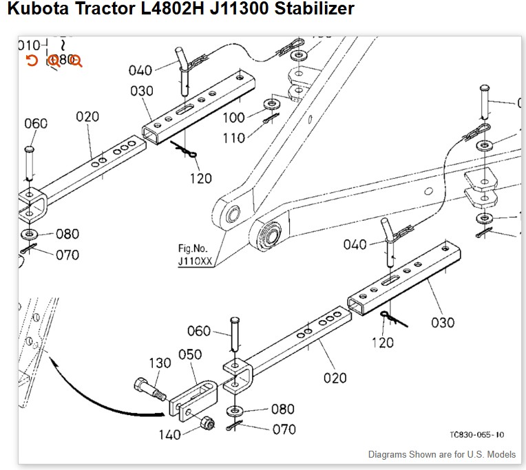

The pin should be replaced with a new one from the dealer or from any tractor shop (but wouldn’t have the chain you show if from alternative shop)

I mostly use the Lands Pride brush hog for my pastures and it seems to not be swaying to any side though when going over bumpy areas of some pastures, I do need to level the brush hog.
The pins come out easily enough, I just can't move the right side but I have not tried anything like WD40 or any grease/lube to loosen it yet.

You should try a better rust penetrating oil than WD-40!
Try PB Blaster, 3 in 1, Kroil, Mouse Milk or something similar. I think you might be amazed by the difference in the results of these products over WD-40.

This might not be the case but the very first hole on the stabilizer looks to have some crap / dirt / twigs in there (and mud covering the outside of it). I would unbolt it and pull it apart to clean it up, then try lubing it a little.
For the most part, my left and right pin holes are rarely in the same location.

I'd spray it with something other than Water Displacer #40, leave the pins out take it for a ride down the drive ...

This pins do not have to be in the same spot on each side. As long as your implement is centered you are good to go.
If they are hard to move, remove the implement and blow them out with compressed air while moving them.
I’ve had better luck leaving the stabilizers dry as any oil or grease will attract dirt then make them harder to adjust to line up.
That hole was cleaned out and was mostly dried grass.
I just got finished hitting 3 acres of both flat and bumpy terrain and it did very well since my last adjustment. I'm going to call things good but when I get the blades sharpened after the season, I'll bring these things up and see what the people who take my money say.
Correct- the pins do not have to be symmetrically placed. There are variations that may not enable that, and symmetry does not affect performance. As long as your implement is in the position that you want, pin the stabilizers and go for it.
