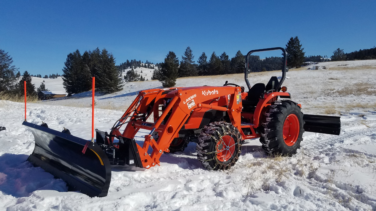

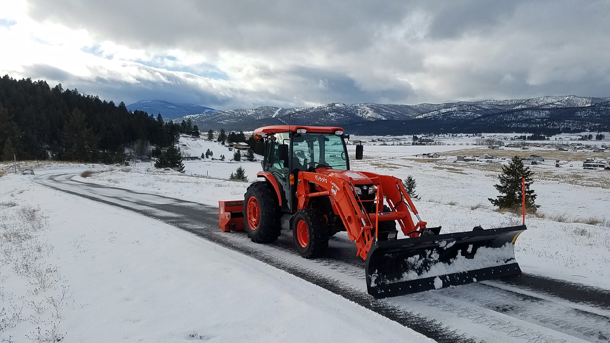

I don't know how helpful this will be but I've used the Land Pride STB1596 for the last two winters and have no complaints. First winter was on the MX6000 open station, and this past winter was on the cab version.
The 1596 has a trip function, the blade can rotate +/- 5 degrees in the vertical plane to better follow the terrain, and it does a great job of moving snow. I use the 3rd function buttons to angle the blade left to right and the loader tilt function to change the angle of attack, both of which work well. I generally float the blade but don't have to. I also run a snow blower on the back but if I could only keep one of the implements it'd be the snow blade given that it's more versatile. The blade does feel like it's way out there but it hasn't been a problem for the MX.

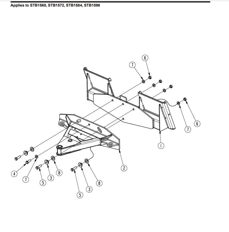

I downloaded the parts manual for your plow and its much better than most. It looks like the kingpin is just a 3/4" HHCS and they have three others on the periphery of the swivel plate. I like it - should be real easy to make.

Much appreciated. I am not going to do anything real soon so take your time. I need to have the angling cylinders and OEM clevises I ordered to figure out exactly where they get welded on before I can cut the A frame back.

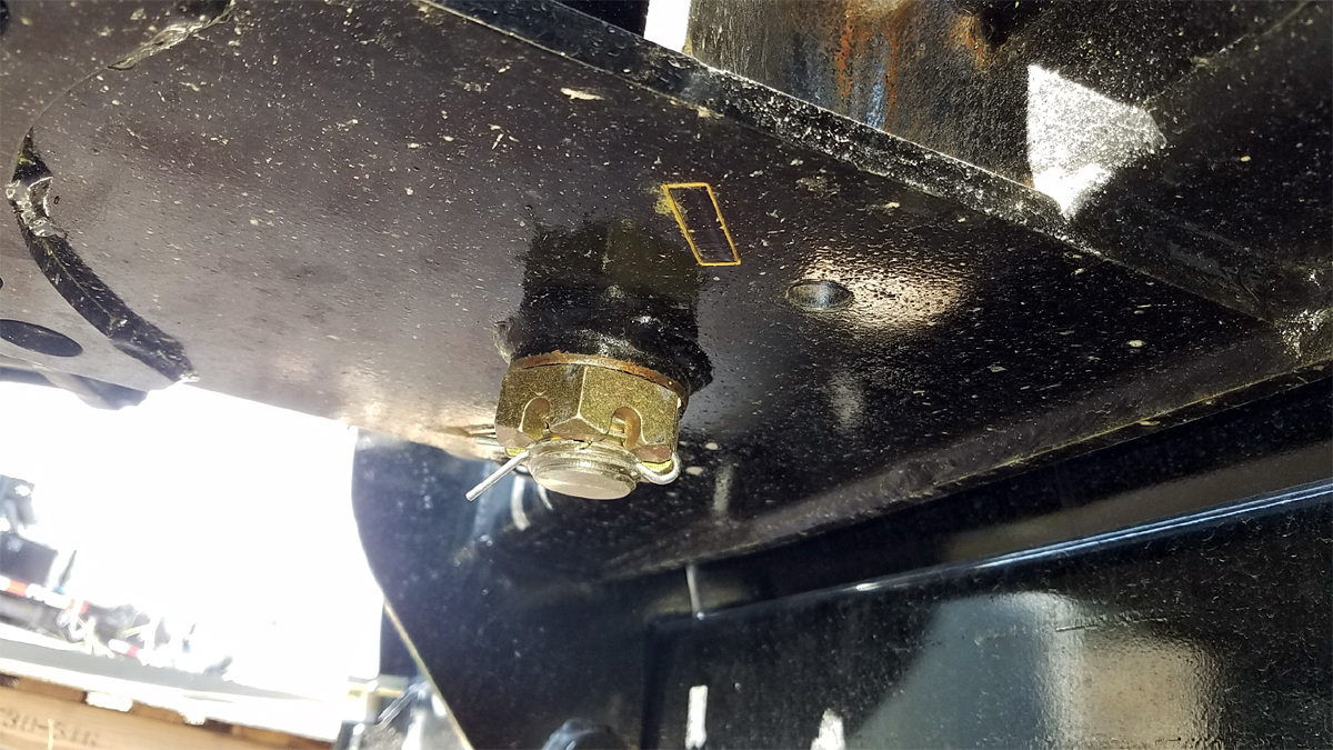

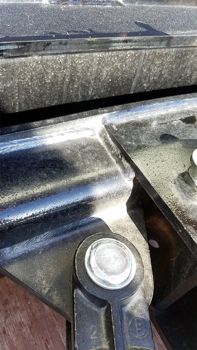

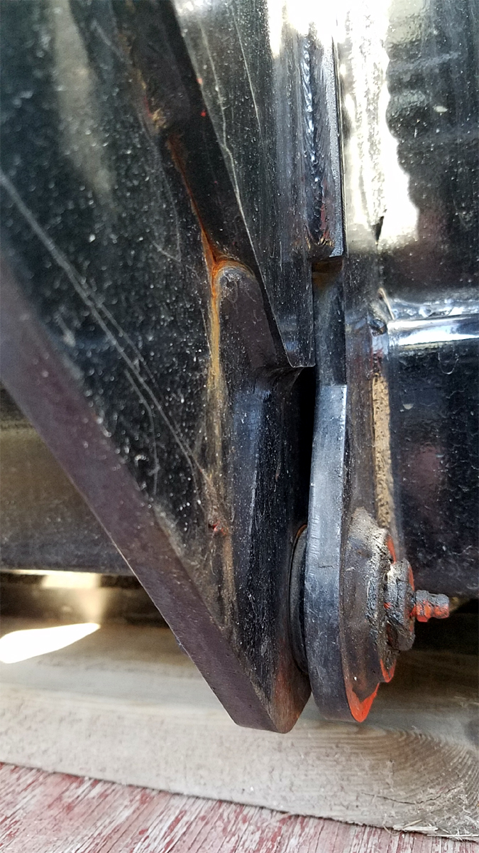

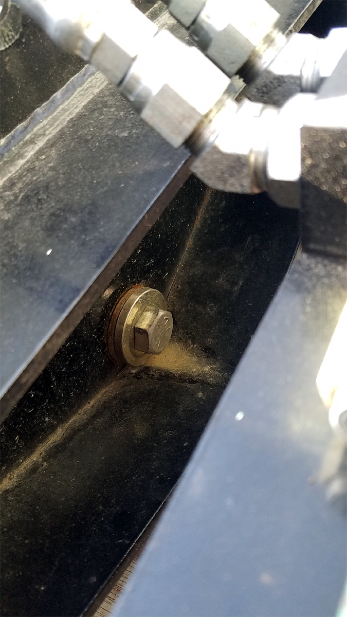

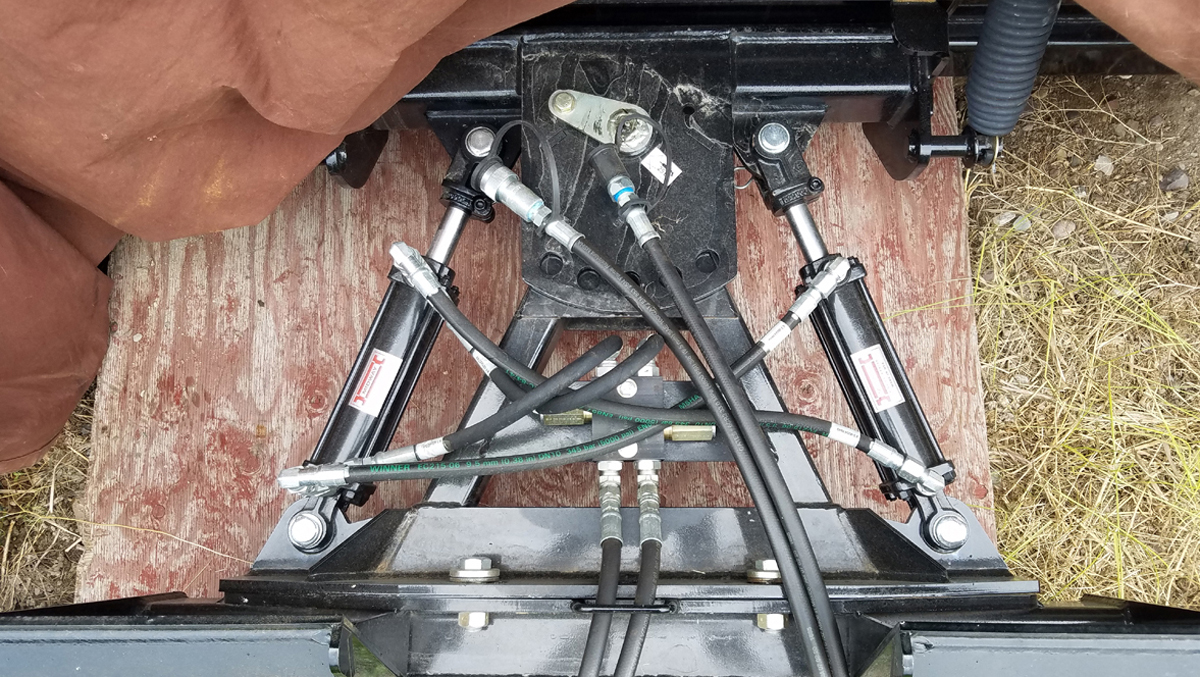

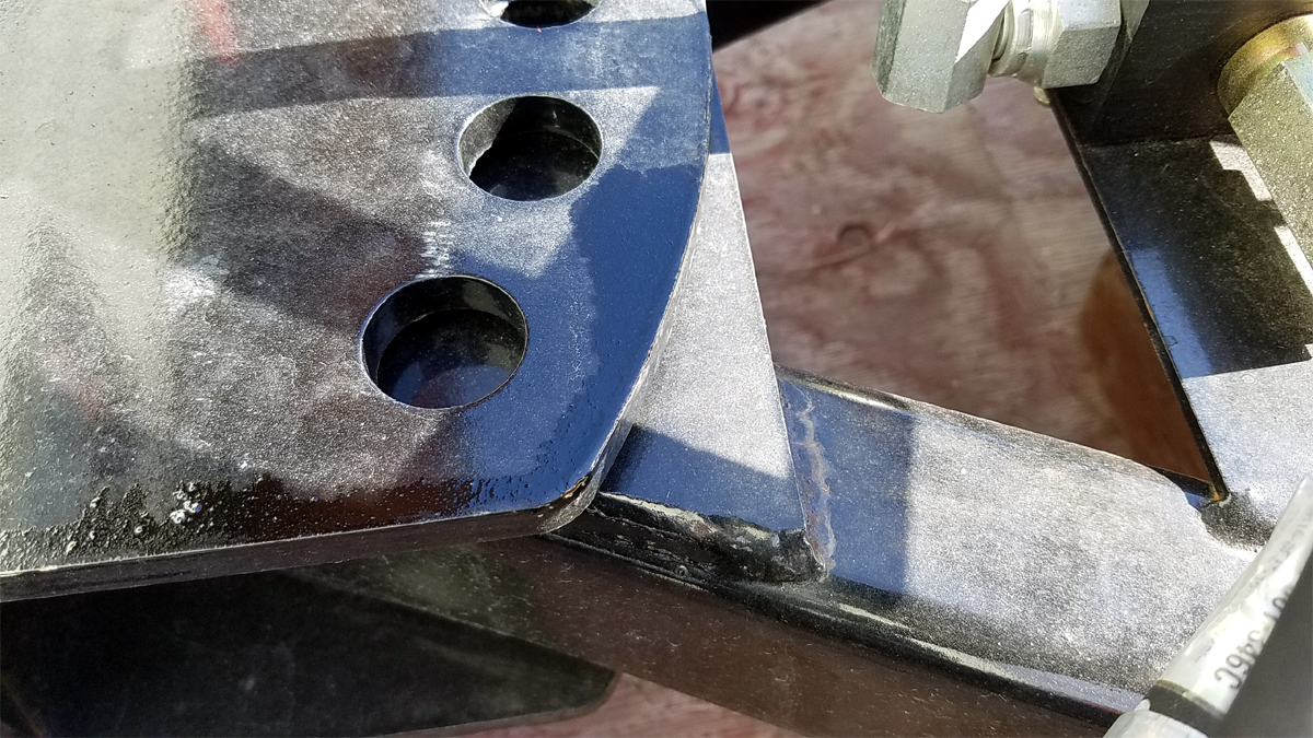

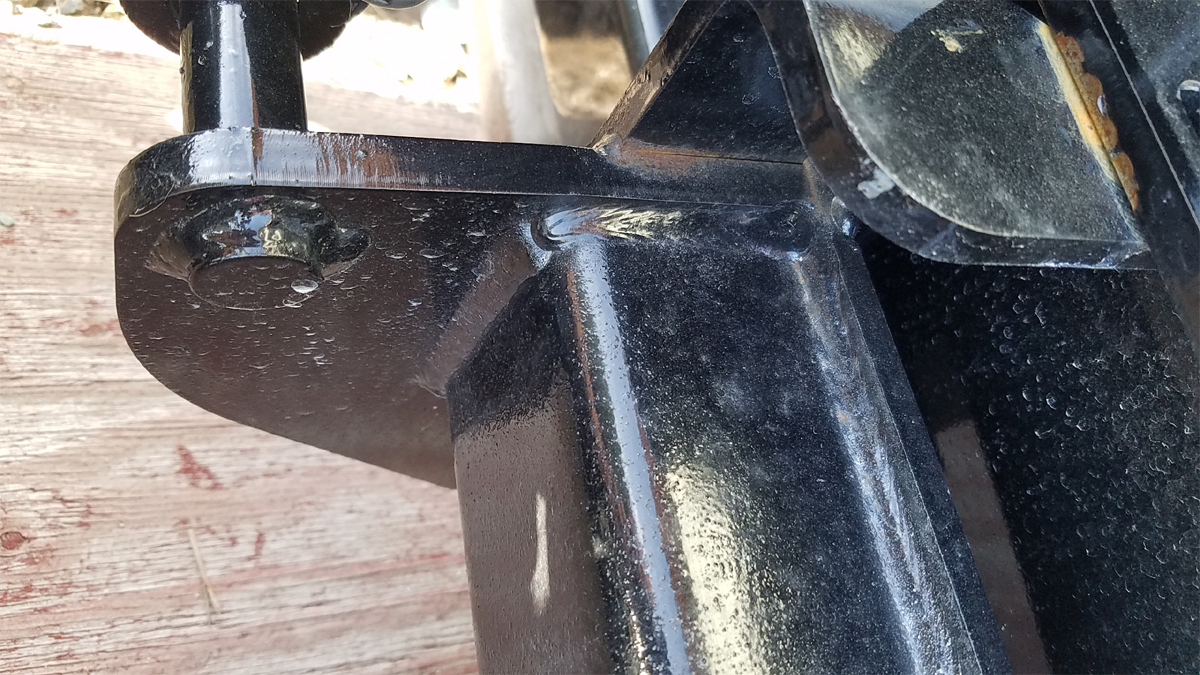

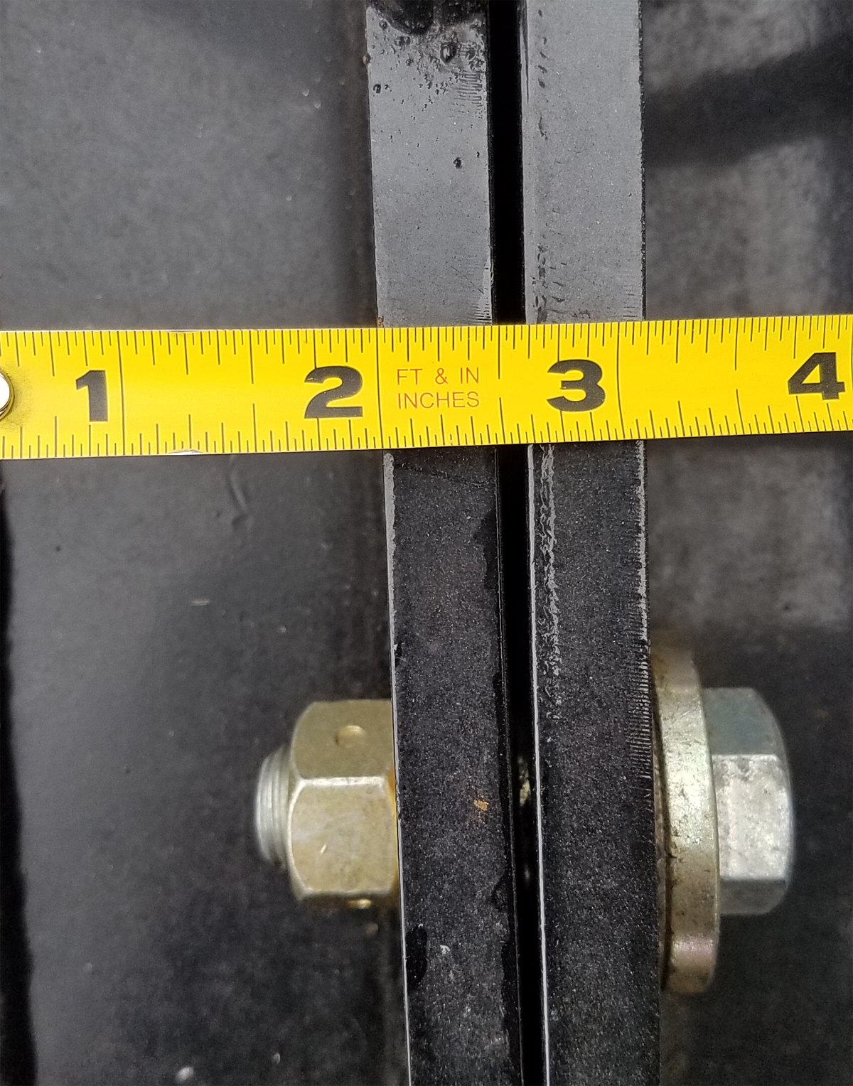

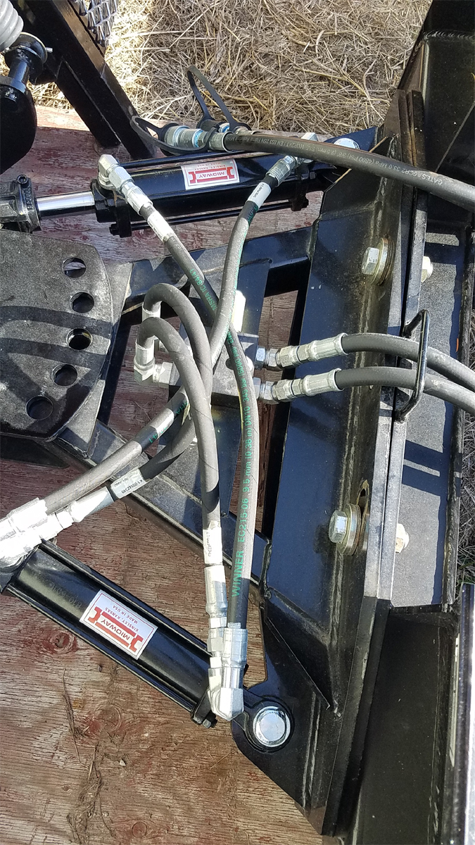

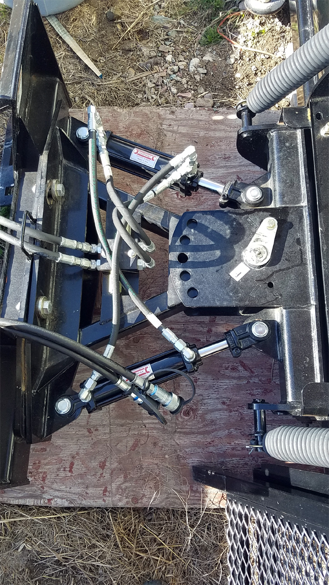

Great. Here are some photos and let me know if you need more or if you need measurements. I'm not sure if you know this, but bolt #4 is the locking bolt that prevents the blade from rotating +/- 5 degrees. Land Pride states that the bolt should be installed for shipping. With the bolt removed, bolt #5 and it's mirrored twin ride in a slot and the blade pivots around another #5 bolt at the 6 o'clock position.

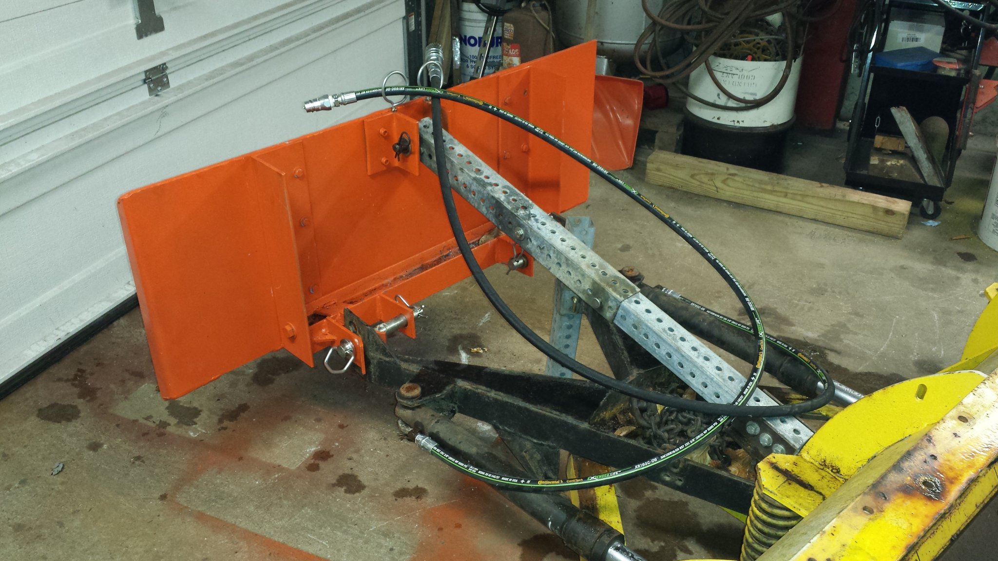

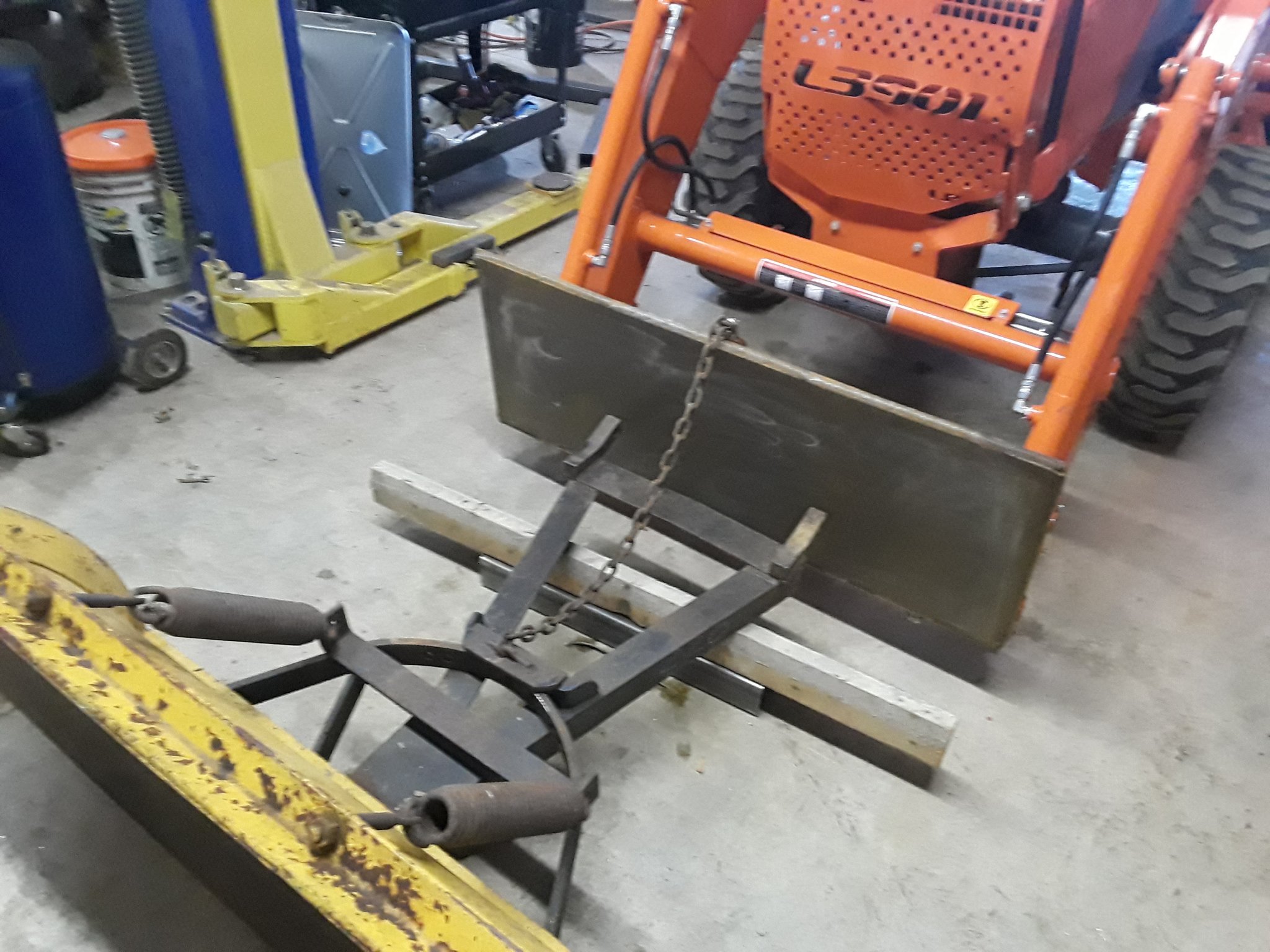

Attached is a plow build I made and use. I used a Fisher Plow and attached its vehicle cross member to my QA plate. I have the plow set up with a stiff hitch for the purpose of back dragging snow but also still have the original chain attached that will wrap around the QA stiff hitch center pin for a full float snowplow as the original manufacturer designed. The stiff hitch will to some degree slide for a float function if I pull the pins.
I have never used the chain attached; I find that plowing with the blade in Hyd Float or in a fixed position is sufficient. The one issue I do have is this is a 7-1/2’ blade and if the snow is heavy enough with the blade angled it will skate the tractor sideways. If I make my first pass/s with a straight blade and then angle to clean up this issue mostly eliminated. I do not use front mounted chains which may elevate that issue.
I intentionally wanted the blade further from the QA plate for the sole purpose of pushing snow over a steep bank keeping the tractor further from the edge and piling snow.
I also use this QA plate with a straight 10’-2” Schd. 80 BI pipe Jib boom, the pole attaches to the top pin with two out rigger supports attached to the bottom outside pins.

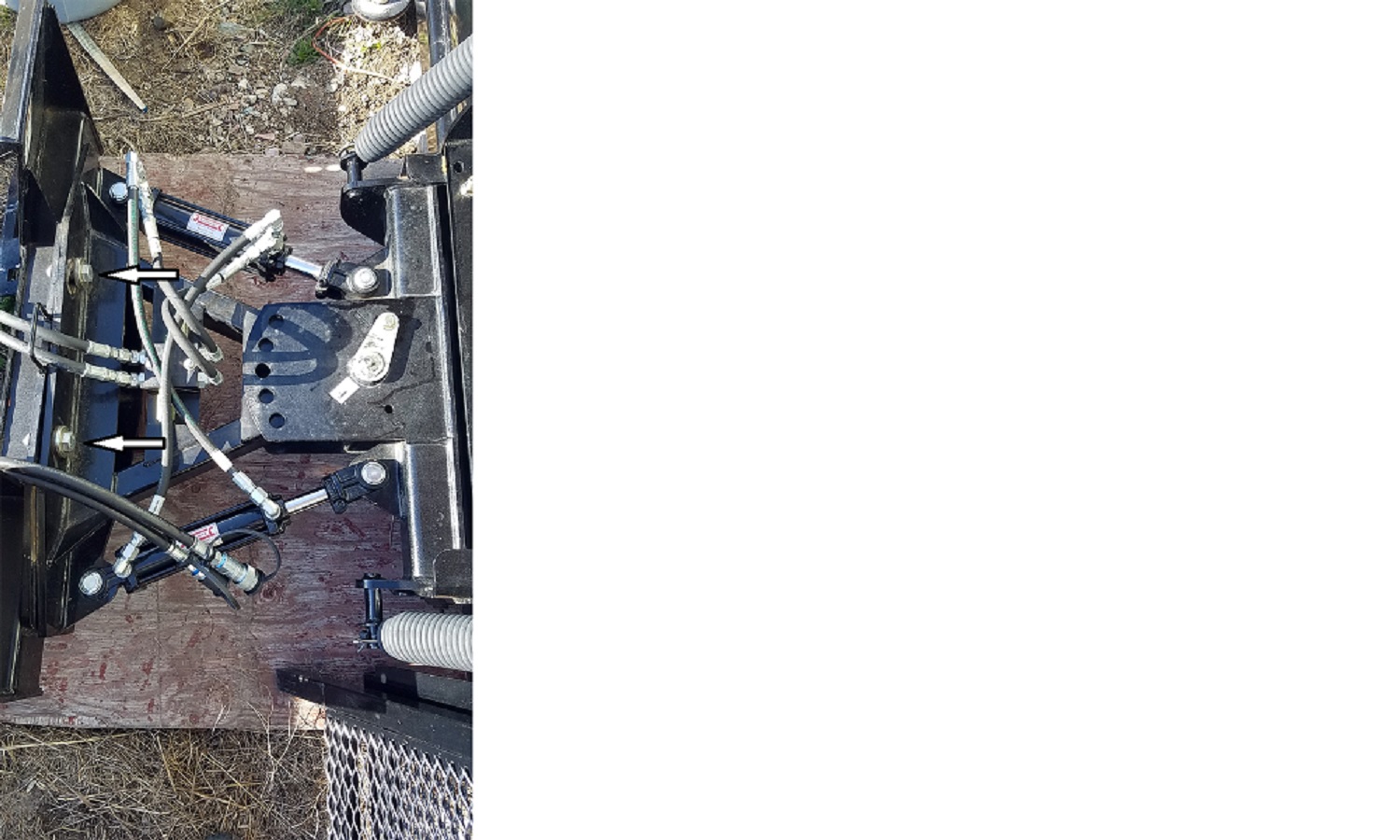

This is very helpful. Looking at the parts diagram I thought the pivot point was at the top of the plate which is bass-ackwards. The two pinch bolts in the picture below are kept just snug and used to stabilize the top of the push plate which pivots on a similar bolt directly below and in between them. Three bolts not four as I initially thought?
Exactly right. Those pinch bolts ride in slots, and this is the lower bolt that the blade pivots about.

11,906
5,169
interesting that the mcmxi unit has dbl acting 'angle' cylinders. seems overly complicated and expensive . All plows I've had were single acting.

Even if you pay to have the plow sand blasted you'll still be way ahead of me. Doing it right once is always better. I look forward to seeing your finished project, and don't hesitate to ask if need any more information.

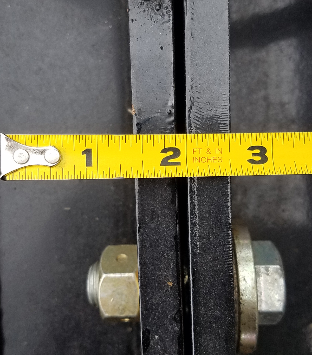

Thanks - could not figure out what that picture was the first time around. This is very straight forward. I could blast the thing myself but running my little pot blaster is not a fun job. I will certainly pay to get the blade blasted if nothing else. I may also pop to have that pivot plate laser cut rather than spend a lot of time trying to mill the slots on a rotary table. Quick online estimate from a local shop was only $40 and they are not far from the truck repair facility so I can pick everything up in one trip into town :rolleyes: . The plate on yours looks pretty thick - 1/2" or 3/8"?
Yes, both plates are 1/2" thick.
