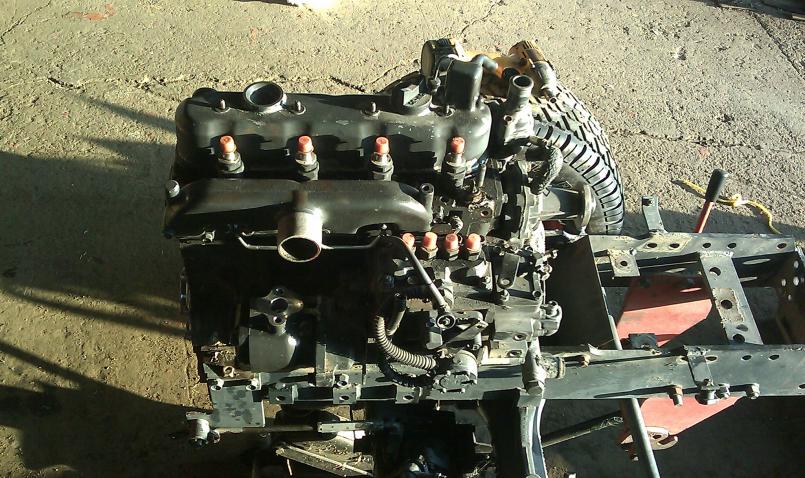

The front part was supported by a stout comealong from overhead, and the rear was rolled back away from it. Your idea of blocking the front axle to keep it from pivoting is good. Mine was a little "floppy" with only the single overhead point of support. If I recall correctly, the front was a bit nose-heavy and I had to remove the small suitcase weights to make sure it didn't want to flip over forward.
The rear portion has some vacant tapped holes in the trans casting. I made up a couple steel props that acted like stands that worked like the legs on a wheelbarrow. These were bolted on before splitting the tractor and were long enough so they just kissed the concrete floor. The Ford was small enough for me to wheel the rear part back away from the stationary front part. Looking back it might have been useful to support the back part with something like a transmission jack on wheels.

I blocked the front axle with wood shims to keep it from swinging side to side. I bolted the drawbar to the wood deck I was working on, you will probably have to just block up the transmission to hold it in place.
Roll the front end away from the back end leaving the back tires blocked front and rear to keep it from shifting around on you.
