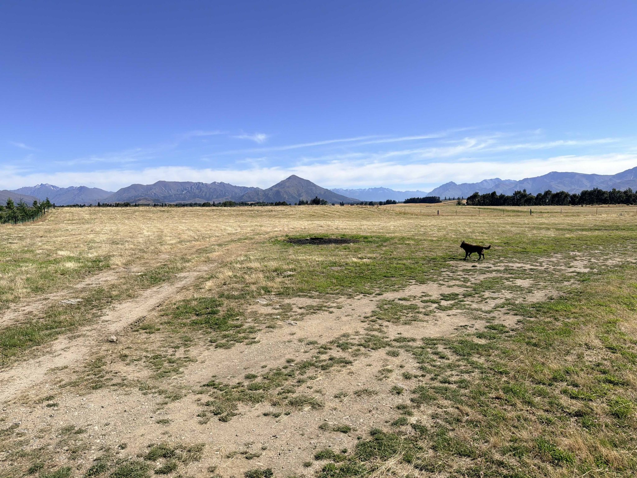

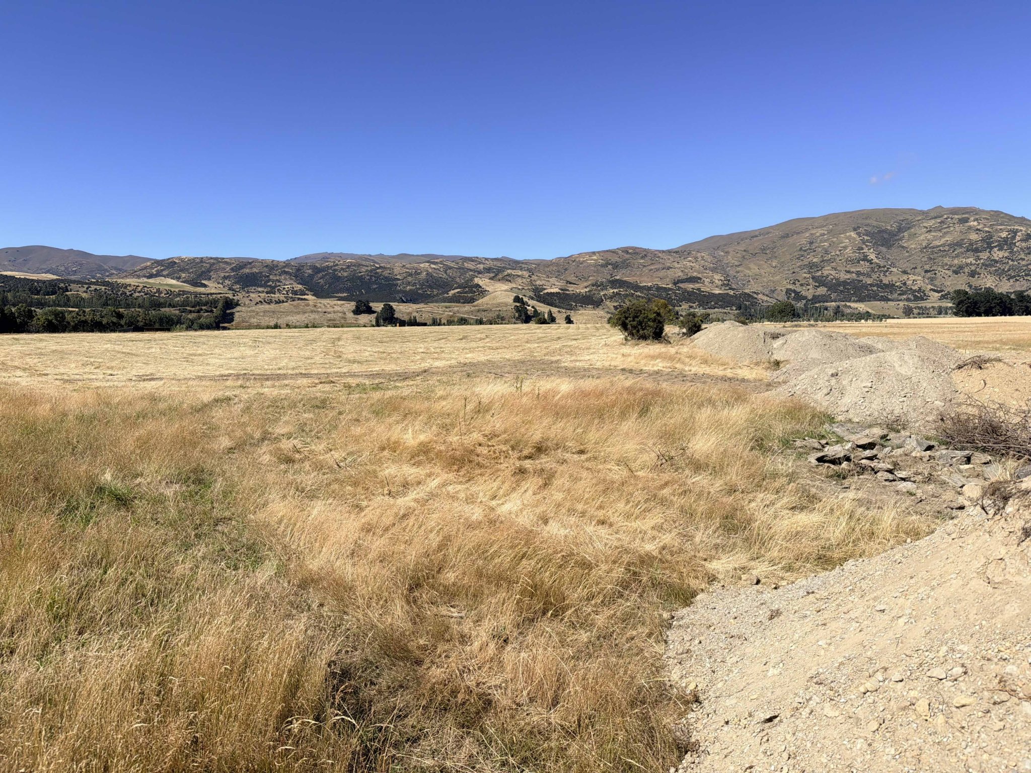

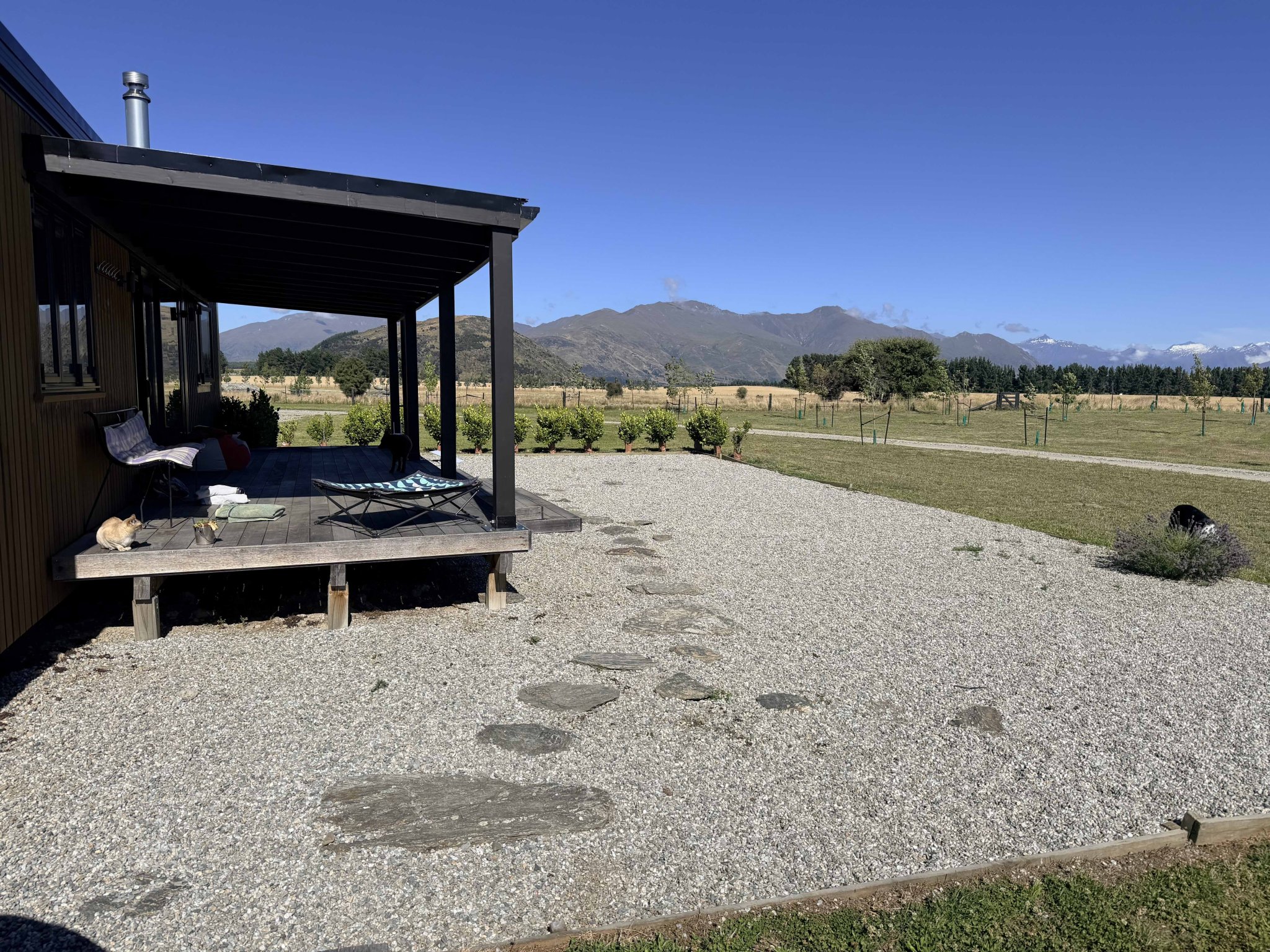

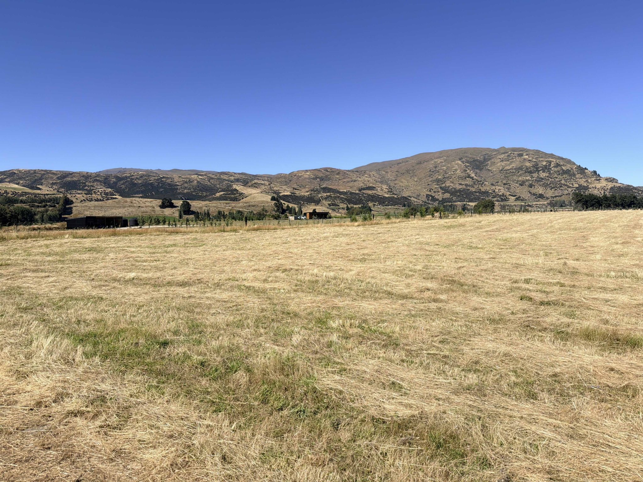

Adding a few photos:
This is the north end of the property, looking along the irrigation ditch. Those piles will get pushed in to fill it in somewhat, but you can see the neighbour took hay off, and left all the difficult parts - which is what I want to mow. This is looking south west, the house would be slightly out of frame to the left.
This is the east of the property. This paddock has been mowed, and is pretty dry.
This is again from the north, similar to the first shot, but looking almost due south. You can see the house in the distance.
Looking across the front of the house - this is the house section, and you can see some of the trees along the driveway - these all have to be mowed around.
This is looking from the implement shed towards the house - same direction as the previous photo but from further away. Again showing the trees down the drive that need to be mowed around, and the driveway that will need maintenance.
