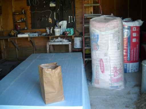

Well, the easy part is done...:D Lumber Yard delivered most of the supplies today. I had them hold the drywall until I call as I have no place to store it out of the weather.
After talking to the folks at the yard, I opted to go with blue board for the rafter bays. I was told that any pinhole in the silverboard that allows ANY water in will ruin it as the filling is easily water damaged.
Once the rafter bays are insulated, I'll hang the 20' 2x6's for ceiling joists and put R19 bats in the ceiling joist bays. That should take care of insulating the roof. Also have beaucoup rockwool for the walls.
Electrician was by today and installed the 100 amp service entrance. Now all I have to do is get the line construction guy to answer my calls OR pay extra to have the utility set a pole. Once the pole is set, they'll run the primary wires and hook up the service. Much as I'd like to have that done in a week or so, it's not really critical that it be done until it gets cold enough to need the furnace.

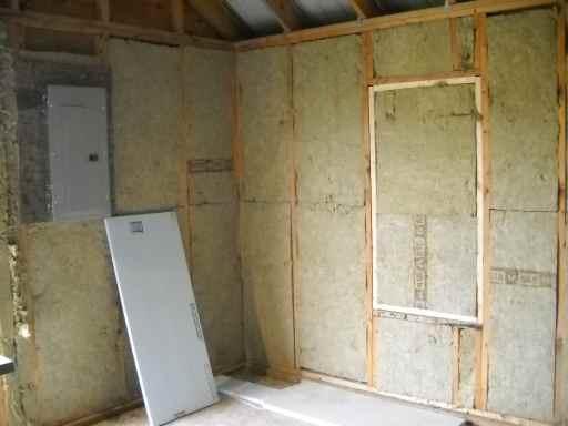

Spent the morning removing a window (to be reused elsewhere in the building) filling the hole and cedar shingling the outside of it. Then spent a cheery afternoon stuffing batts of rock wool in the stud bays. About 90% done with that, the 5 bays that are left are all cut-and-fit around stuff so that seemed like a good place to knock off for the day.

Grandson #2 was able to put in a few hours this morning, we got a bit over half the rafter bays insulated. I did the rock wool in the walls myself over a couple of days. That stuff is MUCH easier to work with than the faced fiberglass stuff. I went that way mostly because the didn't have any 2x4 on 24 batts in the system.

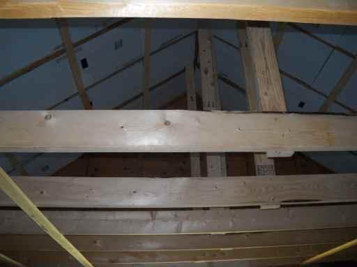

Ceiling joists hung, braced and mostly strapped.
The vertical members tie the center of the 20 foot ceiling joists to the peak of the roof rafters. They alternate sides of the ridge board to even out stresses on the roof.
I installed them for two reasons:
1) To prevent the weight of the insulation and drywall on the ceiling from causing the joists to sag, and;
2) I'm going to put a trolley-mounted hoist down the center of the building. I have it in my garage at the moment and it's handier than a pocket on a shirt. It's a Horror Fright 110v winch rated at 400 pounds. Of course I won't be lifting anywhere near that amount of weight, but for lifting small engines up onto the bench and such it's very handy. I've been using it in my garage for years suspended from the trusses. Not an engineer, but I think this arrangement will be sturdier.
Strapping is on 24" centers to screw the drywall ceiling to. I'll finish strapping it after I frame a hatch for access to the deck in the rear 8 feet of the building and get the framing finished up for bolting the trolley track to.
