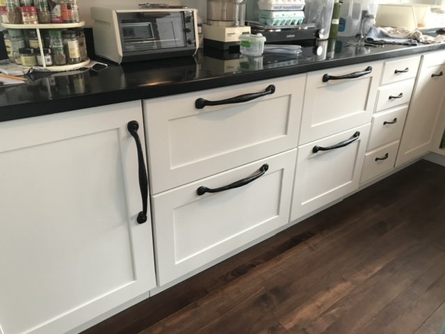

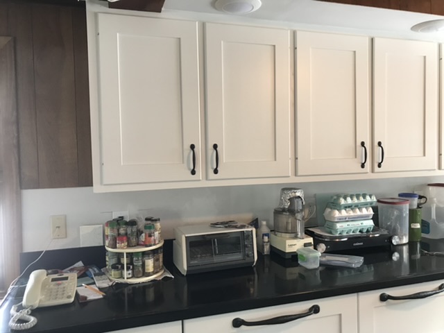

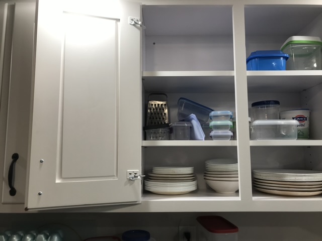

My kitchen project is nearly done, and I ditched the previous contractor who was wedded to the one cupboard supplier and wouldn’t deal with any custom designed cupboards. Lucky to find someone who has been in the construction business a long time and knew what I wanted and how to do it. He ordered cupboards with thin Formica linings from one source (easily washed), doors from another source, and made and painted the styles, rails, kick plates, end panels etc himself. It has been great because he would ask me how I wanted something and it gave me a lot of flexibility. For example I started out assuming I wanted all the handles in the middles of the inset panels for symmetry, but when it came time to put them on he pointed out that on the lower drawers on the refrigerators that would mean bending down another 8 inches, so I changed my mind. This kitchen is all about making things easier. Two doors arrived warped and have to go back, but by and large the design provides the snug fit I wanted.

1) Very nice! Obviously a custom, or at least customized, job by a skilled cabinet maker.
2) I used to do some stuff like that and custom furniture. Got to the point it was either quit my day job and go into business or quit the carpentry so I don’t still do it. The problem with getting the style cabinets you wanted is all because of that little rabbet around the edge of the door. A “modern” door sits entirely outside the cabinet opening on European (i.e. “cup”) hinges. Those hinges, unless they’re really cheap ones, can be adjusted all over everywhere. With the door just sitting on the outside of the cabinet, there’s no way a mis-sizing or mis-alignment can cause the door to stick or drag. Precisely sizing and aligning the door isn’t required. With your cabinet’s little rabbet, it will seal much better but if it’s mis-sized or mis-aligned it will cause dragging, sticking, or not shutting at all so more skill and care is required of the builder and installer. It’s not so much that the style of cabinetry is out of fashion, skill and care are out of fashion probably because few people are willing to pay for them.

Looking good. Glad you were able to find someone who was able to do what you wanted and not what they insisted you should have.

I love the personal touch on a very professionally done renewal project. It appears very user friendly and you should really enjoy it.
Now how 'bout a couple more pictures showing the sink area? ;)
