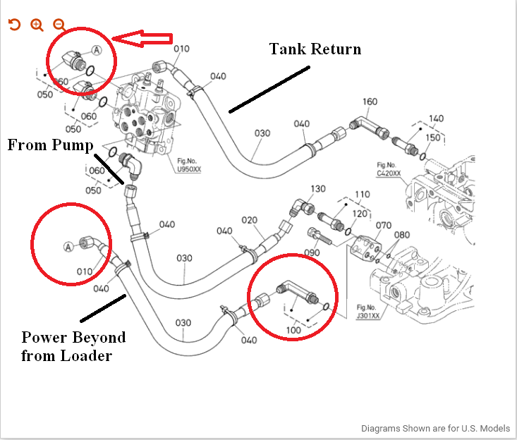

EVERYTHING in the loader plumbing and valve can be tested by removing the power beyond return connection at the location I have circled in the diagram below and rerouting that hose to the hydraulic filler. That completly removes the 3pt from the loader circuit. If all loader functions operate correctly with the power beyond hose rerouted the problem is in the 3pt circuit somewhere AFTER that reroute point.
I think there is already amble evidence to believe that to be the case but the OP can make that 100%. and put all this speculation to rest.
PS》If its easier to access the PB circuit can also be diverted at the point marked "A" in the diagram. Just unscrew the hose and slip a piece of vinyl tube over the end of the 90 degree fittting. There will be some significant flow and modest pressure there so clamp as appropriate. Run the other end of the tube into the hydraulic filler on the tractor.

Well Dan had me check the couplers on the quick coupler. Good pressure on the bottom side with my gauge and found I had flow through the top side by removing the top hose of the lift and down couplers added a piece of hose into a bucket and functioning the joystick. Ive been trying to figure out my problem the last 3 days and had the quick coupler off several times. Three days ago when I opened the coupler I notice a few drips from the coupler for the down function. In the next two days I noticed that coupler releasing a small stream upon opening. I didnt think that coupler could be my problem as it was letting fluid through it. Well today I decided swap that coupler with the curl coupler to test. Sure enough the loader goes right up. NOW why changing a leaky coupler for the down function gave me my lift back is beyond me! I have ordered that new coupler that goes on the top side of the quick coupler and its $99.67 at the stealer! Yes that little coupler! Holy crap! Im just glad the problem is solved and I thank everyone for their input!
