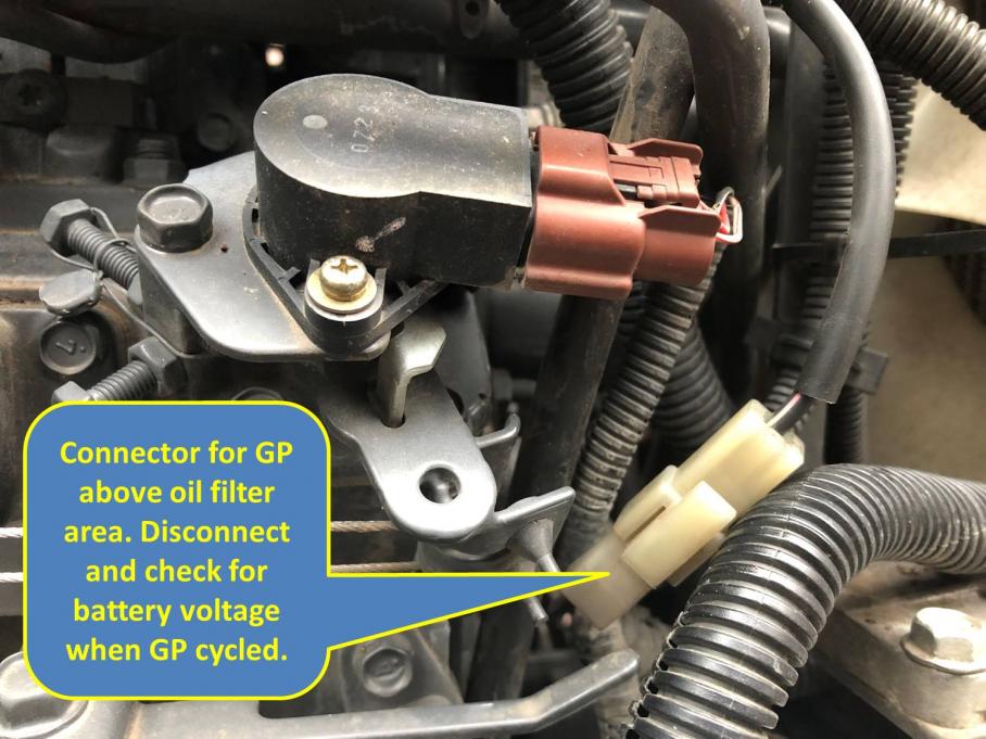

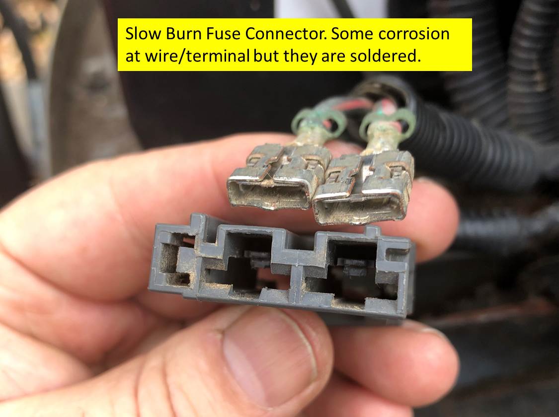

Verified battery voltage present at the glow plug buss bar. There is a white connector above the fuel filter that can be removed to easily check supply voltage on this model.

Decided to start at the battery and disassemble and clean every wire termination to bare metal within the GP circuit. After completing each section a start attempt was made. Note: Dielectric grease was used after cleaning each connection.
It is not sufficient to only clean the battery terminal and wire, but the assembly that makes up the High Current Fuses. (see photos)

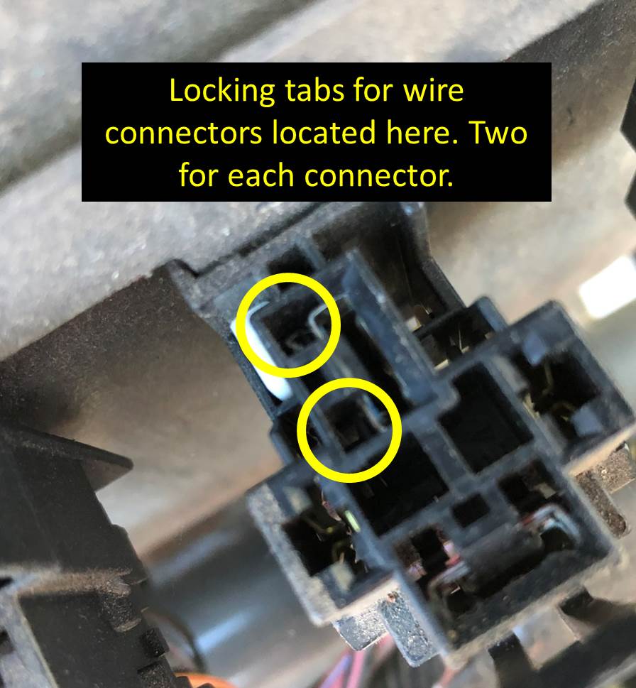

First off the relay socket needs to be removed from the mounting detail. This was accomplished by inserting a 0.010" feeler gauge between the metal and plastic. Jiggle from side to side while push down and it will eventually release the relay socket.
The relay insertion and extraction feels like there is good terminal grip, so I used 1/4" male connectors to test each female connector independently within the relay socket. The two pins for the control side (Low current small diameter wire) are tight with good friction. The power side is loose and the 1/4" male tab just slips right in. WOW this could be the problem.
To remove the female wire terminals from within the housing requires the housing to be disassembled. Start by removing the white plastic wire holder by gently prying on the tabs while pushing downward. Then two small screwdrivers (kind use for eyeglasses) can be used to unclip the female terminal from the black housing.

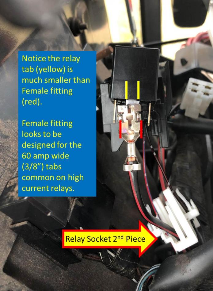

The power side female terminals are designed for 3/8" male tabs. When the relay tab is inserted there is no appreciable amount of grip. It is as if the spring detail within the female tab is fatigued. Tried bending, but it will not hold its position once the male tab is inserted.
Higher current relays (60 amps and above) can be purchased with power side tabs that are 3/8" wide. More importantly these are 50% thicker than the 1/4" male tabs on found on the stock 40 amp relay. (0.045" vs 0.030").

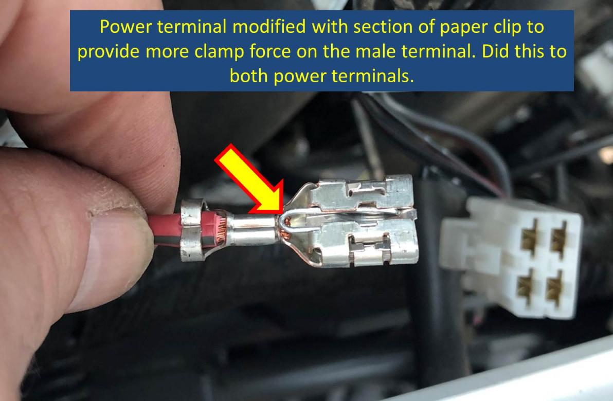

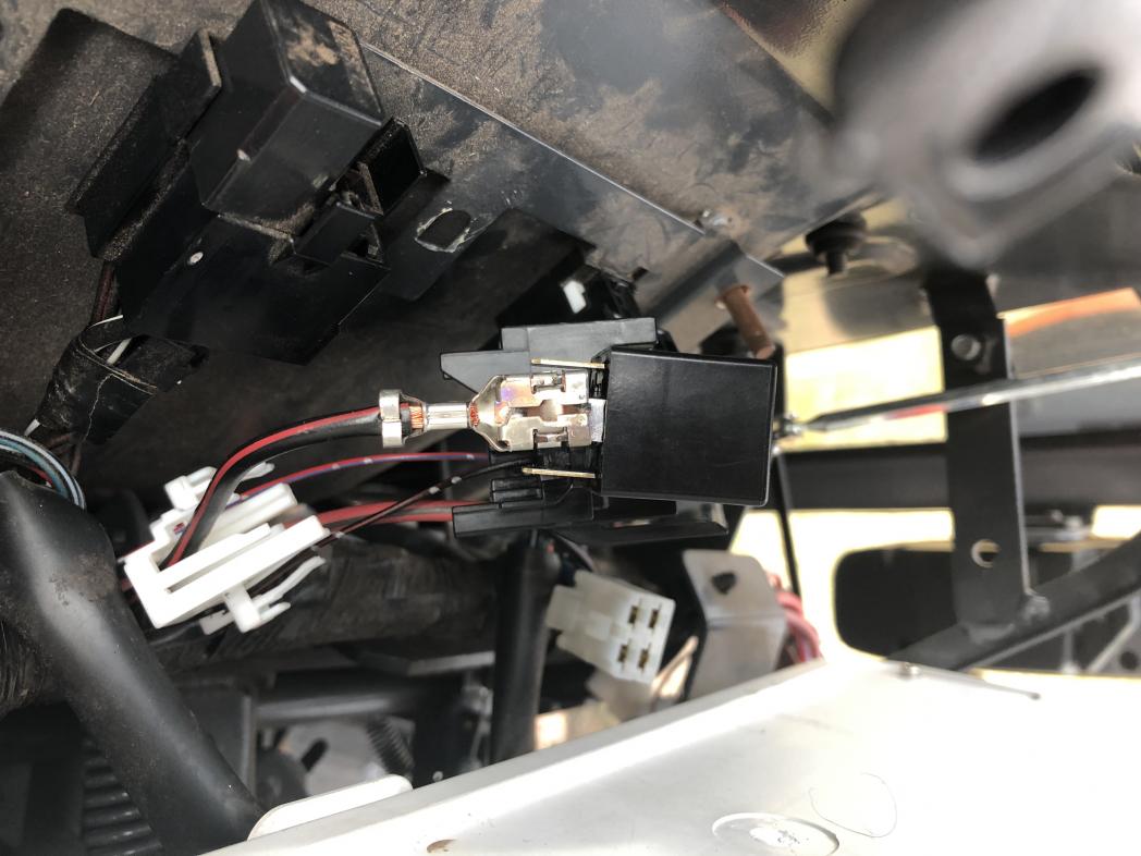

Not having one of these relays available and having to travel for work while others needed the tractor, the female terminal was modified using a standard size paper clip.
The paper clip was cut and bent into a simple u-shape and inserted into the wire terminal as shown in the photo. It is not ideal, but works in providing the proper tension to carry the current.
Once modified and reassembled the tractor starts very quickly (less than two revolutions of the motor). So quickly is all I want to do is start it and be amazed at how quickly it now starts.

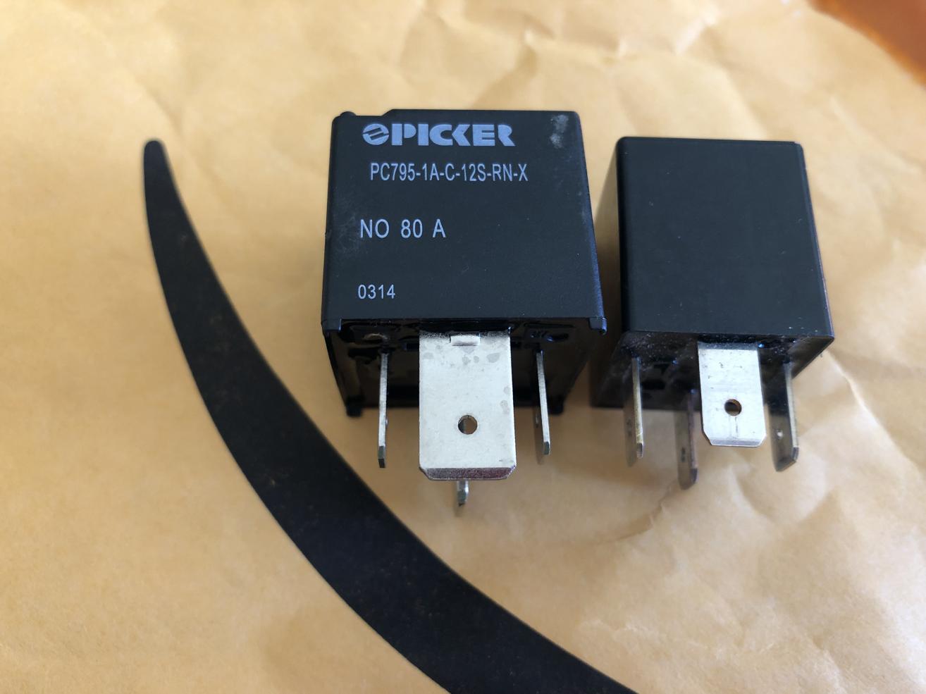

Purchased two new 80 amp relays with the larger 3/8" tabs for the power side of the relay. 80 amps is overkill, but that is what I bought off amazon. Picker PC795-1A-C-12S-RN-X at $18.99 for the pair. They are sealed units, with nickel plated tabs and a resistor to protect the voltage spike that occurs when the field collapses. The new relay has two-1/4" and two-3/8" tabs that measure 0.368" wide and 0.045 thick. Note: Measurements taken with Starrett dial calipers. Here's a link to the relays if anyone is interested.
https://www.amazon.com/gp/product/B07GX6SXY2/ref=ox_sc_act_title_1?smid=A16HAOC7J321VG&psc=1
The thicker tabs should work significantly better with the mating female electrical connectors as they are designed for the wider male tabs.
The same relay and mating socket are used for another circuit that I believe controls circuits that can prevent the tractor from starting so plan on using one of the relays in this circuit even though it is not causing any issues at this point. (My tractor would not start with the relay missing)
The larger plastic housing of the 80 amp relay does NOT create a fit issue. There is plenty of room to accommodate the relay.
