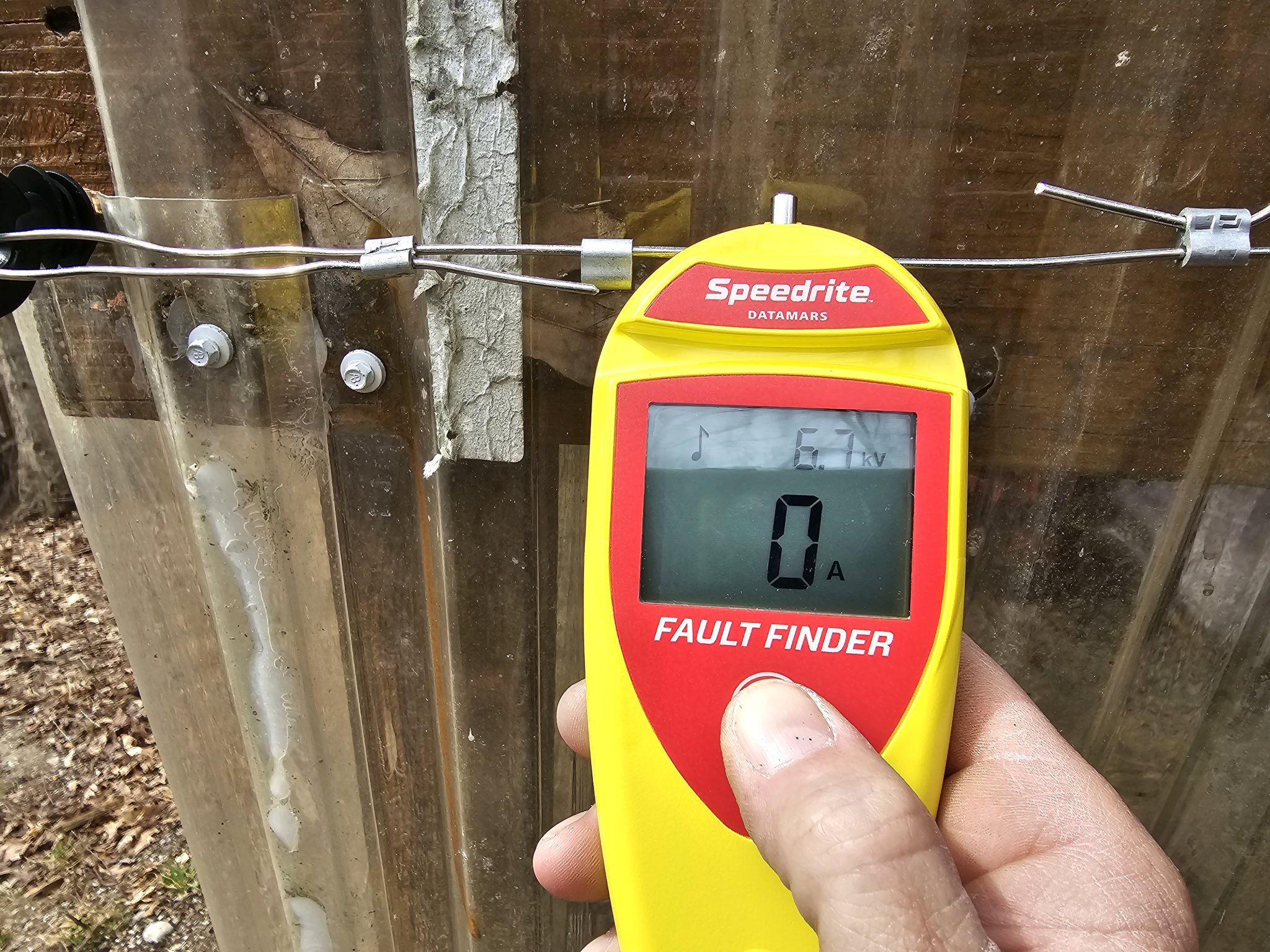

I finally got my charger and fencing hooked up.
The parmak 12 magnum says it puts out 11,000 volts.
I also bought a fence tester.
It shows 6,800 volts.
I emailed the company with prior questions and the guy responded quickly. Today I emailed him about the volts not being close to 11,000
Is it the fencer or something I've done wrong but haven't heard back from him yet.

I spoke the the fencer company again. The service manager I think. He wasn't thrilled I was questioning the strength of the fencer when my tester only shows half strength.
He basically said my $140. Tester was junk. You need a tester that has a ground probe to get a accurate measurement.
A man of very few words..yes.. no..OK
Was the answers.
The strength when it leaves the factory is 'close' to the spec voltage listed.
But I'll try a ground probe tester and see what that reads. 20230412_173146.jpg
Was the answers.
You made a nice job of the wiring!
Effective grounding is absolutely crucial.
Both my hand-held testers (different brands, one looks very similar to yours) usually shows a HIGHER voltage than the reading on the energiser display. I queried the energiser company about this and they said it was something to do with stored energy in the system, my fence is about 3km of 2 or 3 wire.
You 6.8kV seems pretty good to me, should be thought-provoking for whatever touches it. You might want to test the voltage between the live conductor and whatever else the animal would be standing on at the same time. That's the voltage the animal would be exposed to. If they are standing on the ground then ground is your earth. But if they are standing on something like wood, then that's your earth and it might be less.
6.8kV should give anyone a thrill even if they are standing on dry timber.

re: He basically said my $140. Tester was junk. You need a tester that has a ground probe to get a accurate measurement.
TRUE !!
there's no accurate way to read a voltage without a GROUND wire. I downloaded the manual ,though no info on how they get the voltage 'out of the air'.....
you could spend 50 cents and make any DMM or DVM to read the actual fence voltage.
also understand that the strength of the zap depends on the conductivity of the soil. All that stone and slope means very little moisture in the 'soil' so not much 'zap'.
Using a shunt? (I've limited knowledge!) Also I was told that the energy (kJ)was just as or more important than the kV. Is that true?

Ran my ground wire today. A customer who's a farmer happened to stop when I was just getting ready to do my ground wire run.
He said my wiring looked fine. But the coon would not have been grounded. So I run the ground wire snaking it 2" off the deck end and 3" below the hot wire. Up 6" and across below another hot wire. The farmer took a thick blade of grass and wet it in his mouth and kept touching it to the hot wire. He said I have on thick boots standing on pea stone so I'm not grounded good.
Once I got the ground wire done. I used my tester to check from hot wire to ground the tester showed 9.2 kv or 9200 volts...I'm pleased with that. It should cook anything small.
