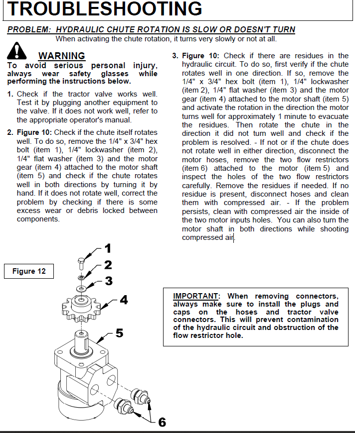

I have the LX2980 snowblower for my LX2610 and found this in the Troubleshooting section-

I just installed my new BX5455hd snowblower and when I tried the hydraulic operated chute it was slow and stopped turning in one direction. I adjusted the “flow” on the 2 adjusters on the bottom of the motor…the adjustments were backed out a good deal…after turning the adjusters back in and tightening the lock nuts it operated much better and faster.

I do
I do not believe mine has thoses, I just have one like the photo above LX2980 snowmblower. Still away, probably wont be home till monday .
On that “picture” parts numbered “6” are the flow adjusters are they not? That’s what mine look like. Those are the flow restrictors…unscrew the locknut and screw in the Allen screw in the middle until the flow is adequate and the chute turns like it’s supposed to.
From my glance at them. They just looked like a fitting that screws in to the pump/ cylinder.

So…did you increase the flow while you were fiddling with the flow restrictors?
What kind of “material” was in them???🧐
The flow stayed the same, as mine are not adjustable. Just some metal shavings. I am gonna take apart the pump or cylinder to see if there was somehow any real damage. [although with the flow.... if fluid is going in... not sure why it wouldnt move the shavings to the other side... and then cause that side to not move, but they both would get stuck. So not sure, I aint complaining it is working though. lol
