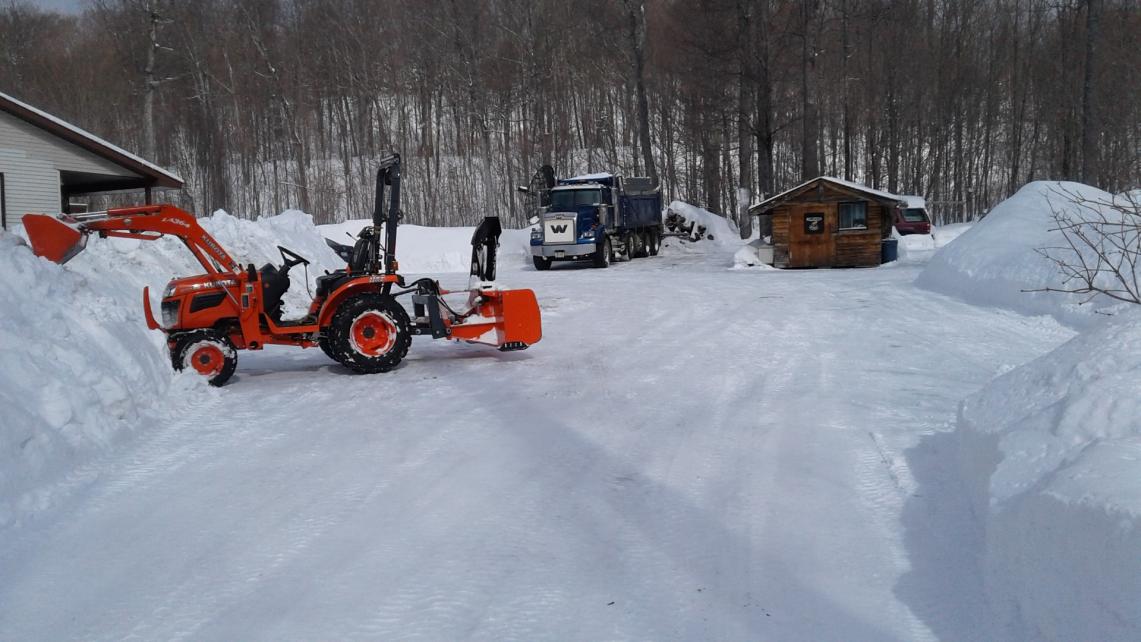

Call me insane then. I have a B7200 with FEL and this summer I am going to be rebuilding a B2660 blower for the front of my tractor. Having lived in the U.P. of Michigan all my life, I've ended up using just about every form of snow removal equipment known to man at least once. And in my opinion, a front mount blower with rear blade is preferable to a FEL and rear blower. You really don't need a FEL at all if you have a front blower. Even with the heavy stuff that the plows pile in front of your driveway. Every now and then you might need to replace a shear pin. But as long as you plan for that and stock a couple of extras, the occasional irritation of swapping one out is easily compensated for with the ease of blowing that the front mount provides, IMO.

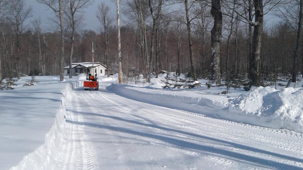

OK, I have a B3000 with a Meteor drag snowblower. Made in Canada, three point hitch, but it faces forward, so you just drive along through the snow. This allows the loader on front to be used as needed. I have turf tires and ice pick chains. I also have the cab model, so I stay warm and dry while I watch in my mirrors as the snow blasts out of the chute. There is a remote control to rotate the chute, too. I find it a very nice set-up.

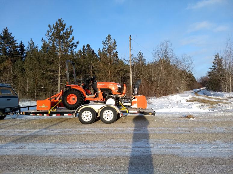

My B2650 has the front mount 2782B 63" blower, and a 60" box scraper on the 3-point. The scraper is very capable at moving snow and scraping ice, and adds some balance weight for rear tire traction. Not a setup for moving firewood around, but I've got that all done in the fall before the snow hits anyway.
Same deal here - all three B-series tractors have rear blades - two of them are box scrapers, one is a very ugly home-made straight blade. The weight is nice to balance the front-mounted blowers, plus it's great to be able to back up to a garage or hangar door and pull the snow away. This winter the blades have been getting a real workout dealing with all the accumulated ice.
