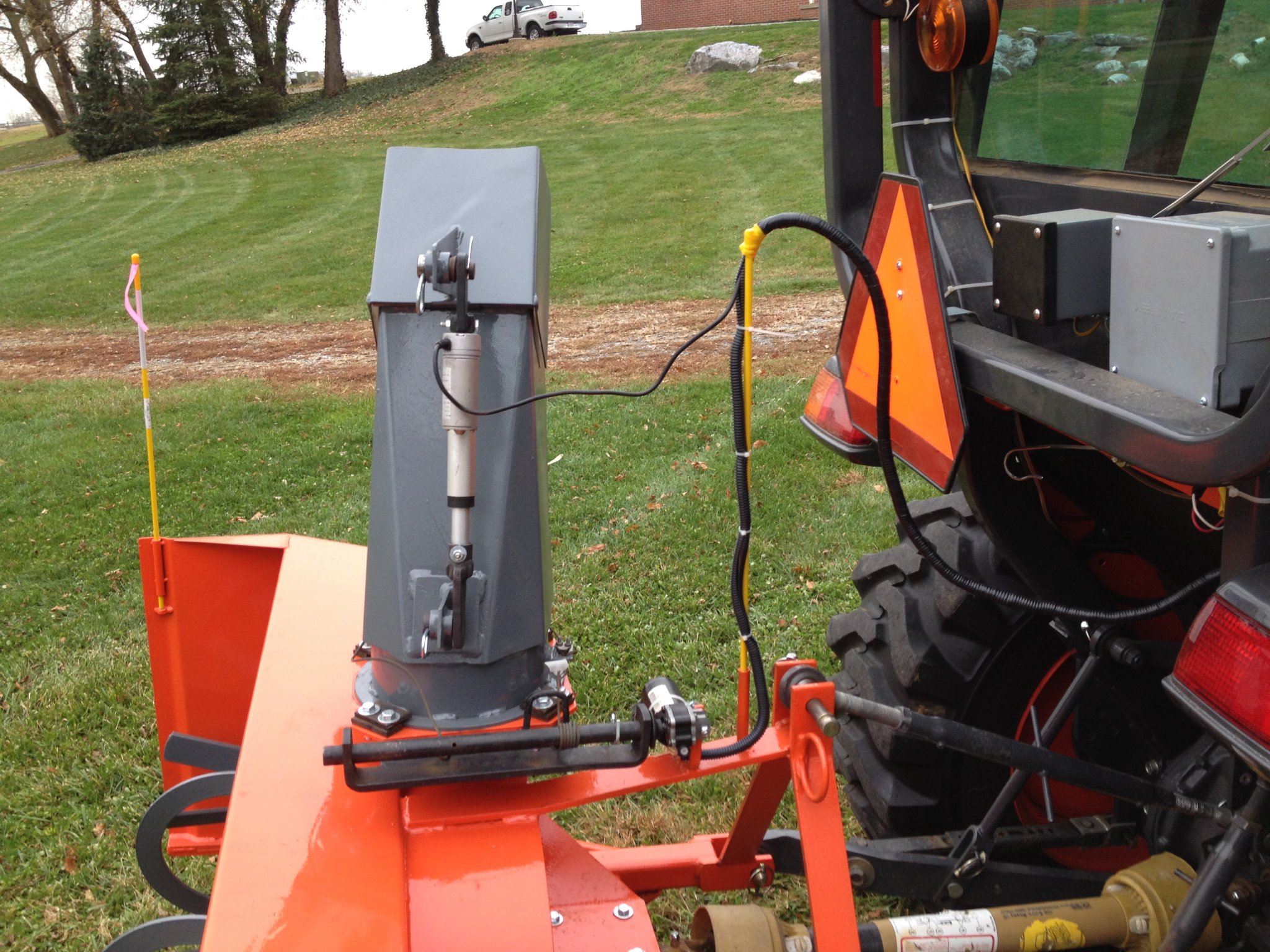

Im also working on this project with my Pronovost (Hardy) blower. Today I got the chute pitch and rotation mounted up. Tomorrow will do wiring.
My plan is to use a sealed box with momentary switches, and put magnets on it to grab the rops and allow for easy removal.

Ok got this wrapped up today.
I installed two DPDT switches into a double gang sealed box with glands for the wires. I attached 4 rubberized magnets to the box to hold it to the rops and allow for easy removal when not in use. The box is powered with a cigarette lighter plug that plugs into the 12 volt power port on the fender.
Rotation: I cut the hand crank, and we discovered it was just a 1" pipe. My dad being a much more capable machinist than I, made a bushing on his lathe to adapt the inside of the pipe to the motor shaft. Lucked out and the motor shaft lined up well on the existing bracket, was able to get two bolts through and notched the third to hold it. The gear and rotation on this Pronovost unit are super crude, but the motor turns it with ease. I cut off the chute rotation stop limit, and cut in additional gear teeth on its ring where the stop was previously. This will allow the motor to overrun and not hit a hard stop if needed, or blast me in the face with snow.
Pitch: I was going to simply weld tabs onto the existing crude manual track and install the 6" linear actuator on it. I was informed by the machinist review committee this wasnt a clean enough solution. My dad made more bushings on his lathe and the actuator mounts to those with a through bolt and fender washers. Unfortunately, I did not get to use my welder and gob up metal parts like a savage.
Now that this is done, there shouldn't be any further snow storms.
The motor was from Surplus Center is 100 rpm "RA-AFSL-30AN-35" Allied Motion: Motor link
The liner actuator also from SC is 6" stroke 225lbs Link
All in, about $250. The kits from Pronovost, not even joking, were $1200, in either hydraulic or electric.
