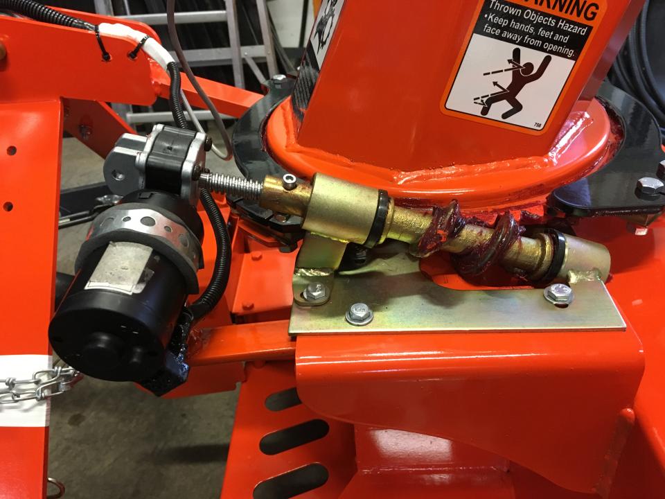

Dan - would you mind giving some detail on how you connected the seat actuator motor to the chute rotator, please? I have a pair of seat motors sitting in the shop and they seem plenty strong enough for the task - they look pretty much identical to the one shown in your photos. I'm just a bit buffaloed about how to connect the output of the seat motor to the input of the chute rotator worm gear.
Also - but guesstimate, how long would it take to rotate from full lock in one direction to full lock in the other?
Thanks for any details you might be able to provide.
DanR
Apr 26, 2018
26
Moncton, NB, Canada
If you look at the 2nd pic, I just drilled a hole through that spiral shaft big enough for a small bolt. That’s how the factory manual crank hooks up too. The shaft is s/s so I couldn’t weld on it or I might’ve done something different.
Full rotation one way is 10s. Real world you’re only gonna swing one way at a time and probably not full lock. So usually I’m 5 seconds or so to be where I want.

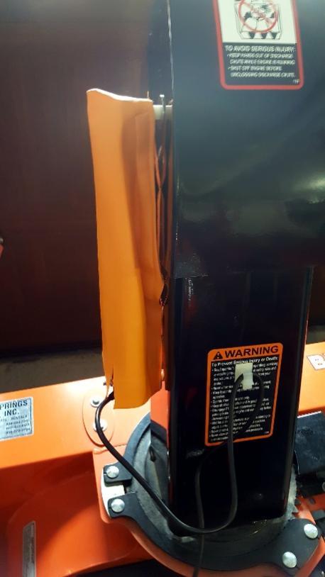

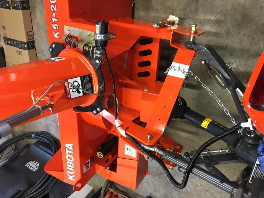

The deed is done. We've been relatively snow-less for a spell...that will change this weekend apparently, so I sort of dragged this on for a while. But it works, and doesn't look like a cob job.
Can't post vid it seems.

Looks like a good install. One thing you may consider is flipping the actuator so shaft is down. Water will get in or get a boot to keep it dry.

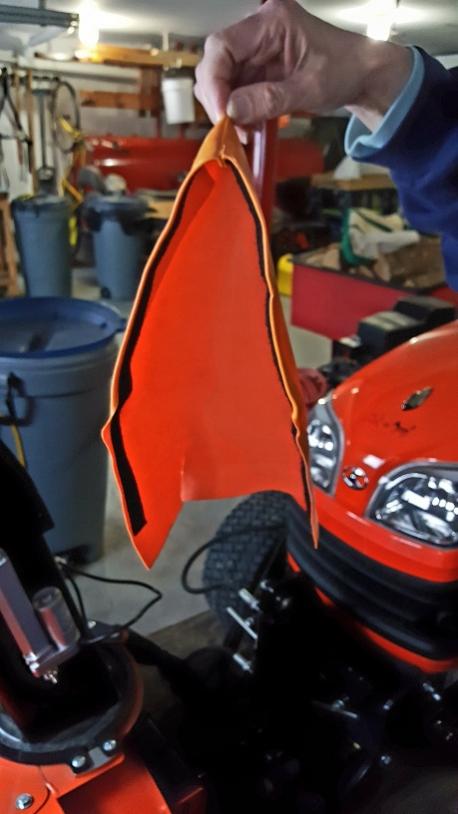

I know folks have expressed concern about water intrusion. My wife's fabric collection includes a piece of ballistic nylon. She's going make a "sock" out of it that will fit over the top. It will have a velcro strip along along the chute side so I can simply close it around the actuator. This should keep the elements out and won't upset my sense of the "universe". Weird huh? Plus it will hide everything, another useless aspect I suppose.
Thanks again to all who tuned in.

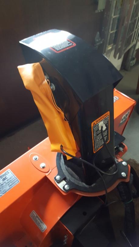

***************UPDATE****************
Trial by fire, or snow as it was. Solid 12 inches, actuator worked fanatastic. What a pleasure not having snow blown in my face. I was able to place the discharge exactly where I wanted it to go. In fact, I could get right up along side the vehicles and firewood and with the deflector angled just about straight up blow the snow up and over! Money well spent.
The snow was powder, not wet at all, so later in the season another test. But nothing got loose or broke. Snow did stick to the actuator, so I will definitely get after the Mrs. to whip up a cover. We ditched the nylon after she found some heavy vinyl, which is orange...perfect. I will stick a picture in here when it is done.

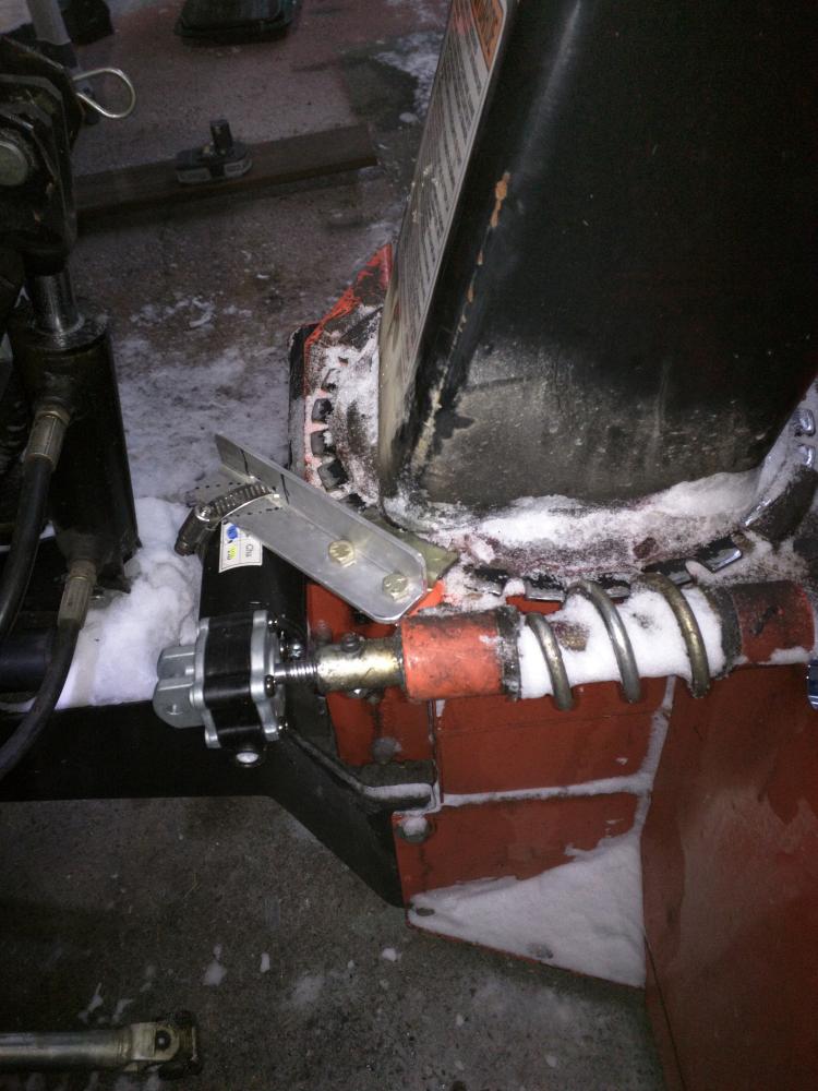

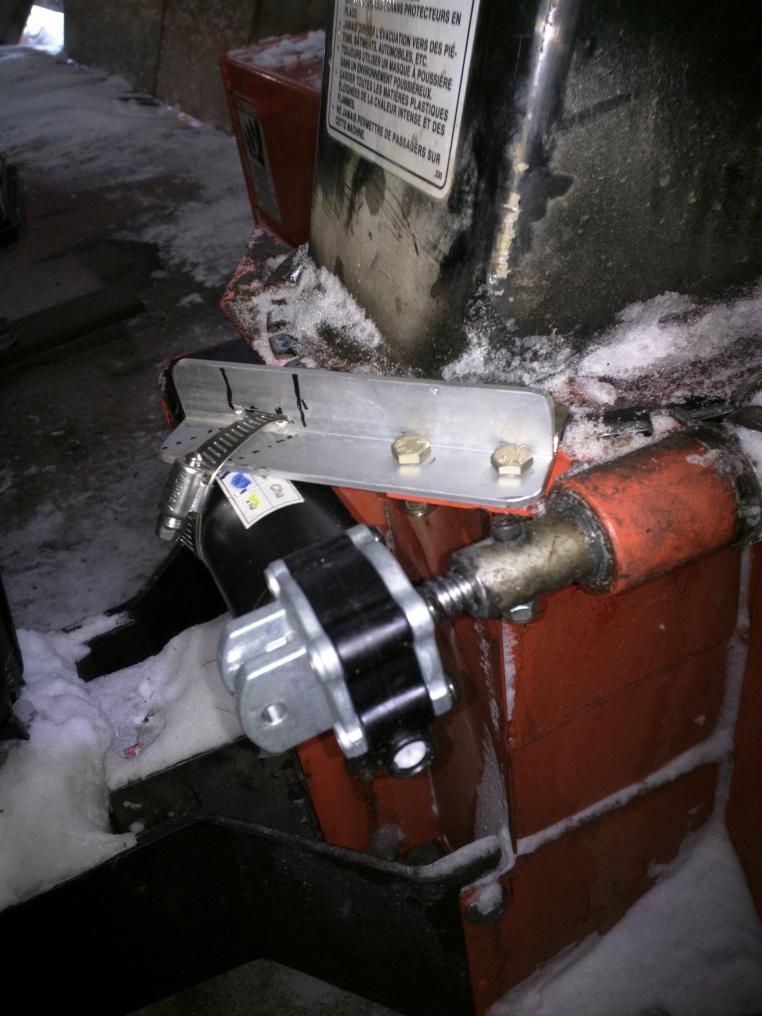

As a follow-up to this conversation I'll mention that last night I got to try out my modified B2550 front mounted blower for the first time. Two hours of heavy work, often with banks the full height of, or higher than the blower.
The linear actuator to control discharge chute elevation works ok. Just ok. This is as a result of the metal of the discharge chute being of fairly light gauge. I believe I will have to re-install it at a later date with much better bracketry that will substantially reinforce the chute and the actuator attachment points.
As for the power seat motor as a chute rotator, I owe DanR a debt of gratitude for the technical info he shared. This thing works beautifully. To rotate the chute from stop to stop requires 11 seconds. I thought this would be too slow. Nope, turns out that it's just about perfect.
The work I was doing last night had me battling a strong wind, blowing the area in front of our hangars - that area is about 100 yards long and about 20 yards wide. With the wind last night, I had to blow only moving westward and vary the chute direction depending on the wind which was shifting through about 30 degrees from the east to south-east. This had me moving the chute almost constantly. I could not be happier with the way the rotation worked.
I've mounted the switches for chute control just beside the 4wd control on the right fender. Excellent position as my hand naturally rests nearby on the 3pt hitch control because I use a rear scraper blade to try to get down through some of the ice that has built up through our multiple freeze/thaw cycles.
I've wired both actuators to a 4-pin circular metal round trailer connector with the connector mounted to a bracket attached to one of the unused frame mounting holes just under the front right corner of the tractor. Works a charm.
Again, many thanks to DanR for pointing me in the right direction on the power seat motor.

I was concerned that my setup would be kind of wonky the way it is attached to the chute. I even read posts online about leaving everything a bit loose so that the actuator could move without binding. So, I went with the fender washers on both sides of the steel to provide support and spread the stress. And, the nylocks are snugged fairly tight. The nylon spacers allow proper movement. Nothing wobbles at all...several hours of snowblowing on it now. We're on the second version of the cover. The material is a pvc covered fabric similar to what's used on rain gear. This does keep snow and slush and muck off the entire actuator...just needed some fine tuning.
