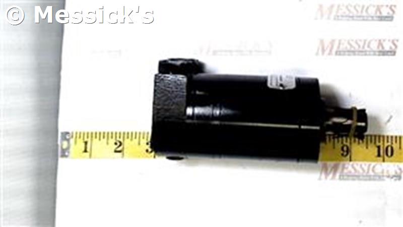

Hello,
Has anyone ever installed a Kubota snowblower chute rotation kit (kit model #B2784A) on their snowblower? I am specifically looking to get information and some photos of what the hydraulic motor portion of this kit looks like.
The model number of just the hydraulic motor from this kit is # 77700-01654.
I greatly appreciate any and all photos of what this setup looks like.
Andrew

Just a motor and gear that bolt to the housing.

Hey Dan,
Thanks for the images. For the life of me i can't figure out the GPM rating on that pump for this kit; i even called the dealership to see if they can look it up, no luck.
if anyone out there knows the GPM for this pump i would love to know.

Its used on tractors with maximum flows in the 4-6 GPM range so that should be a clue. I suspect a couple gallon a minute is adequate for the snow blower application. Here is something similar:

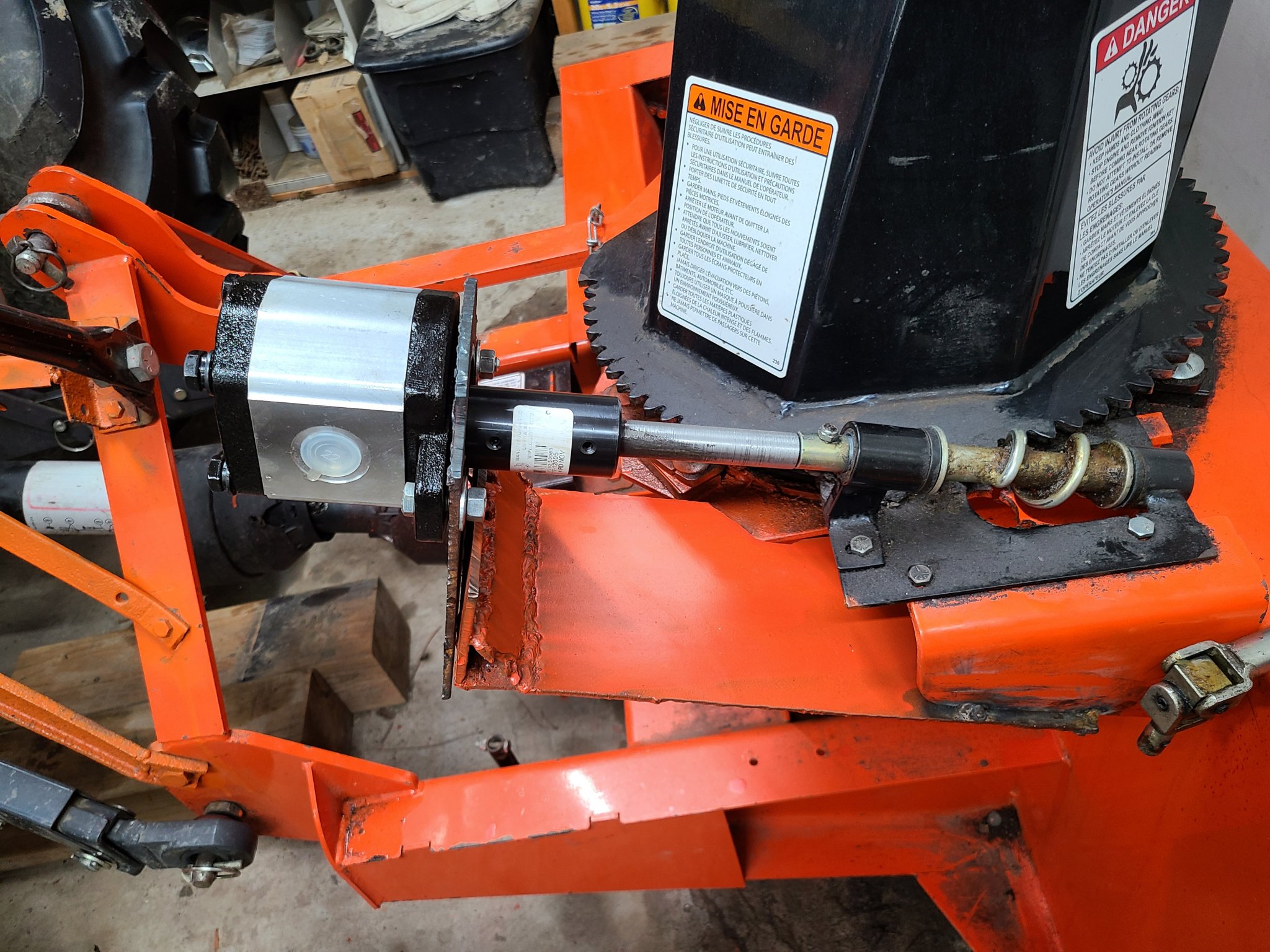

I just finished my own chute rotation conversion and deflector conversion. It was too intimating for me as a hydraulic dummy to use that. I opted for electric conversion - motor for the chute, actuator for the deflector. Fun project, easy to do, best of all it works!
I would love to see some photos of your set up if you are able to share.
I am also a hydraulic dummy, so i have my fingers crossed that this new set up works; at the very least i hope the relief valve prevents the motor from blowing like the others if it decides not to work.
Also, if this 3rd motor set up doesn't work i am going to change my full design to a hydraulic piston for the rotation. Forget this nonsense! lol

Take a look at these 2 short videos. If you have any questions PM me, I'd be happy to help.
