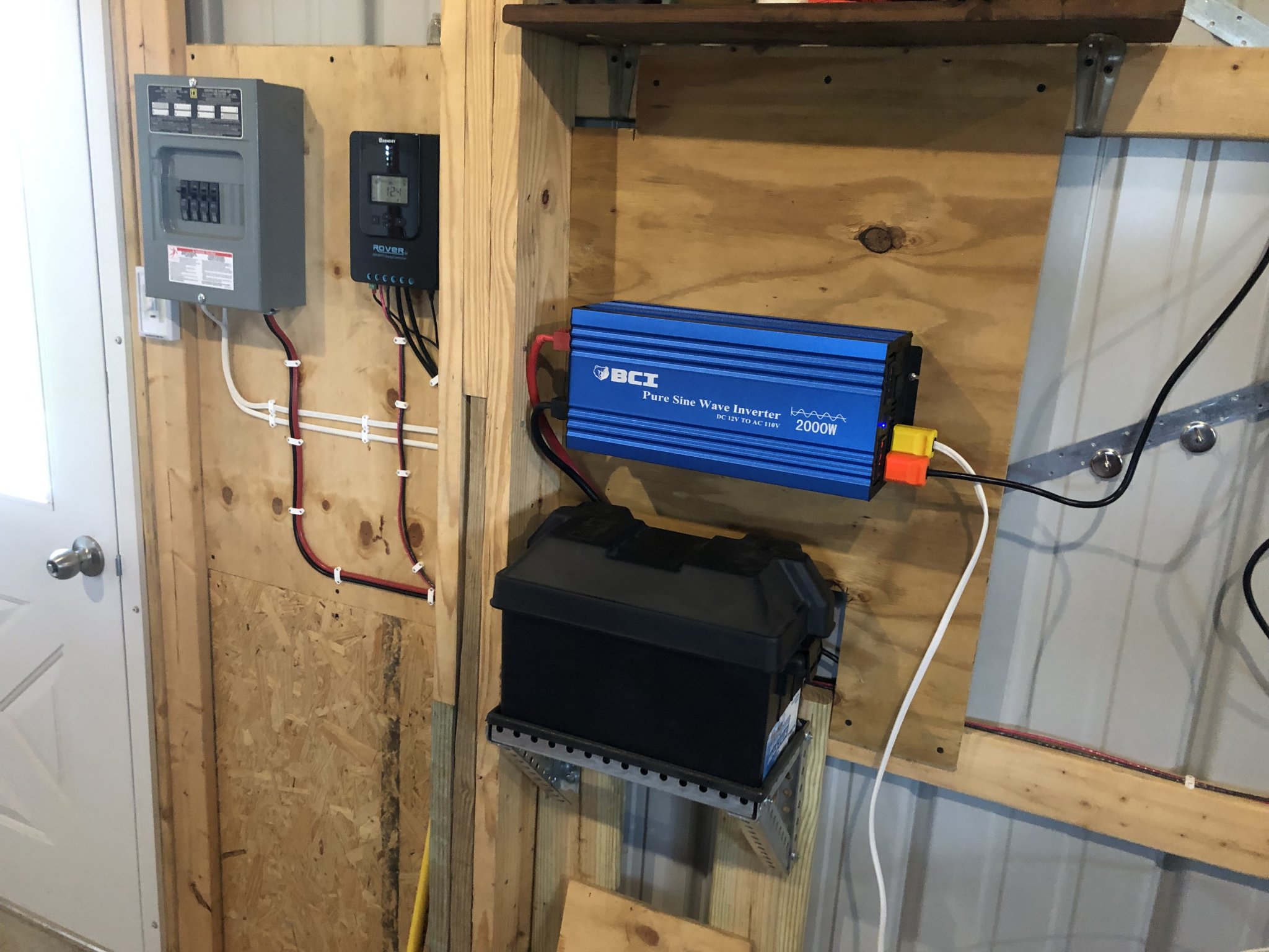

An inverter would also be way easier to carry with you than a generator. Cheap inverters are like cheap generators, they’re advertised by their peak wattage and not their running wattage. I suggest spending a little more and getting a pure sine wave inverter. They put out cleaner power in case you decide to run any sensitive electronics some day. I use an inverter in my barn hooked to my solar setup. It puts out 2000W running and 4000W peak 4908B802-98D7-46D6-AD2D-C1AB74A34926.jpeg
