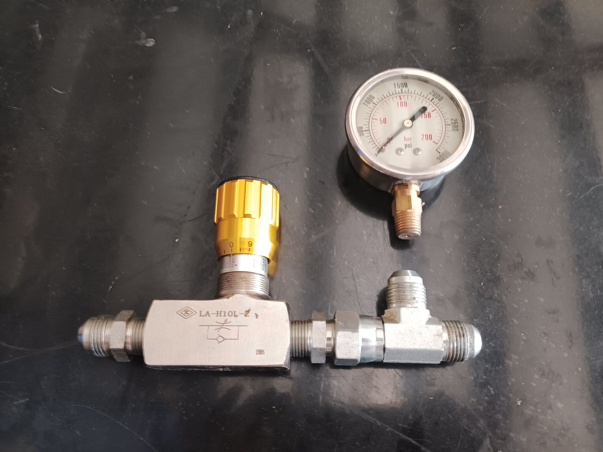

Same setup as you had on the inlet but put a valve between the tee and the port. See pucture below.
Open the valve, start the tractor, snd observe pressure as you gradually close the valve. If the pump is working you will get to 2500 PSI before the valve is fully closed.
I just picked up a valve and fittings to test my pump. Do I only check pump psi at idle, or do I need to check at max rpm as well?
Both. It will give you an indication of how much slip the pump is exhibiting.
Whoops - this is direct pump test so just full speed
