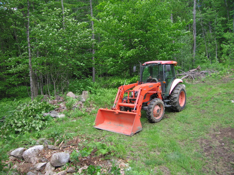

That's why I installed mine like this, I do need to use a dropped ball hitch to avoid grounding out the rear of the trailer
I see your fenders are turning Mary Kay pink, just like mine did. What is interesting is, some of the parts bleach out, some don't. My fender are sad but my roof, which is plastic is fine. The hood which is metal bleached but the side panels didn't.

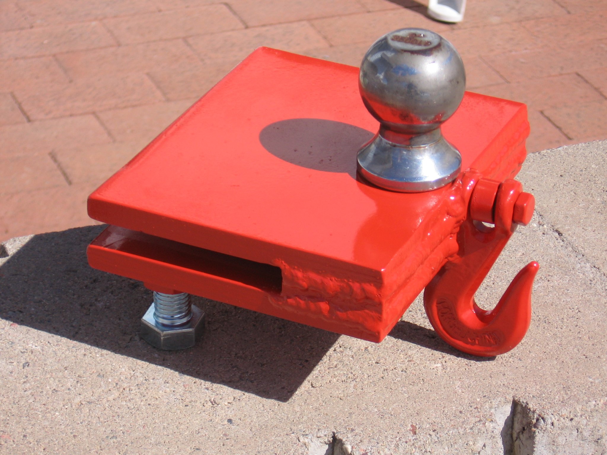

I took my Milwaukee magnetic drill and an annular cutter and bored a hole in the floor of my bucket that accepts a 2 5/16" ball shank. If the ball isn't in there, the hay spear is and it too bolts to the hole. But then I have an extra bucket with no holes in it.
Yes, just the fenders pinked out, the rest of the machine is still orange

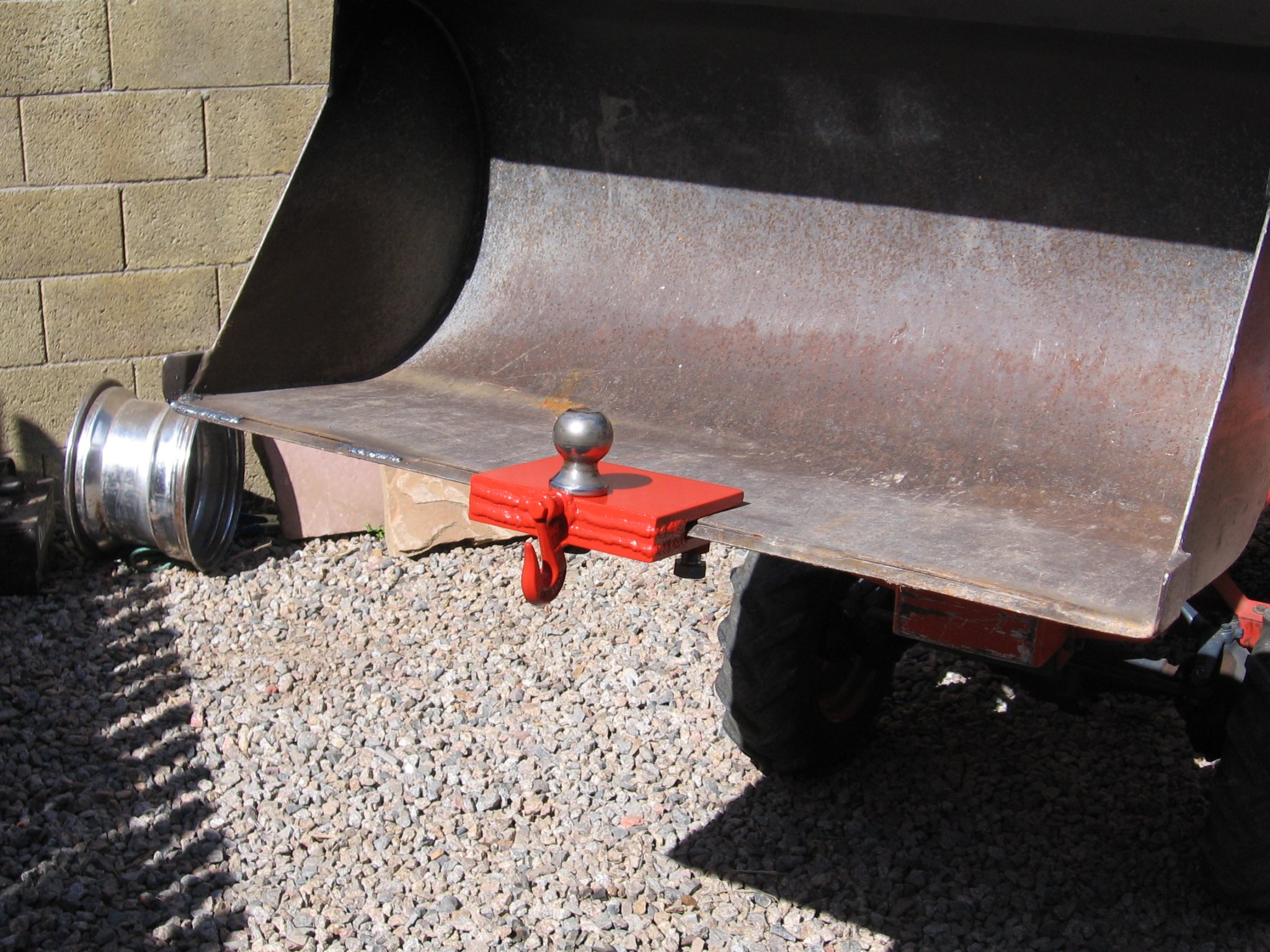

Perhaps someone offers a set up that mounts right at the loader arms instead of at the far end of the forks.
Like this?
(not quite on the pins, but right on the SSQA)
7,658
2,762
Nice idea but it's also a good way to bow the bucket!
Hasn't in 8 years.
I"m moving empty utility and garden trailers, not lifting the Queen Mary.
Did you note the factory cutting edge? Probably 1/2" x 3".

I agree with the point that you are making, in that the hitch ball out front makes it easier to "spot" the trailer. The problem first discussed was the reduction in capacity that far away from the loader arms. Perhaps someone offers a set up that mounts right at the loader arms instead of at the far end of the forks.
I remove my forks and use only it’s back/rack to which I’ve welded a receiver for a 2” ball-hitch. Although I still have the 3-pt hitch I’d made for my little Ford 9N... I never use it because it’s too much trouble to use and I don’t want to hassle with whatever I already have mounted back there.

Just remembered the first one of these I built for my buddies' Ford (9n or 8n, can't remember) and it hasn't bent the bucket either.
