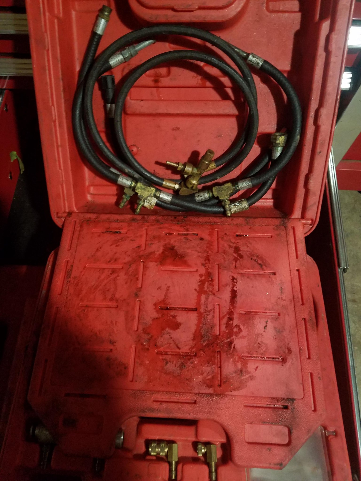

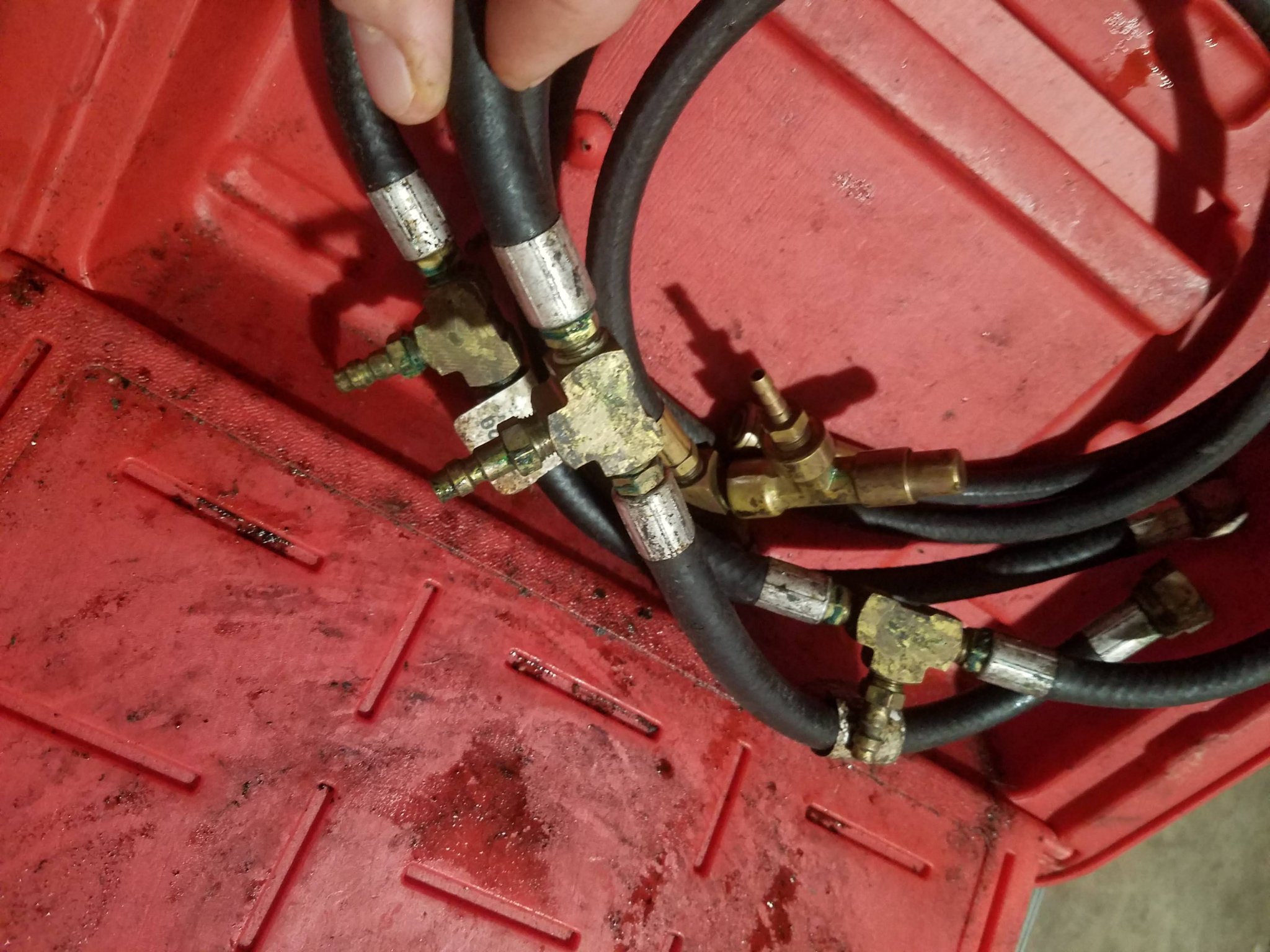

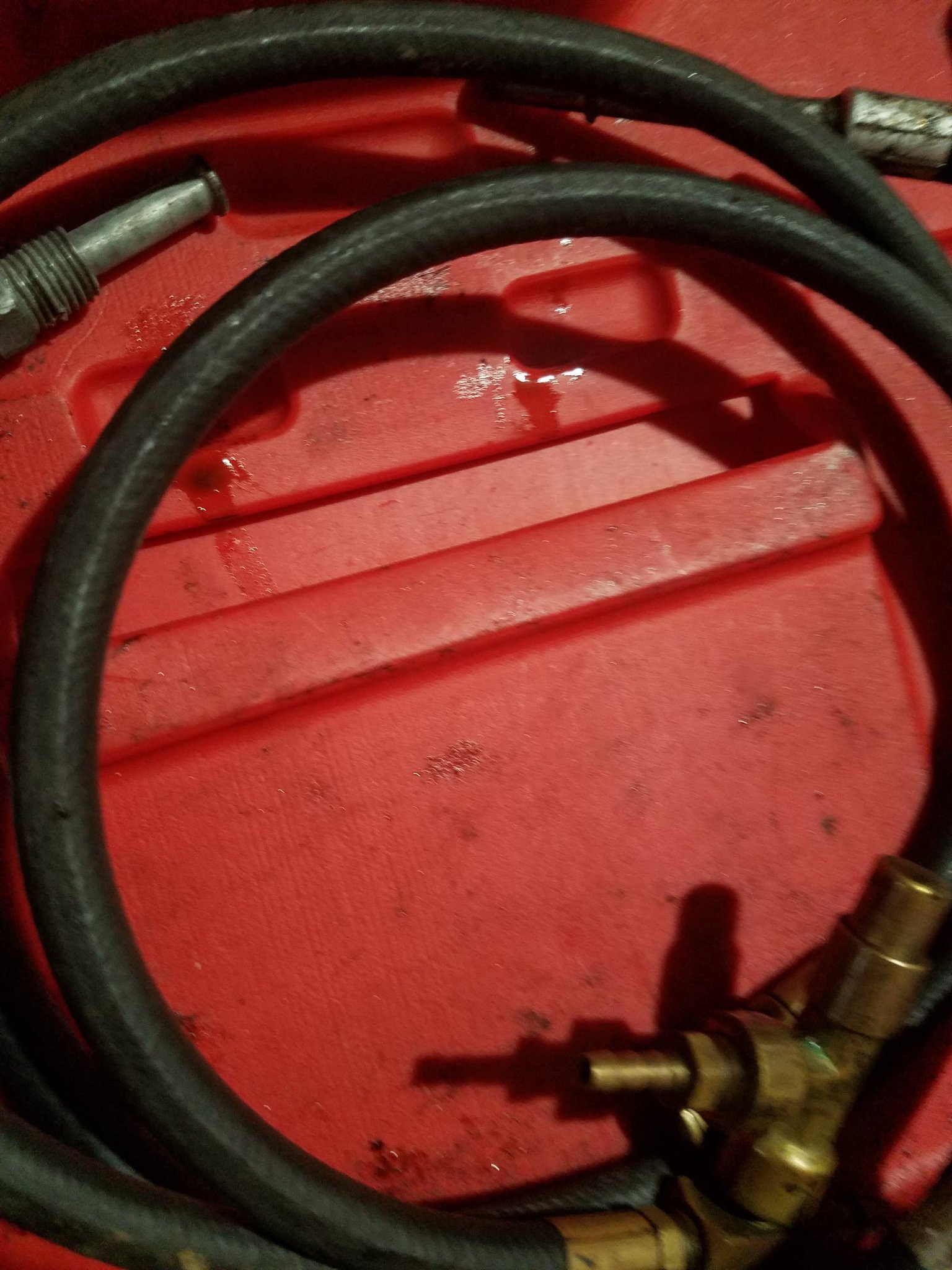

Base upon several atv's/mowers in the 80's-90"s the dealer service departments recommended ethanol free.
If something is sitting for long periods of time, ethanol can surely create problems for you. Otherwise, if it runs or moves frequently, you're generally ok.
This is my one of my fuel pressure kits which I've owned for about 13 years.
All the discoloration you see and wetness is dried ethanol. Turns kind of a blueish color over time.
It is unbelievably sticky to. Imagine what that does to a fuel system when sitting for long periods of time. definitely no bueno!

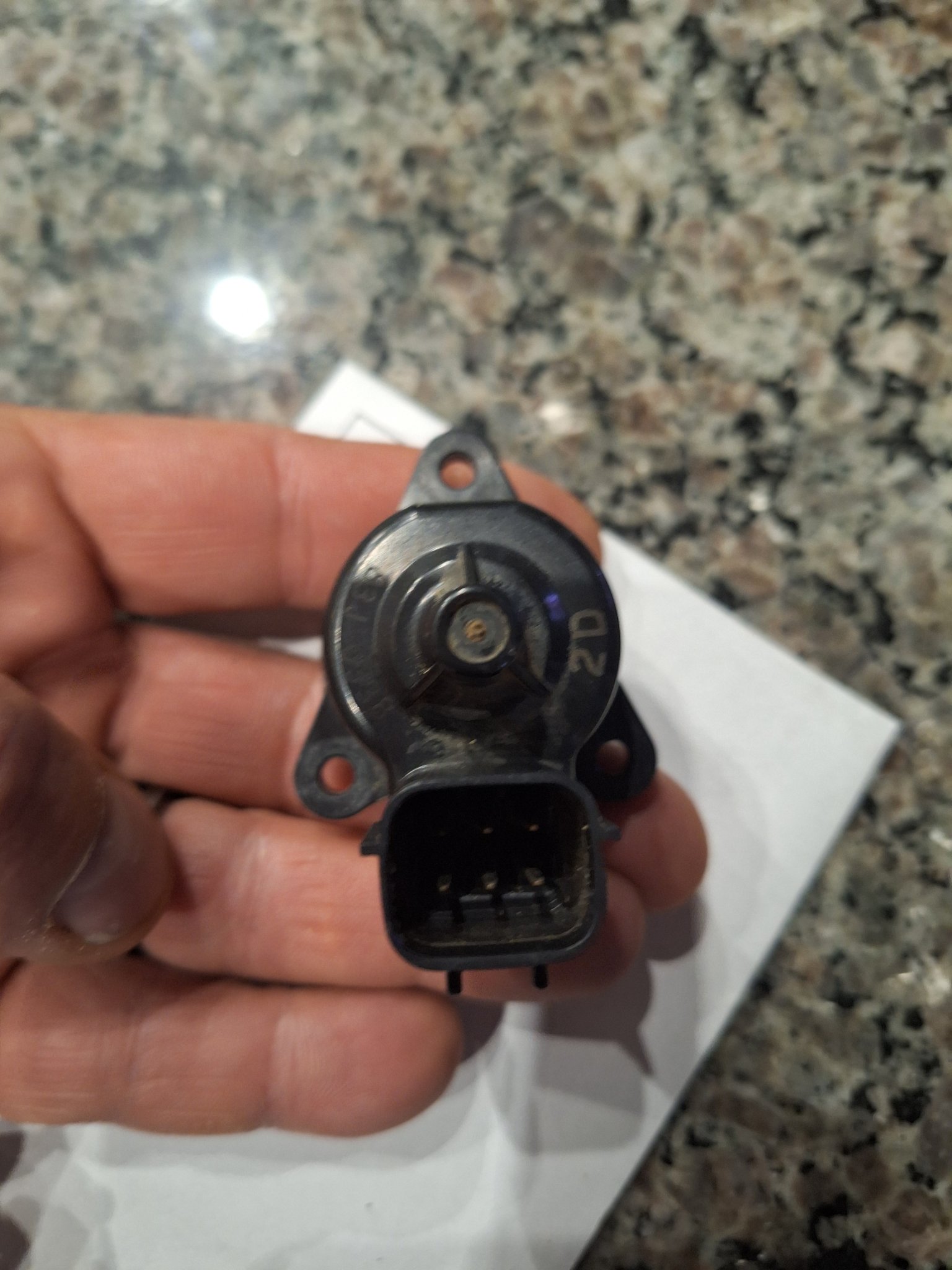

Recently, I experienced a similar situation as others with their xg850 (2018-2020). The RTV would start rough then die and not start again. On inspection I found fuel in the crankcase. The fuel pump was pumping fine. I ordered the super expensive, proprietary plugs at $25 each plus shipping. Bought the $50 fuel filter and performed an oil change and the same issues were present. On further inspection I found a soleniod on the Mikuni air throttle body that was hot to the touch without the engine running.
I called my Kubota dealership and they will not sell the individual solenoid. Only the complete throttle body at$638.00.
This unit only has a 148 hours on it and it was not useable.
At this point I tried to get the part through Mikuni with no luck. I ended up buying a knock off throttle body off ebay that was as close as I could find to the one on our kubota. It ended up being for a polaris 800. left the original throttle body in place and swapped out the solenoid that was hot and guess what...it's fixed with a $45 polaris throttle body solenoid off ebay.
Post some details like solenoid part numbers or year and model of polaris to cross reference

Couldn't locate this part number anywhere so I went with this as it had a three pin connector. replacement plugged right in. This is the part information on ebay. 1204195 Throttle Body for Polaris Ranger 800 XP Crew 4x4 6X6 2011 2012 2013-2016
