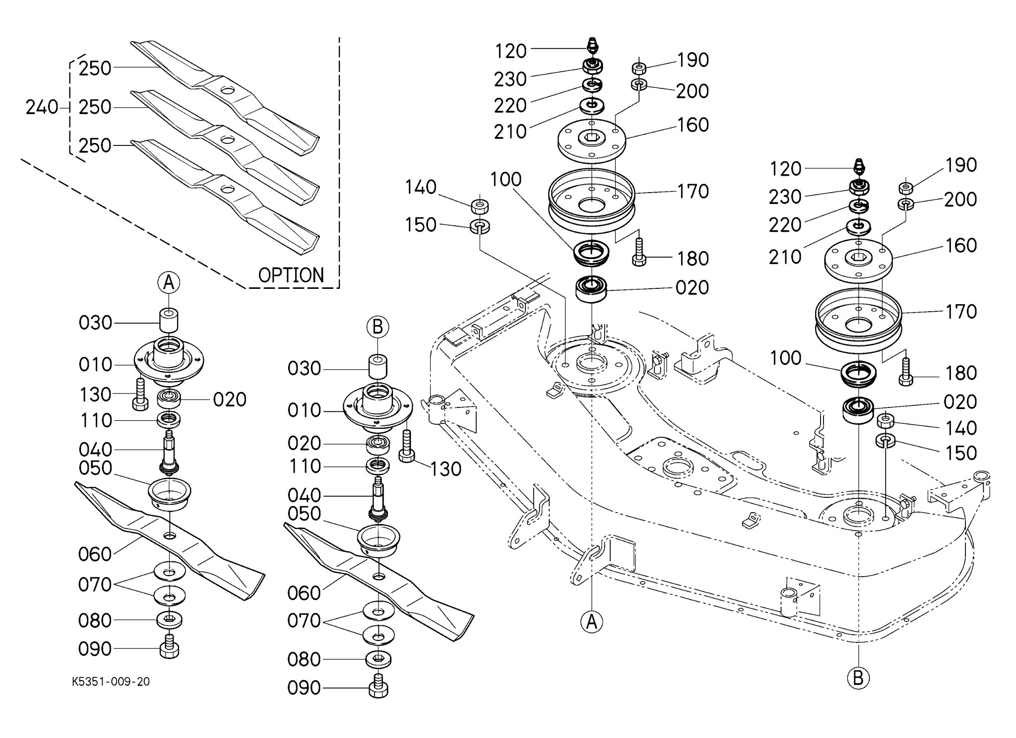

Hi,
Does anybody know thread size (specification) for side blade shaft for Kubota Rotary mover RCK60b-22bx?
I would like to know top tread for nut holding pulley.
this long tread

Most likely metric. Measure O.D. of threads and see whether it's closer to a mm or inch dimension. It won't be exact, but slightly under the nominal. Use a pitch gauge or compare with threads at a hardware store bolt.

The problem is that tread on the shaft is almost destroyed . Consequently I cant measure it properly. That why I am asking.
Kubota dealer told me that new one cost around $200 so I try to fix it.
Thank you for all help.
11,427
4,909
found this on Cdn site.using your model info..... #040 is only $65 CDN...NOT 200+... Nut #0230 is M18-1.5
