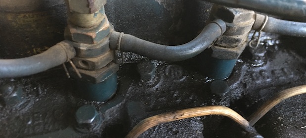

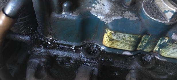

After looking over this thread, I decided to investigate the possibility of a leaking injector. Upon opening the engine housing, I found liquid covering the top of the engine (see images). I believe the liquid is diesel. I cannot tell if the liquid is leaking from the injectors or the engine casing.
Would fuel leaking from the casing cause my issue?
What problem does fuel leaking from the casing indicate?
Any thoughts on how I should proceed?
