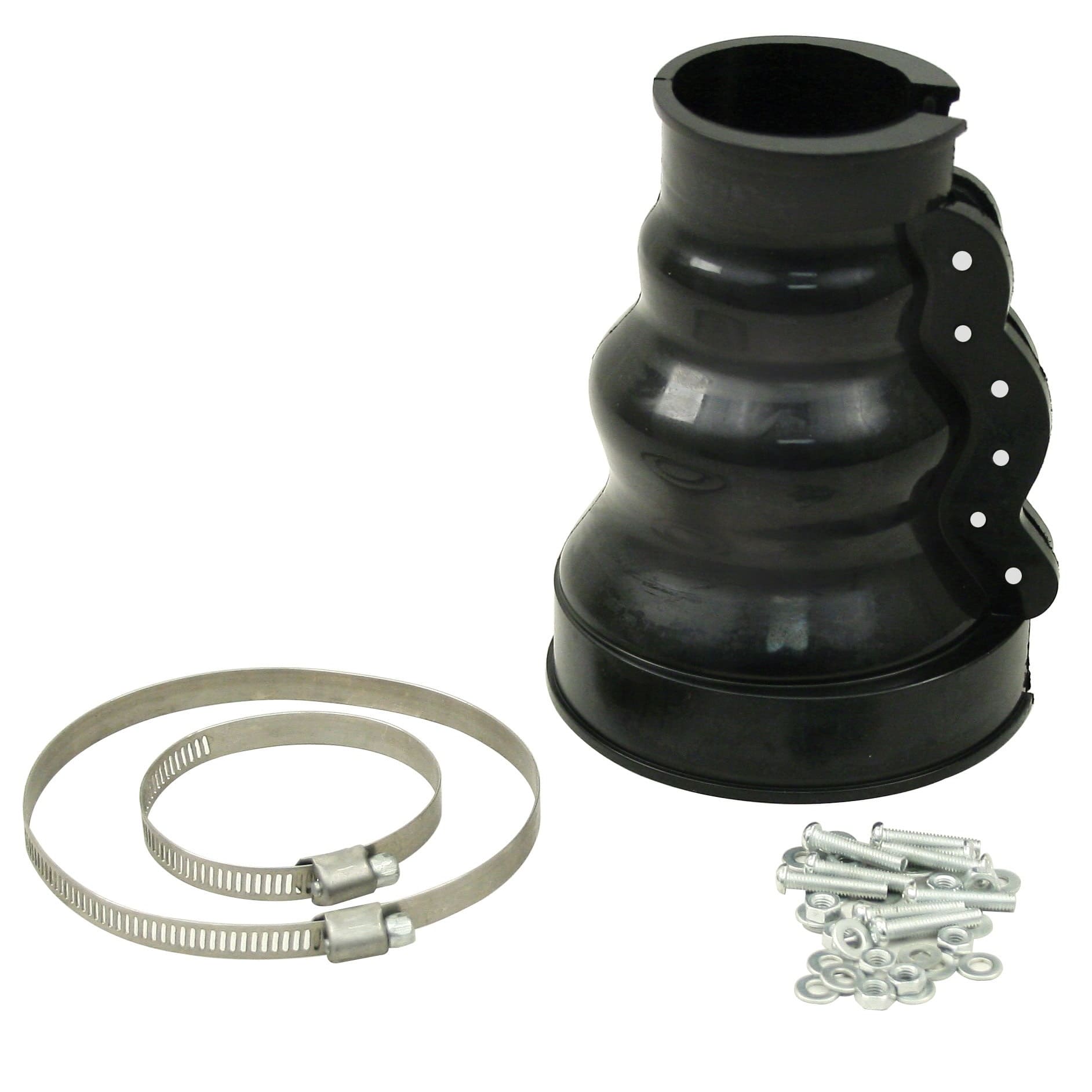

Dang, I was looking for CV Joint replacement boots for you. If you have the end sizes someone should be able to fix you up pretty cheap with something like this. For $7bucks it might work for your application since its not going to be spinning around at 4000 rpms.
