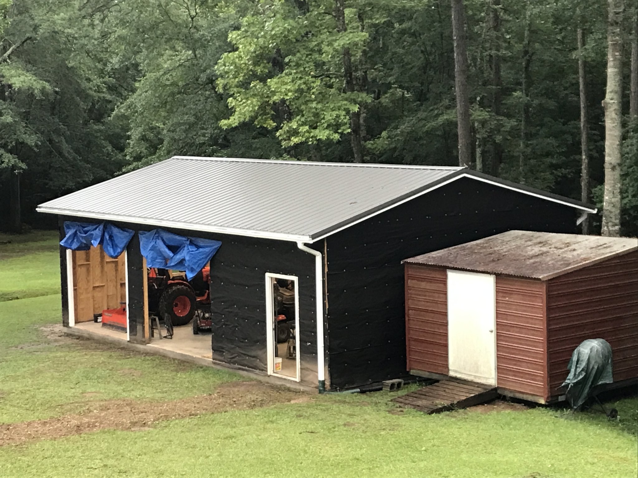

Sounds good and about time for some update pictures here. ;)
Ask, and it shall be given
Gutters done, drain pipes installed to direct some of the runoff away from the slab.
Putting up gutters solo is a little challenging. Glad they were 10 foot vinyl sections. However, the couplings that supposedly required no sealer leaked like a sieve with a moderate rainfall. Well, what we call moderate in Alabama. Didn’t see it coming over the gutters much, but the seals on the couplings were pretty pitiful looks like I’m going back up with a tube of silicone. I want all this outside climbing behind me. The back side is a PITA for managing ladder safety. Hard to get a good footing with the ladder.
Without further adieu, ……

That is a very professionally done roof job sir. (y)
OK, I'll get a bag of popcorn and wait for your next installment. ;)

Thanks for the flowers, but, believe it or not, that’s the first roof I’ve ever done. Professional? Well, as the profession goes these days, maybe. I would have done a few things a little differently if material prices weren’t so prohibitive. I would certainly have doubled the purlins to make it sturdy enough to walk on any part of the roof. I have to make sure I stay near a purlin as it is. Hindsight is 20/20. The sheet metal is so thin it needs more support to prevent creases and buckling. I helped put a “tin” roof on a barn when I was a kid, but the sheeting for that was a lot thicker and stronger. Drove many a lead head nail on the ridges of the 5 V sheet. This stuff has to have the screws put in the flats. Just goes against everything I learned about preventing leaks. The SIL helped me with the sheets, but I did all the trim (rake and cap and drip edge) by myself. We put the sheets on in one day.
I’m definitely ready to be done with the roof. Too much laddering for me.
