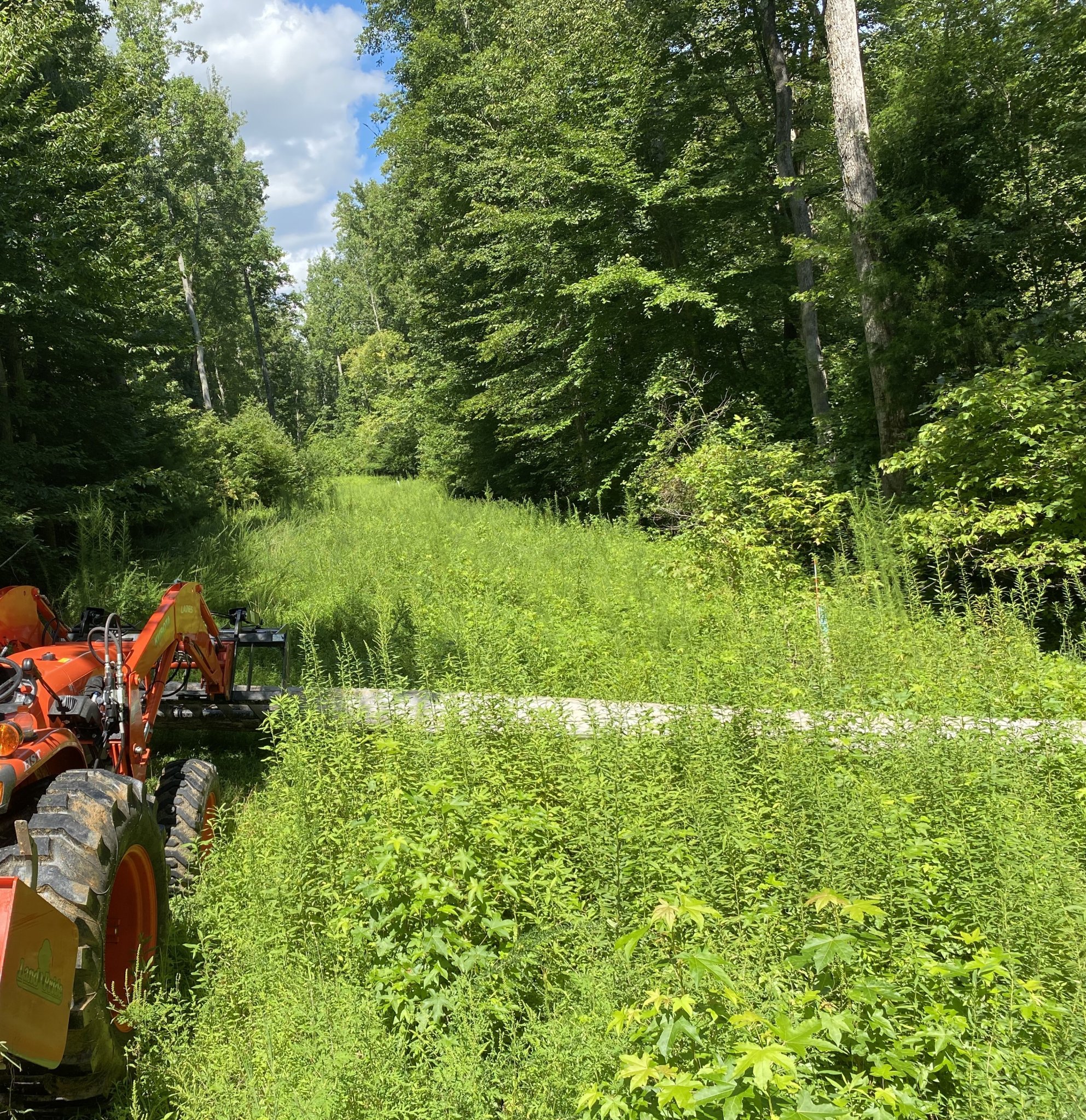

This is the kind of stuff I routinely mow with our rotary cutter. Sometimes worse, sometimes not, but pretty average (except for the log which was moved shortly after the pic was taken).
Should be very easy to cut. Green, moist foliage, not very 'stemy'. I wouldn't expect you'd need to dress your blades very often (if ever) for that.

Soft, moist vegetation there. Easily mowed with just about anything. Looks fine.

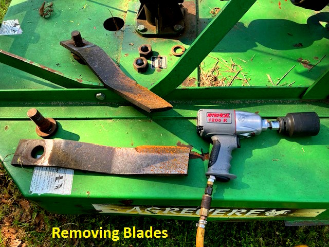

You will probably need between 200 and 600 ft-lbs to remove the nuts.
(y)
I certainly agree that the nuts can offer a 'challenge' when it comes time for removal.
IF the nuts have not been removed recently then you likely will be dealing with not only the dynamic torque figure (used to tighten them) but also some amount of corrosion on the threads.
The 'break away' torque can be considerably higher than the torque used to install the nuts in that situation.
Often times a cheater bar, torque mulitplier or powerful impact wrench are needed to break the nuts loose.
I've done it all three ways....but use my impact whenever possible.
*please excuse the green*
12,178
5,270
