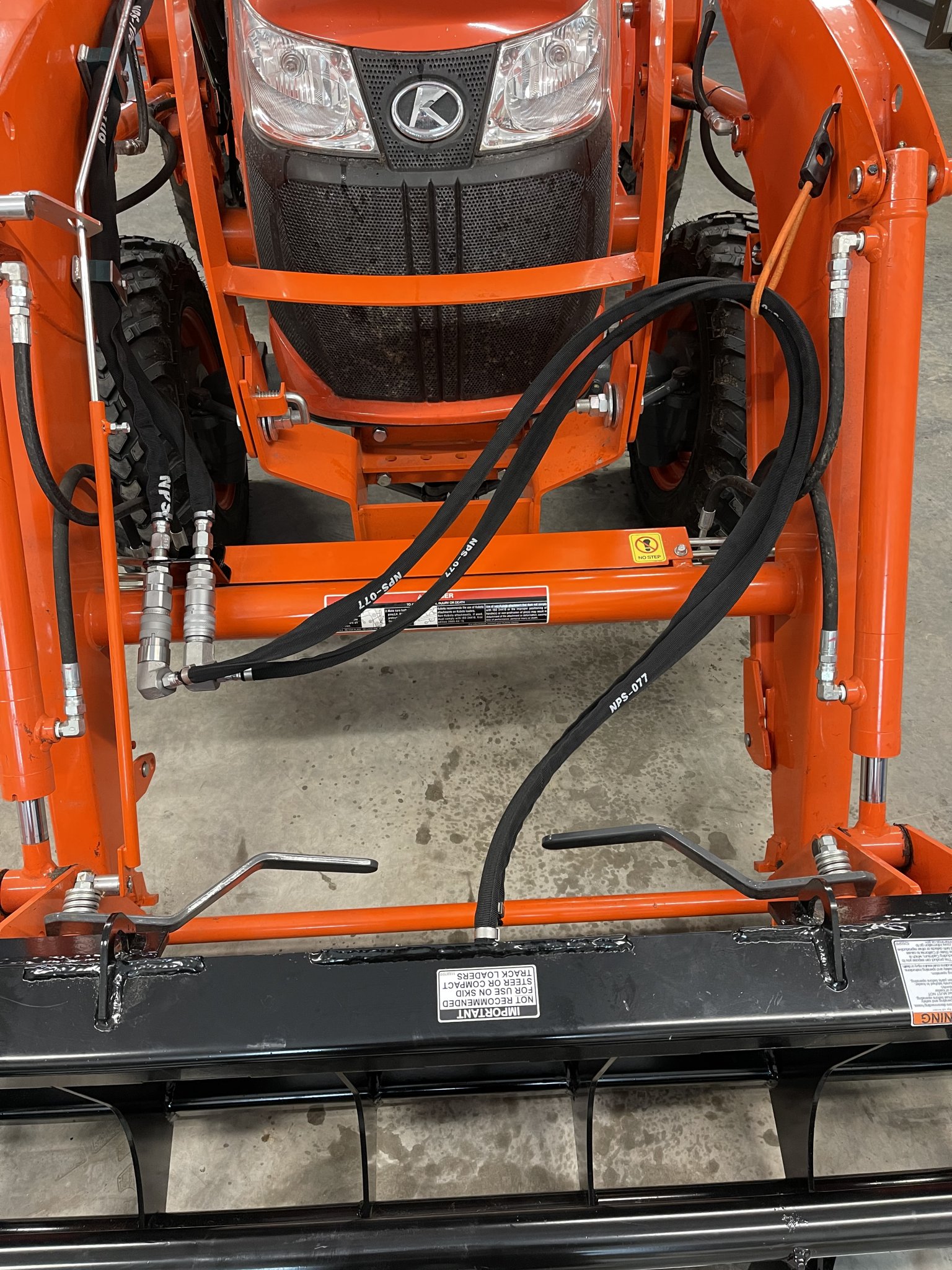

The grapple I got comes with extra hydraulic hose for full tilt.
What are you guys doing to secure it so it doesn’t get pinched or torn from the machine?
Using a bungee cord for now.

Works for me but I am kind of anal about plumbing. So I would shorten them up and come off the tee at 90 to the right running along the grapple. I would ditch the 90's at the couplers and come straight in with a smaller working loop in the hose. All that exposed hose will get snagged.
29,992
6,172
You've done the best thing, it's a bungee cord or cloth covered spring in most cases.
There are spring loaded hoses ( coiled) available but they are stupid expensive.
Yea shortening them is not advisable, because yes you'll use the length up when you dump fully.

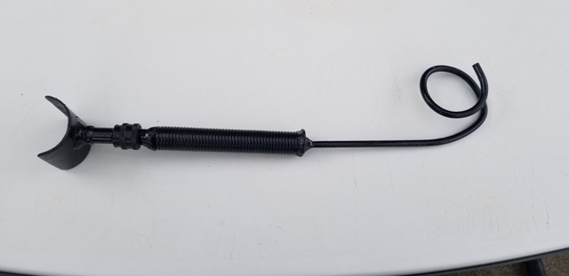

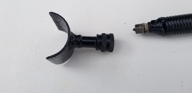

I made a flexible spring with a quick connect to mount to the loader so it's easy to take off and leave with the grapple. The base (circular part) is clamped, and stays with the loader.

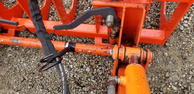

Using a grapple you have to be careful some material doesn't snag the quick attach levers and release one. Then you can get the attachment plates out of time.
Here's a simple solution, a couple of 1/4" holes at the end of each lever.

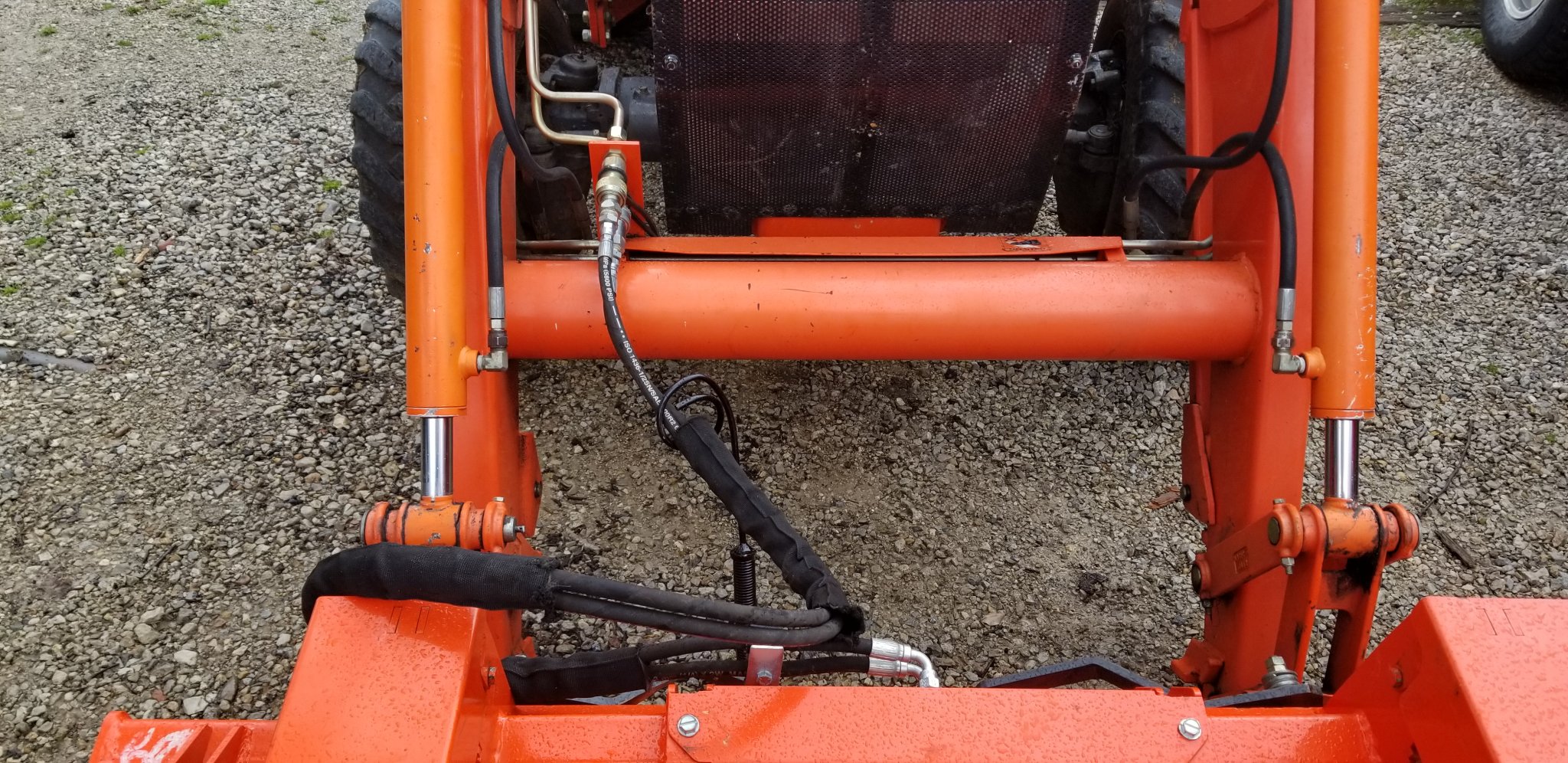

I run my hoses under the pivot bar for the bucket and back up to the couplers. Works for me.
I'd weld a metal tang and mount hose clamps to take the strain when your hose flexes.
Right now all your hose strain will be on the fitting which is easy to snap off.
I'd also suggest going with a 45 degree on your couplers instead of the 90's you currently have. Hose sleeve on the loose parts will prevent the rubber hose from wearing and kinking when it rubs.
That's a good use for that rubber thing that's useless in it's original purpose of holding the drop arms together. Fairly soon after I bought my Kubota, I replaced the turnbuckle stabilisers with the much better telescopic ones that rendered the rubber thing as surplus.
