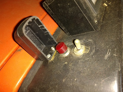

The fix that I used on my tractor was to install a switch that bypassed all the safety switches. This may not be possible on many tractors but it is for the BX23. This comes in handy for any number of things, like standing up while working your loader, not having a faulty safety switch put you temporarily out of business, or for the winter, getting off your tractor while the snow blower is still running so you can see what is going wrong. Just be aware of the risk.
