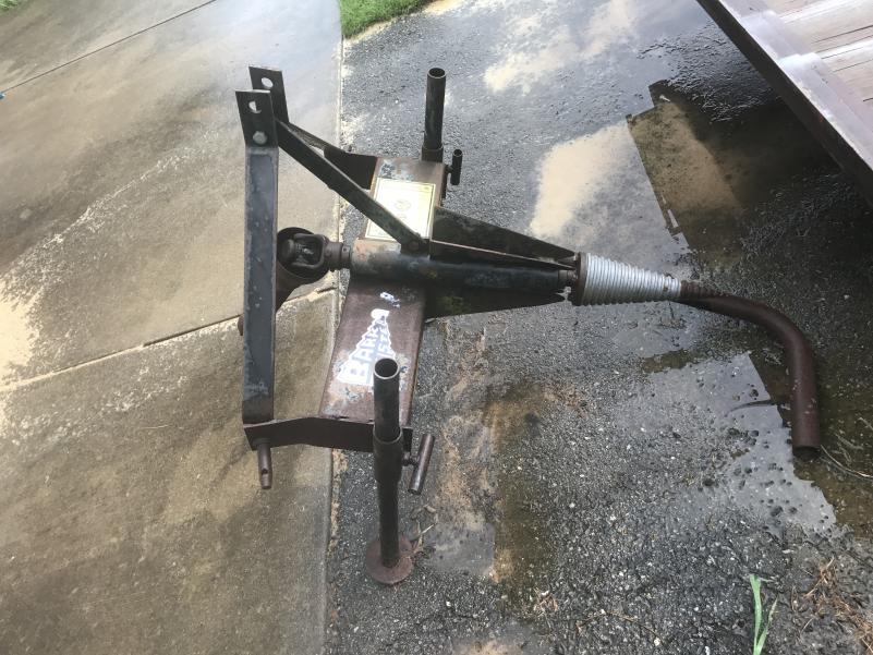

Just obtained one, just like the Unicorn splitter, but it is a Kubota. Does seem very simple, I just need to figure out a way that I can push logs against it without getting my hands near that unshielded spinning auger bit.
And if you used it on soft ground, the log won't hold and will dig a trench and spin until you shut it down. I wasted more time with this thing, went back to ax and splitting wedge.
MagKarl
L245DT
Aug 2, 2010
663
Olympia, WA
Re: Screw drive/cone log splitter
The long orange pipe in JerryC999's picture is what the wood round is rested upon when pushed into the cone. The ground conditions have nothing to do with it. Lift the round, oriented with long axis roughly horizontal, set it on the pipe, slide the round up against the cone, and it feeds itself in.
This bar keeps the wood from spinning as the cone drives itself in. The cone drills into the round radially, not axially like a hydraulic splitter or how you split by hand. You cannot safely split short rounds if they are not a few inches longer than the distance from the cone to the pipe. I cut my firewood to about 20" and this is plenty long for this splitter model.
