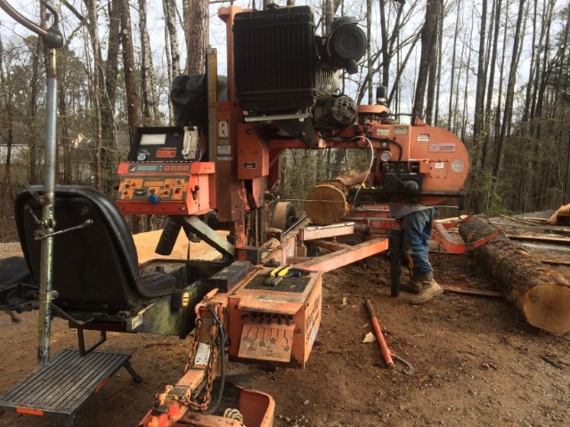

Pictures of my sawmill taken yesterday while I was sawing.
The control box in front of the seat controls the up/down, sawing speed, board thickness, auto-clutch, etc. The controls on the lower right, handles all of the hydraulic functions such as log loading, turning, clamping, & toe boards.

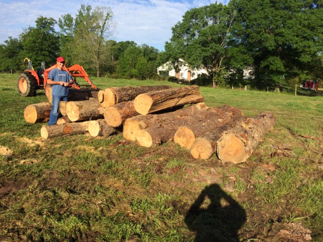

This is an example of what my Grandson I produced in 3 days with my sawmill. The first picture is of the logs before we began sawing and the second is of the finished product which consisted of 2X4's, 2X6's, & 2X10's.

You need to recheck your figures because my sawing price is from 1/2 to 2/3 the cost of Lowes "store bought". (I checked too.) ;) In the above instance, those logs were all culls that the commercial sawmill would not accept. Rather than let them rot or termites eat them, he had them sawn into framing lumber for a barn that he is building.
