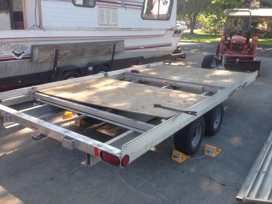

I have a 12ft all-aluminum trailer I use for hauling my B7100HST around. Works great but have been concerned the stock 3/8" plywood deck flexes badly under the tractor's weight. My new (even heavier) B2650 TLB is coming this week. My fantasy of a more sturdy but still light deck had run aground on the very high (for me) cost of aluminum planking. Wandering a local metals recycler last week, I stumbled onto two sets of scrapped small bleachers, somewhat boogered from rough handling but mostly there. It had steel under-structure but aluminum seat/walk boards, and cross braces. I scored (15) 9-1/2"W x 1-1/2"D x 176"L planks and an armload of 1-1/4" x 73" angle (x-braces). Pulled off the old plywood deck, attached some angle flush with the cross-deck supports, trimmed and fitted (8) of the best planks, and screwed them to the angle from below with 1-1/4" coated hex-head self-tapping screws. There's some more trim out needed yet but am really pleased with it so far! I'm trying to send photos, we'll see how it goes...

That looks really good, huge improvement over the plywood.
If it get slippery, you could put down some traction tape.

Wolfman, the planks' surface seems to already have some traction treatment but what is not obvious. So far wet has not shown up as slippery, makes sense as a bleacher. Wise cautionary words though, I'll be stepping delicately especially after one of those north Idaho special winter morning ice/slime treatments! I'm too old for doing face plants over the edge.
Mendonsy, thanks. Yeah, those planks new would about double the trailer cost!
28,875
5,250
Yea I was thinking about where you would step off.
You can get some at HD or Lowes for fairly cheap if you need it. ;)

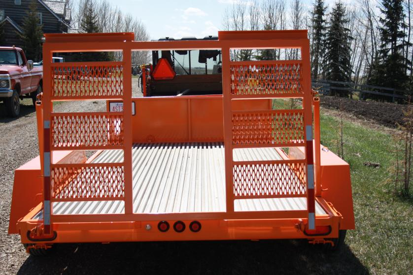

I did kind of a similar overhaul to a trailer that I purchased, I removed all of the old deteriorating planks, had the trailer blasted and painted. I was over at my neighbours and he deals in rebuilding / scrapping old heavy trucks and trailers and bought about a 14 ft, section of an old refrigerated van floor. It consists of a corrugate type of aluminum flooring, screwed to hardwood beams then spray-foamed to a thickness of about 8 inches for insulation, I hauled it all over to the local Hutterite Colony and their crew basically stripped the beams and foam off. and cut the floor to fit and we just screwed it on in one piece. Zero maintenance, very strong and light and it looks pretty sharp plus doing my part for re-cycling.

Very nice!
Any scraps left over? If it were mine, I'd also deck the "A" frame between the hitch & front rail. Good step area.

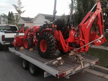

Today I hauled the brand new B2650 to its N Idaho home. The trailer did great! I was worried the tractor would be too heavy for it, somewhat north of its 4000 lbs gross. What I found was the aluminum planks had hugely stiffened up the deck. Should have figured that out ahead of time but am not complaining. Plenty of suspension play left, bearings & tires stayed cool, and solid braking. I'd beefed up the ramp back a few years, turns out it's good enough for the new orange toy too. This whole "plan comes together first time" thing is novel for me, enjoying while I can! Gonna mess up some dirt and bushes tomorrow. Putting thought to arranging some good tie down points for the tractor.
