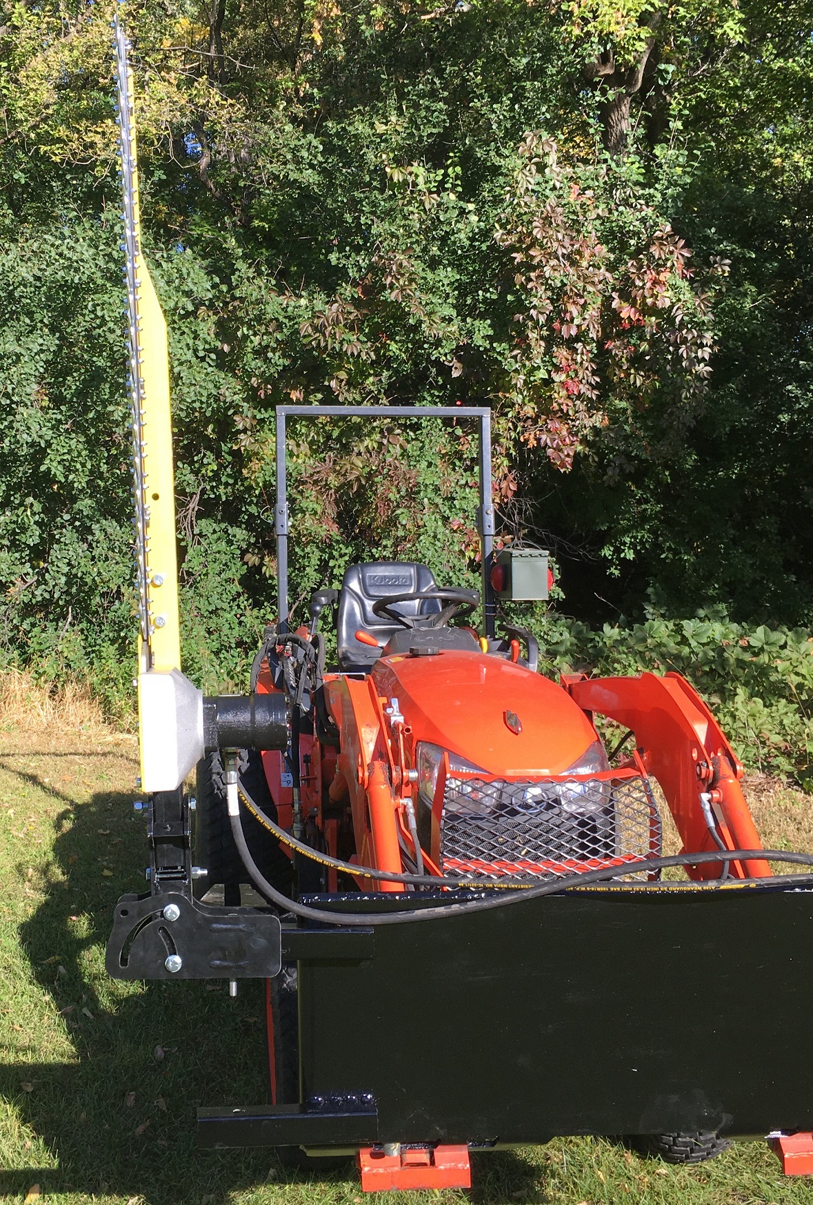

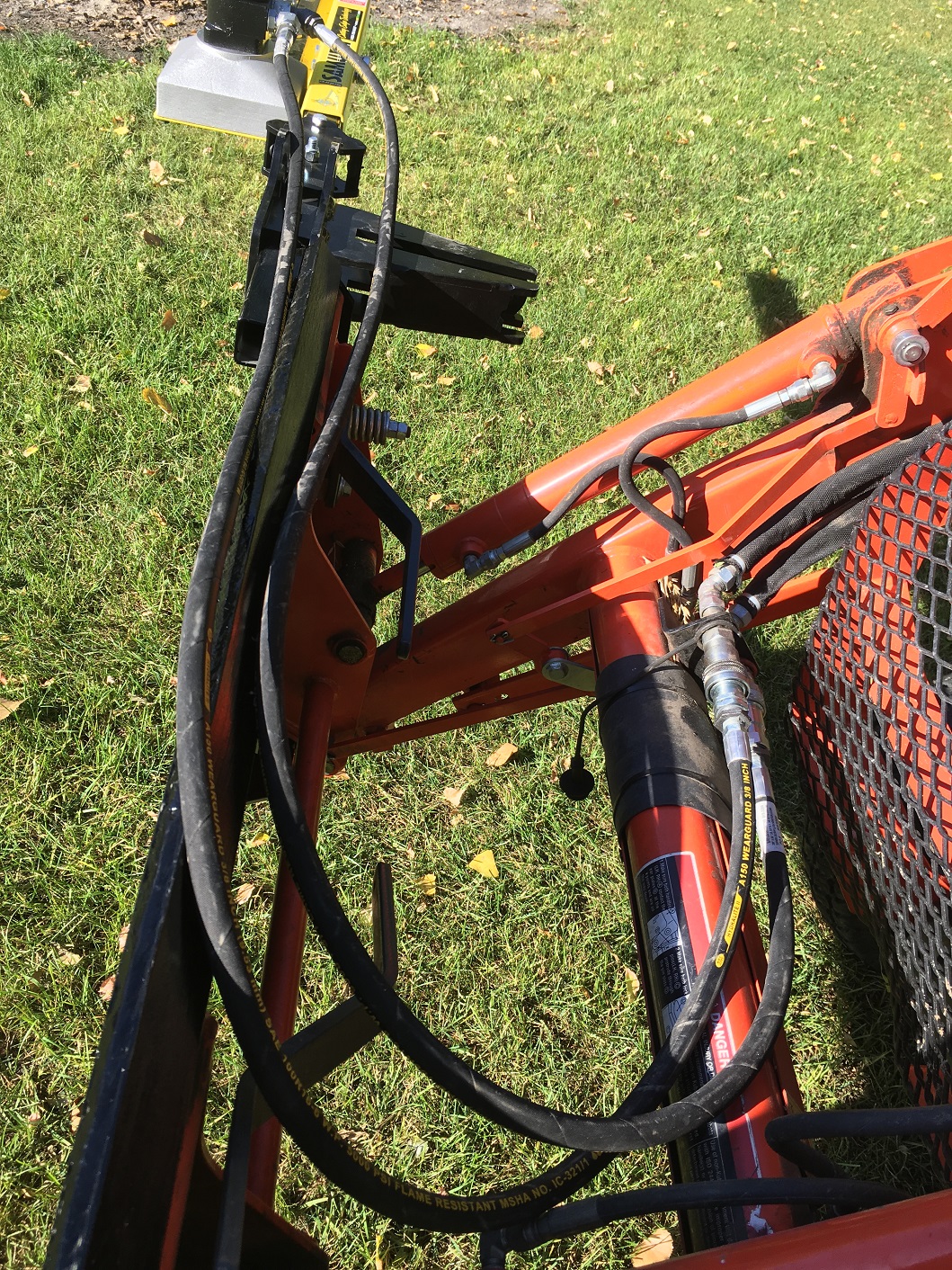

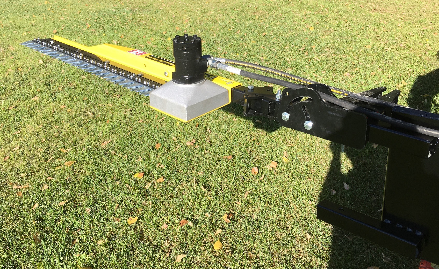

The final design turned out to be very simple after some thinking and taking measurements. A blank SSQA plate and some 2” square tubing with matching mounting holes were welded onto it. No mods to the original break away mount were needed. The Samurai can also be rotated and remounted on its own “breakaway arm”. Now the cutter can just be slipped over those mounting posts and quickly pinned in place to cover our different cutting needs.
Here’s pics of the SSQA mount and the 2” sq. tubing posts. 7 ft. hydraulic hose length turned out to be a good fit to accommodate all the mounting positions.
SSQA Samurai Mount.JPG Mounting Posts on SSQA.JPG 2 inch Square Tubing Mounts.JPG 7 Foot Hydraulic Hose Routing.jpg

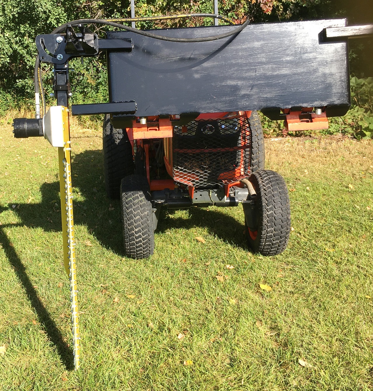

Here are different tractor right side mounting positions. Either upper or lower post can be used for any of these positions.
Right Side Down Tilt.jpg Right Side Horizontal Position.jpg Right Side Vertical  Position.jpg Right Side Vertical Down.JPG
Here’s the tractor left hand side mounting in the vertical down position. This side position just makes it easier to finish trimming the vertical sides into inside corners. But it can also be used for horizontal trimming, etc.

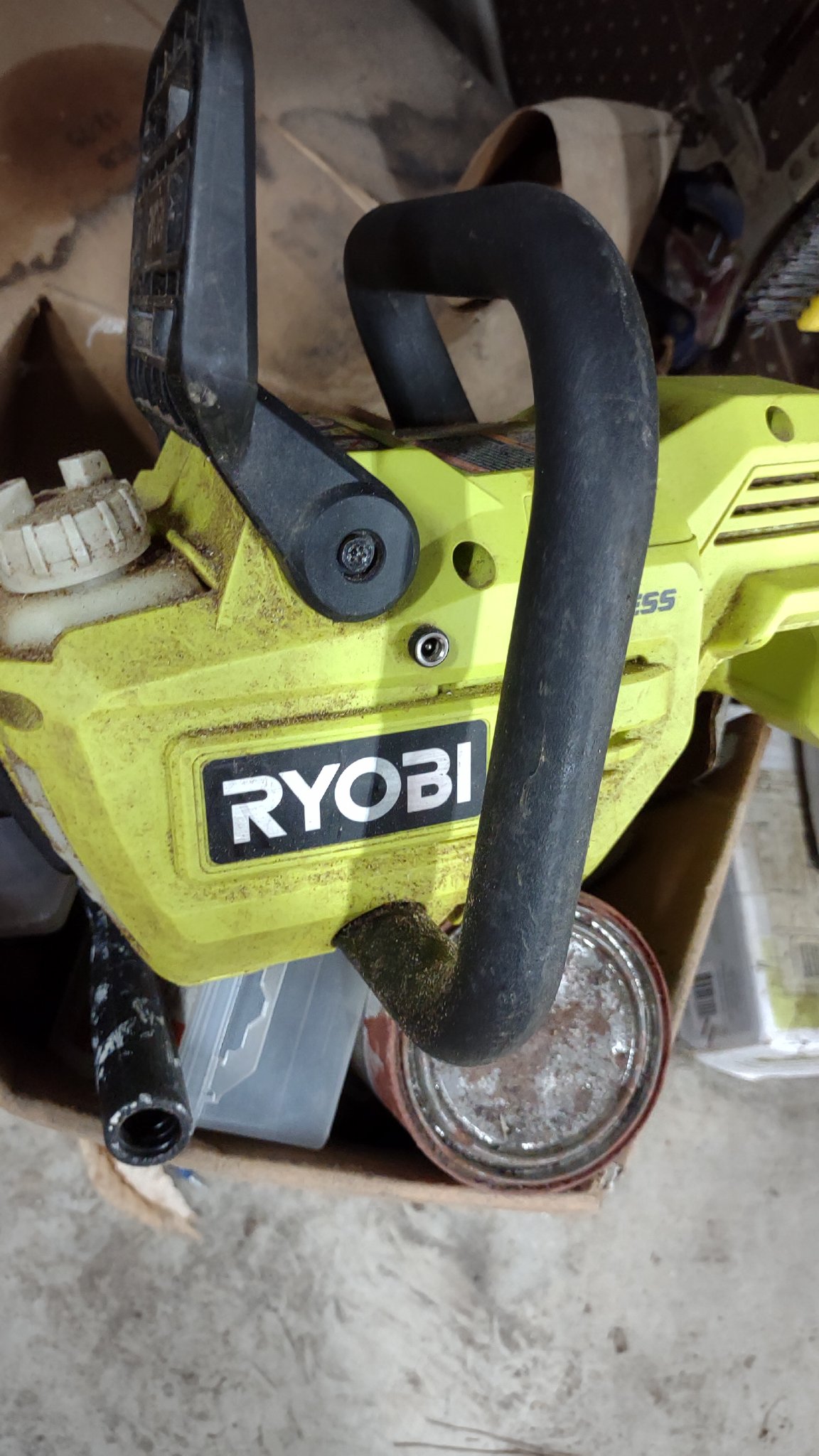

I'm not in the Kubota club, I have a Massey Ferguson GC1723eb. I read this thread and felt like we were all siting in my shop telling stories. I wanted to join and give you my experience with the Samurai and my small tractor, just to help give everyone another opinion.
Also, I've been looking at building my own extended limb saw with a battery powered chain saw, so the wireless thing has been a bug in my ear for a while. I'll save that for another thread.
Welcome aboard! Most of us will treat you right, most of the time.
I started a battery eLimbinator project some time ago, but got sidetracked. I wanted to use my 40v brushless Ryobi chainsaw. I got as far as modifying the saw. See the pretty picture
That jack over the B is the interface. There is a small relay inside the saw that, when activated with a 12v signal, turns on the saw. I thought that using an active signal would be safer than just closing a contact. So I ran a wire from the power outlet on the dash, through a trigger switch on the joystick, to the jack. The Ryobi has a variable speed control, so a potentiometer has to be shorted for full speed as well as the on-off switch.
I got that part sorted out, but never mounted the saw on the loader. If anyone needs details on that Ryobi saw, let me know and I'll dig it out.

Yeah, I saw posts on here of somebody building a hydraulic saw and using their third function to power it. That looks a lot better and not too hard to do. When I started, I didn't have third function, but now I do.
I don't think there's a reverse control function on the Ryobi, might could swap a couple of the output power wires.

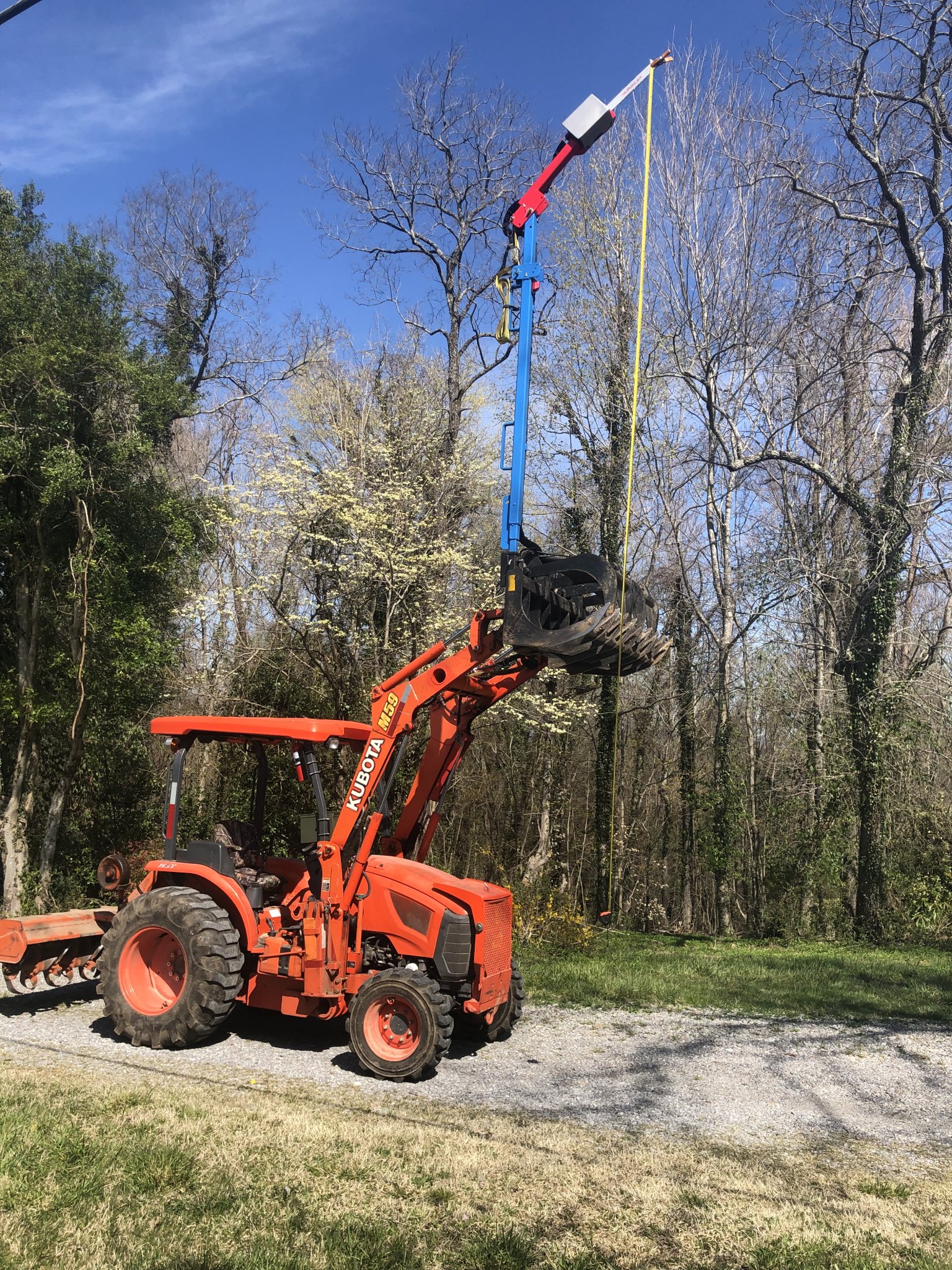

How long of a pole saw is that in the picture? And is the angle adjustable near the end of the pole?
Thanks,

As I recall, the brushless Ryobi is not a conventional DC motor. It has permanent magnets in the rotor and the controller converts DC to 3-phase variable-frequency and -voltage to produce the magic. You might be able to switch 2 of the outputs for reverse. Reverse in the controller would have been easy to design in (like a drill/driver) but it probably wasn't since it wasn't needed for a saw. Keep us posted.

About 13’
About 25’ reach.
The end is hinged, foldable and adjustable.
Important!!! The weight of the saw moves carries it thru the cut not the hydraulics.
The <1.5” diameter face slappers can be cut moving slowly down the road. 2” cuts less than half second. Generates piles of limbs quickly.
Thanks for the info. I'll be sure to look for that. Mine is not brushless, but I'll check it out. You now have me curious on the electronics in there.
