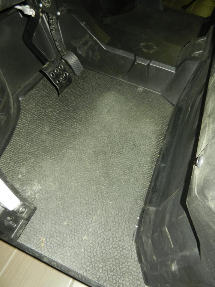

Here's the mats... I made a cardboard template. I cut the straight pieces with a box cutter and the curves with a scroll saw and a metal blade.... Same template works for both sides... just flip it over for the other side.
The stock size fits the bed with a 2" strip down either side to leave access to the tie down hooks. No trimming required.

Nice mats on the floor, Ray.
I have a 700XP, '09 version. My dog was loosing traction on the floor, and me also once in a while. I washed it real clean. Sprayed some black rubberized sealer for guttering on the floor then punched some holes in a cat food can with a 7P nail, filled the can with sand...and sifted the sand on the sealer before it set up. Just enough grit to stabilize traction. Been two years with no problems.

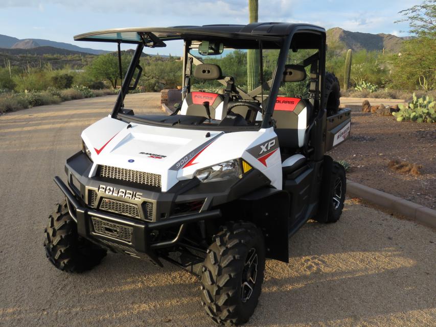

That is my plan... :)
My Ranch Piggy...

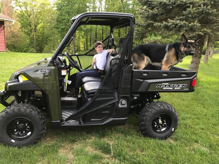

As far as my son is concerned ( 3.5 yr old) the ranger is only made to go through deep mud. Everytime we get close to getting stuck he wants to turn around and go right back through it. The whole family piles in for rides too, so it's more than just a workhorse.
And you got the 900.... I'm sure you will be satisfied !! Shiny side up !!
